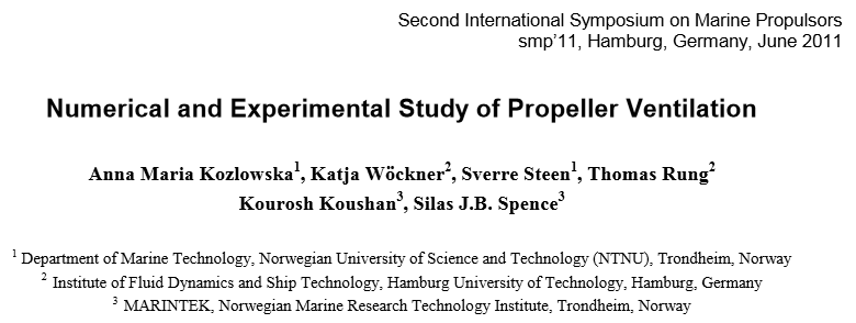

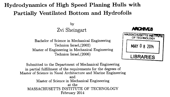

    In hydrodynamics an object can be ventilated too. For example, hydrofoils can ventilate - especially when they are taken out of a barn, put in water and pushed to high speeds.
    In hydrodynamic things can be aerated too, like aerated water.
    They can also be wet like wetted area, and dry like dry transom.
    Your personal preference for a particular wording doesn't make that particular wording a scientific standard, and doesn't make it a definition in hydrodynamics. Especially when it is defined, in hydrodynamics, exactly the way you claim it is not.
    Transoms, bottoms, foils, struts and propellers can and do ventilate.

    A transom is not ventilated like the core of the tip vortex in surface piercing.
    I stick by my definitions as clarity and simplicity are my personal preferences. Struts, foils and props that pierce the surface have tip vortices that end on the water's surface, therefore are 'ventilated', meaning the core is air, not water. Aerated water is far afield of any hydrodynamics discussion here. How do you want to ventilate a boat bottom? Air injection?

    The term "ventilation" (from latin word "ventus" = wind) indicates a process where an originally submerged surface becomes exposed to air, in general due to local reduction of pressure with consequent suction of atmospheric air.
    To answer your question - yes, a stepped hull is intentionally ventilated (as you surely know better than me) in order to replace water with air behind the steps.
