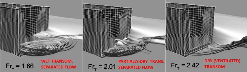

    A picture is worth thousand words, hence...
    1) Wet transom, separated flow:
    2) Dry (or ventilated) transom:
    4) A 3-D View of various levels of transom ventilation:
    Taken from this paper (worth reading): https://www.researchgate.net/public...g_Catamaran_Transom_Stern_Ventilation_Process
    As you can see, the flow separates along the transom edge at nearly every speed regime.
    When the transom runs wet or partially wet, there is a volume of recirculating water above the separation line, which considerably increases the hull resistance.
    When the transom runs dry (or fully ventilated), the water flow is continuous (no separation) and the resistance component due to recirculating vortex disappears.
    So what you and CT249 have called "separation" looks more like ventilation to me. :)
    I guess that your intention was probably to describe a situation in which the water flow "separates" cleanly from the transom edge. That situation is technically called "dry transom", meaning that the transom is 100% ventilated.
    The correct terminology is important in this kind of discussions, but I remember that we have already had a discussion in the past about that issue (it was about propeller blades geometry) - and the result was pretty much a draw. The terminology often depends on the context. ;)
    Cheers

    There was some discussion on a previous thread about transom ventilation and drag.
    I am curious as how water circulation above the separation line (wet transom) can increase the hull resistance and it creates higher drag than 3) a dry ventilated hull. Ventilation to me is a dry transom, ie no water against the transom
    The reason that I question this is that the back of the transom will be at a positive pressure, ie above atmospheric because if it dropped below atmospheric, the atmosphere pressure would be higher, and would then push into the transom and ventilate it.
    If somehow, 2) the pressure of the water behind the transom is below atmospheric, and creating a higher drag which disappears when fully ventilated 3) but still in contact with transom, then if you were to drill a hole in the transom, then there would not be any water flow into the hull.
    I know that with my tender when I am trying to get rainwater out of it, I can pull the plug but no water will go out the drain hole until the transom ventilates
    My thinking is that the water pressure on the transom cannot go below atmospheric psig = 0 when the transom is wet and a fully wet transom will not create more drag than a dry transom.

    Hi Daquiri, I've leaned over the transom of my Glastron v153 with my son driving. The flow doesn't separate below 8 mph, below that speed there is backflow up the transom. I expect that this is typical for all my classic boats, I can check it for my Power Cat 15t in late Apr. Again, check out Newman's Marine Hydrodynamics. Thanks, Joe

    But Daq, in your (1) the flow has not separated from the transom, there's backflow! Also, I don't like artists' drawings or simulations. I would need flow photos.

    I don't disagree with you daiquiri, because you could be completely right, and correct terminology does matter, but just in my personal experience it's pretty common for people to not use "separation" as a description until regime C occurs (transom completely ventilated), or at least certainly not "clean separation".
    As far as I can see that paper doesn't use "separation" to describe the shear line and wet transom regime either - it only uses it when the transom is ventilated.

    So you are saying a keel or a wing with thick trailing edge can't produce lift because there is backflow? Or a wing/sail that is stalling?
    Here is a flow field around a foil while stalling (note all the backflow): https://upload.wikimedia.org/wikipe...Flow_separation.jpg/310px-Flow_separation.jpg
    Here are the lift and drag coefficients beyond stall (note that lift is nowhere near zero and a lot of lift is generated even with the foil backwards):
    http://www.aerospaceweb.org/question/airfoils/q0150b.shtml
    Why do you think it is important to have another fluid phase (air) at the trailing edge before you can have lift? And why it is not needed for keel or propeller blade?
    Separation means that flow field is no longer following the shape of the body. It has nothing to do with transom being dry or not. Well, expect that with dry transom separation is obvious.

    Since transom is vertical, only pressure on it can change the drag. Having water there will naturally increase the pressure and thus "push" of the transom. But that's not all. Energy is needed to keep up the backflow and turbulence at the wet transom. Thus it will change the pressure and flow field elsewhere as well. That change can be much bigger than the missing "push" of the transom.
    Displacement hulls with rocker or rounded hull at the stern try to keep the flow attached, thus not separated. Then the Bernoully equation is valid and there is high pressure at the stern pushing the vessel forward and reducing drag. Without separation and surface friction there would be no drag at all (well there would be "wave making drag" due to free surface).
    With a sharp edge between the bottom and the transom flow will always separate at the edge. This means that the Bernoully equation is not valid for the pressure. So even with a very low velocity close to transom the pressure is not high thus it is not "pushing" much.
