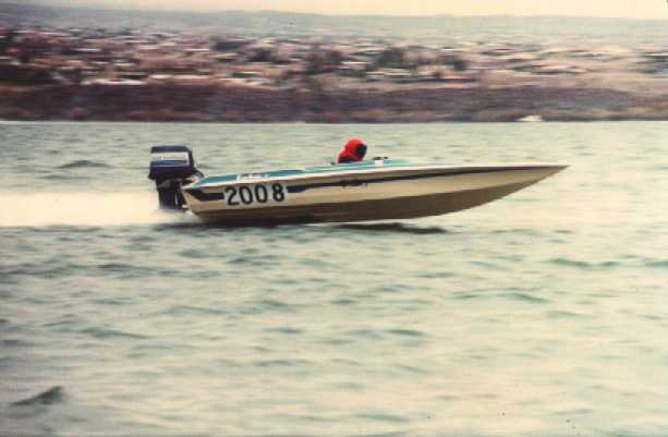

    Lift sets in sharply when the flow separates from the bottom at the squared transom. Here, the boat is plowing bow-high. As the speed increases then the boat begins to lift at the transom while still plowing bow high. I take as 'planing' the point at which the transom lifts enough that the bow comes down and the boat's trim angle is, very roughly speaking, the same as the speed increases. With our 15' Glastron this trim angle is a few degrees. At that stage (about 18 mph) the boat is running flat and dragging a lot of water. Up to that point the motor is trimmed under. To gain speed the hydraulic trim is then used as the throttle is increased. The top speed is 46 mph GPS with 70 hp. The rig weighs 910 lb.
    Now. If one demands a 'constant' length scale in F then it can only be a scale at top speed when the boat is running high and dry (again, I am only talking about firm, straight bottoms as with high performance hulls). You cannot avoid that the depth d of submerged hull comes into the equations. Specifically, the drag force is D=rcAU^2 where r=water density, c=drag
    coeff., A=BL =wet area, which decreases with speed because both B and L decrease, and V=BLd=displacement, which decreases as speed increases. We then get D/Bu=cF^2 where buoyancy Bu=rAdg and F^2=U^2/gd. You cannot avoid a Froude nr. based on d if you want to compare drag and buoyancy, or drag and lift. This is good hydrodynamics, it prepares one for deriving the correct speed-power-weight scaling law that differs from Crouch and Wyman where lengths are involved so that their results do not scale.
    Summary for our Glastron results (V with no pad, deadrise≈16 degrees):
    -As the boat plows bow-high with the motor trimmed fully under, lift sets in at 8 mph. Transom is deep in the water, transom does not lift upward as lift begins at this speed. Trim angle does not change.
    -boat continues to plow bow-high (trim angle of boat≈30 degrees) with transom deep as throttle is increased and boat begins to lift at the transom.
    -At 18 mph the transom lifts enough that the bow comes down, the trim angle falls to a few degrees. I label this as the onset of planing (it's arbitrary but good-I take reduced trim angle as part of my definition of planing).
    I have often watched a particular water-taxi in the Baltic (Schaprode-Vitte) run while never planing. It runs about 24 mph bow-high with the transom squatting in the water. Underpowered. A little more power and the transom would lift and the trim angle would fall.
    The boat shown below is an 18' Laser with 235 hp at 85 mph. The point is that there is very little wet beam, wet length, or wet submerged depth. All of thoses lengths decrease as U increases for a properly-designed and properly-braced boat bottom.
  7. daiquiri
    Joined: May 2004
    Posts: 5,373
    Your reasoning might be formally correct but not practically useful, I am afraid.
    In general, the main advantage of using non-dimensional coefficients (like Fn, Cl, Cd, Ct, Cp, Kt, Kp etc.) is the simplification of mathematical (engineering) analysis. They should allow the creation of test procedures and resulting graphs and tables which (at least in theory) are scale-independant and hence valid for a broad range of geometrically-and fluid-dynamically similar cases.
    In order to make a calculation system which is reliable and reproducible, the reference length (or area, or volume) has to be chosen between quantities which can be measured with precision and confidence. If the reference is uncertain, the rest of math work may be theoretically valid but becomes practically useless.
    Now, given a CoG setup (which can be measured), the static WL lenght, beam and wetted transom area are easily and reliably measurable - even at full-scale and on board. Same for the displacement, which depends on the boat's weight. Hence, when used as reference quantities for the analysis, they lead to repeatable (though often complex-shaped) graphs and coefficients' values, for the same hull geometry and flow conditions.
    The depth of the submerged hull - how do you measure it? At what point along the hull, and against what reference plane? How do you do it on a full-scale moving boat?
    Without the possibility to reliably measure this elementary value, the rest of the analysis turns into a formally nice academic exercise - but not much more than that.

    It becomes practically useful when you use my speed-power-weight formula, which I have compared with established APBA OPC kilo records.
    Wetted transom area decreases with speed, it is very small at high speeds.
    I have admittedly guestimated wet depth. To estimate it: take photos from another boat running along side. :D
