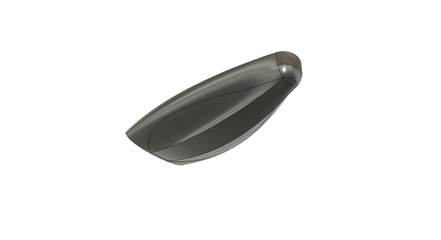

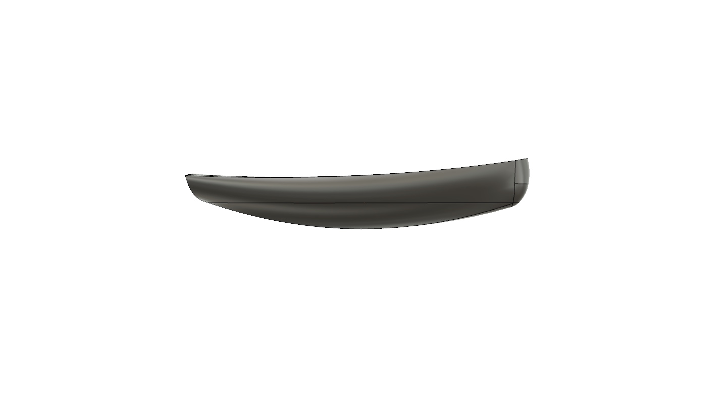

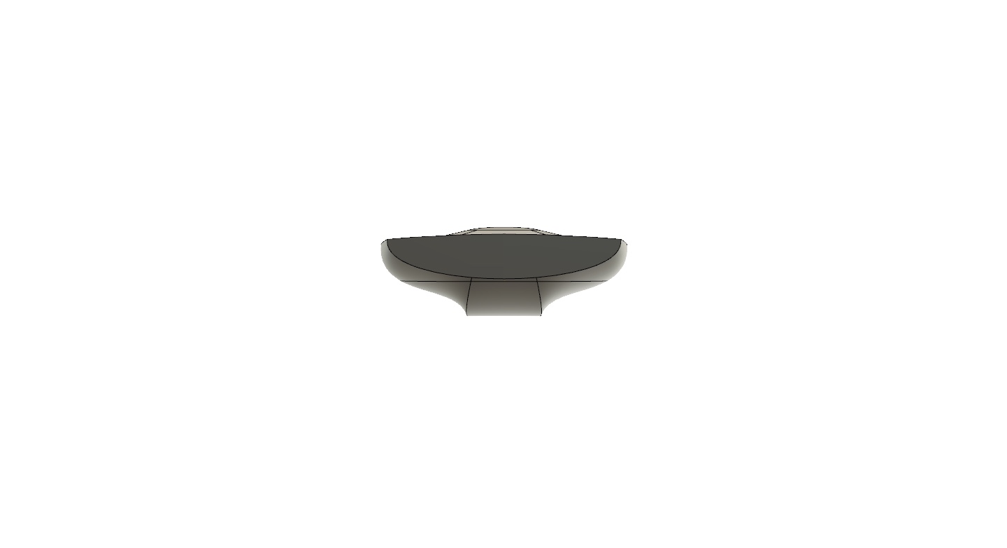

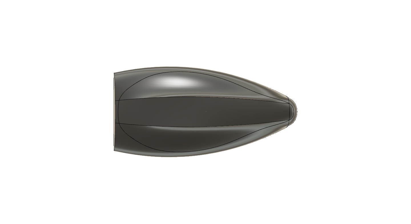

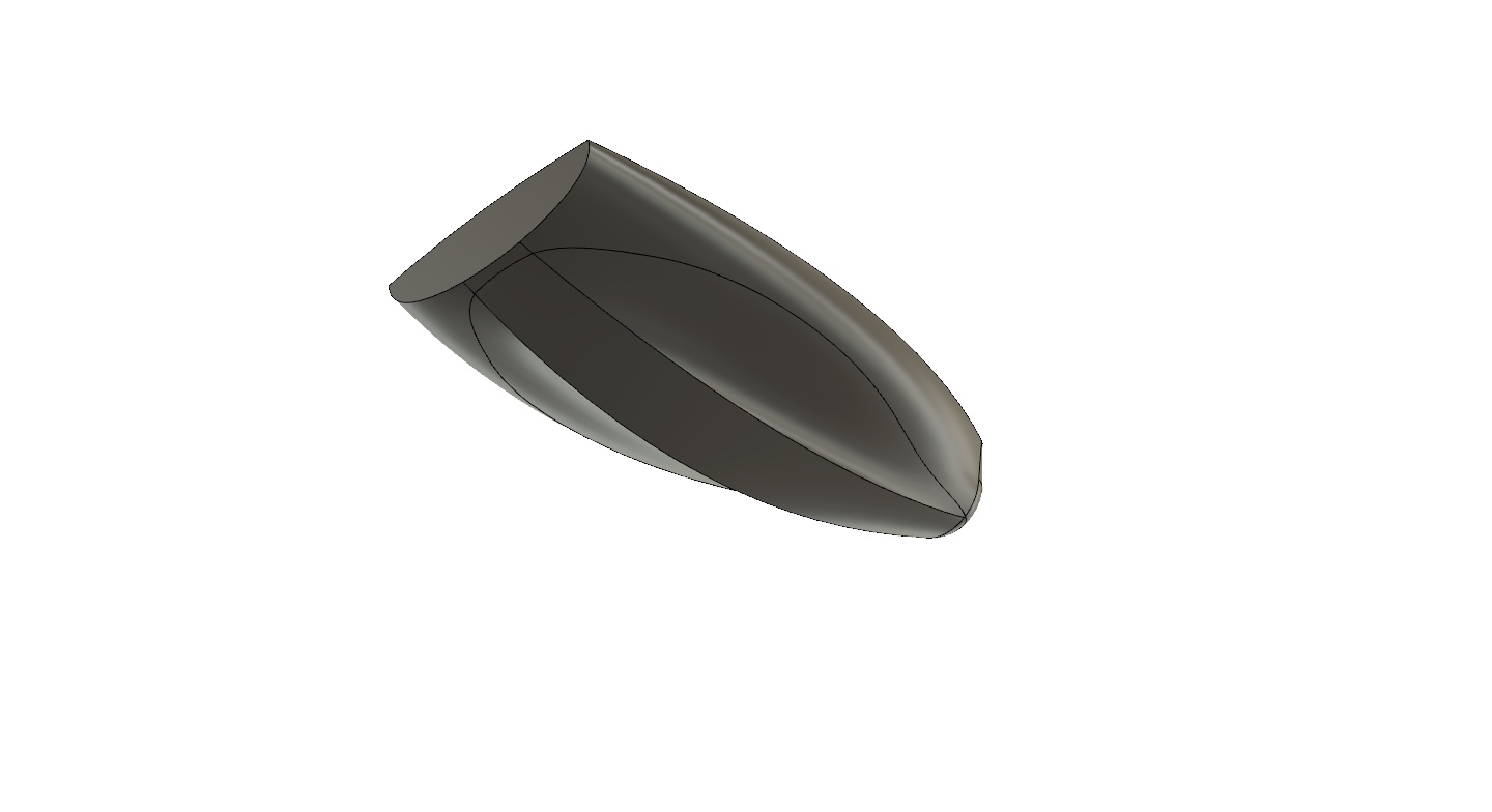

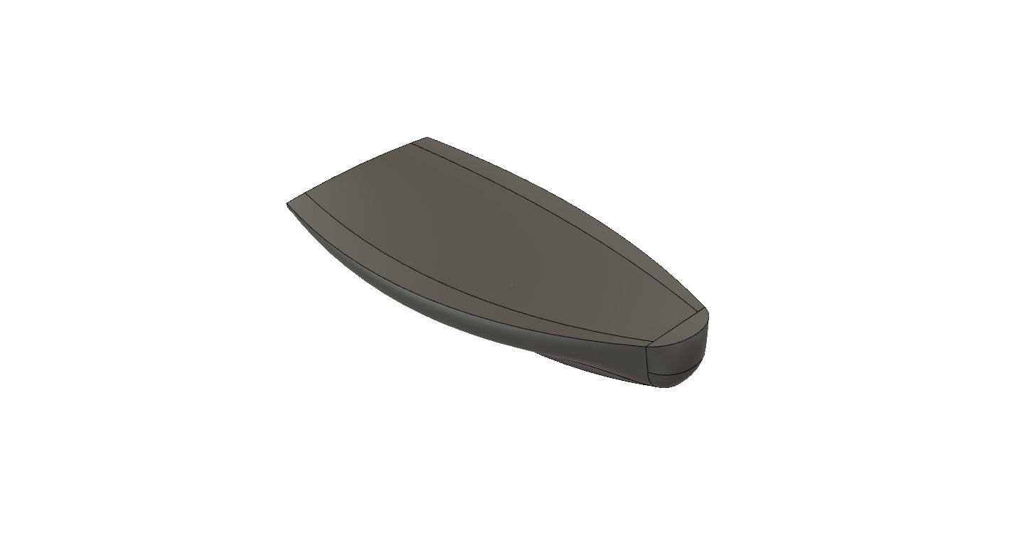

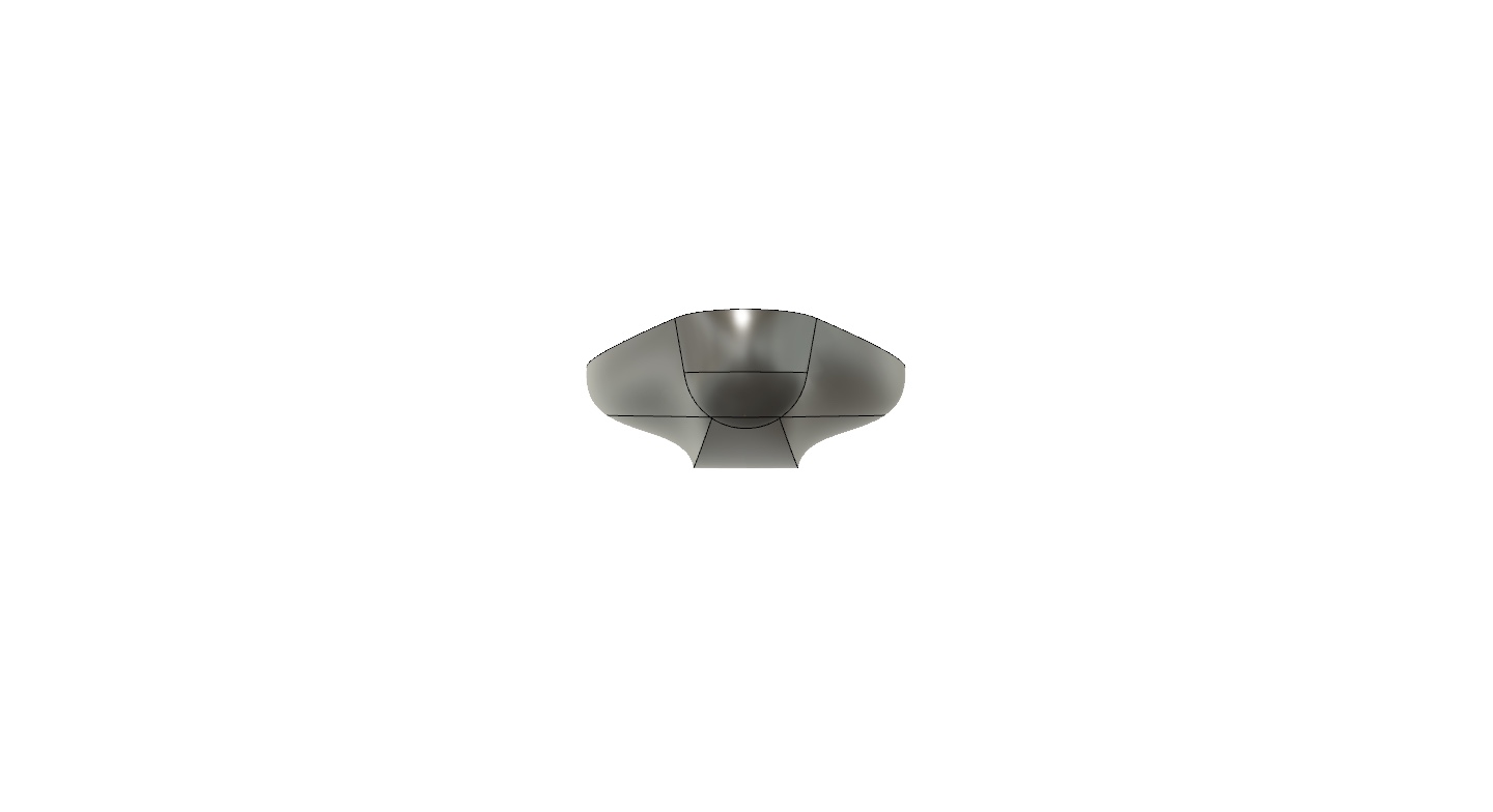

    Interesting discussing, I am currently starting the design of a modern interpretation of the catboat with a spherical bow. The idea is for a coastal cruising sailboat with a modern interpretation of the catboat.
    This is the basic hull shape that I am starting to study.
    LOA: 26 foot
    BEAM: 13 foot
    DRAFT: 2 foot

    The bow design is in line with the ones mentioned in this thread, but I don't understand the purpose of the concave line part of your sections, at first glance that leads to more wetted surface, and a bit more hull surface for a bit less volume contributing to the righting moment.
  15. valery gaulin
    Joined: Jan 2017
    Posts: 177
    Likes: 4, Points: 18, Legacy Rep: 7
    Location: Montréal
    valery gaulin Senior Member
    The purpose of my design is intended for cruising and not racing. Coastal cruising and shallow bay mooring. I am giving a modern twist to the traditional Catboat hull shape! The concave part in the bottom of the hull is just a way to give some standing headroom in a shallow draft boat. The concave section is around 3 foot wide, it will be the floor of the cabin, no bilge!
