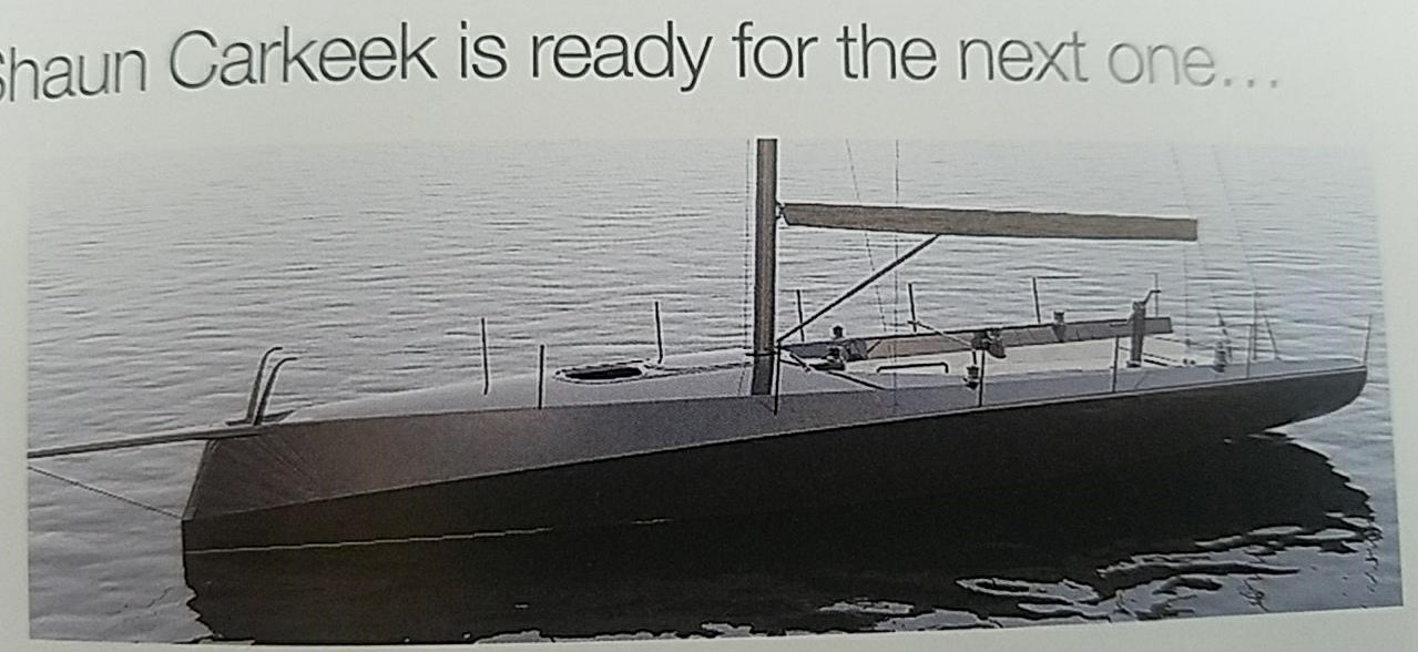

  8. Southern Cross
    Joined: Mar 2013
    Posts: 155
    Likes: 4, Points: 18, Legacy Rep: 37
    Location: So. CA
    Southern Cross Senior Member
    A new interesting take on the bow. An exageration of the Hugo Boss IMOCA 60. Maybe it should have it's own thread.
    The Carkreek Fast 40 Ran.
  9. Dolfiman
    Joined: Aug 2017
    Posts: 1,314
    Likes: 537, Points: 113
    Location: France
    Dolfiman Senior Member
    Really a futuristic look, like a stealth ship with a reduced radar signature ;) . The hard chine line seems captured from a CFD computed waterline at heel 25°-30° and above the weight reduction logic is pushed to an extrem.
    But I think the bow cannot be categorized in the bow scow typology, so yes may be it deserves a specific thread.

  11. Dolfiman
    Joined: Aug 2017
    Posts: 1,314
    Location: France
    I put this comment with in mind "big" scow bow as designed for Mini650, with more round fore volumes and freeboard than scow Moths.

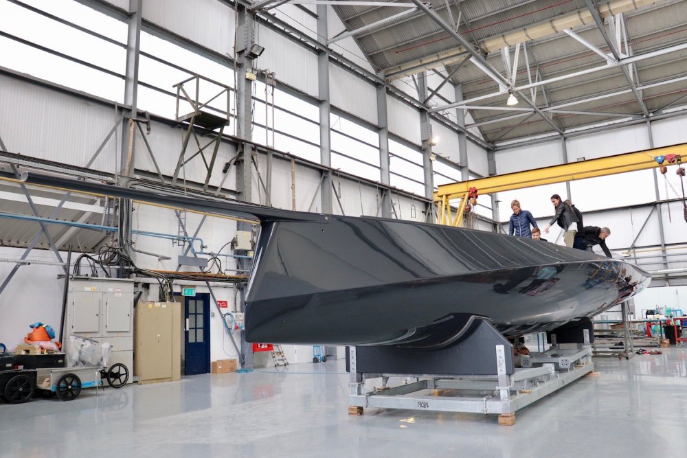

  13. Dolfiman
    Joined: Aug 2017
    Posts: 1,314
    Location: France
    Two other photos , the bow and the general view : Fast40 bow.jpg Fast 40 general view.jpg

  15. Dolfiman
    Joined: Aug 2017
    Posts: 1,314
    Location: France
    More views of the hull of this new Carkeek Fast 40 Ran through the video of its launch. Not a classic bow neither scow one, I would say arrow front lines even more accentuated because of the inverted bow :
