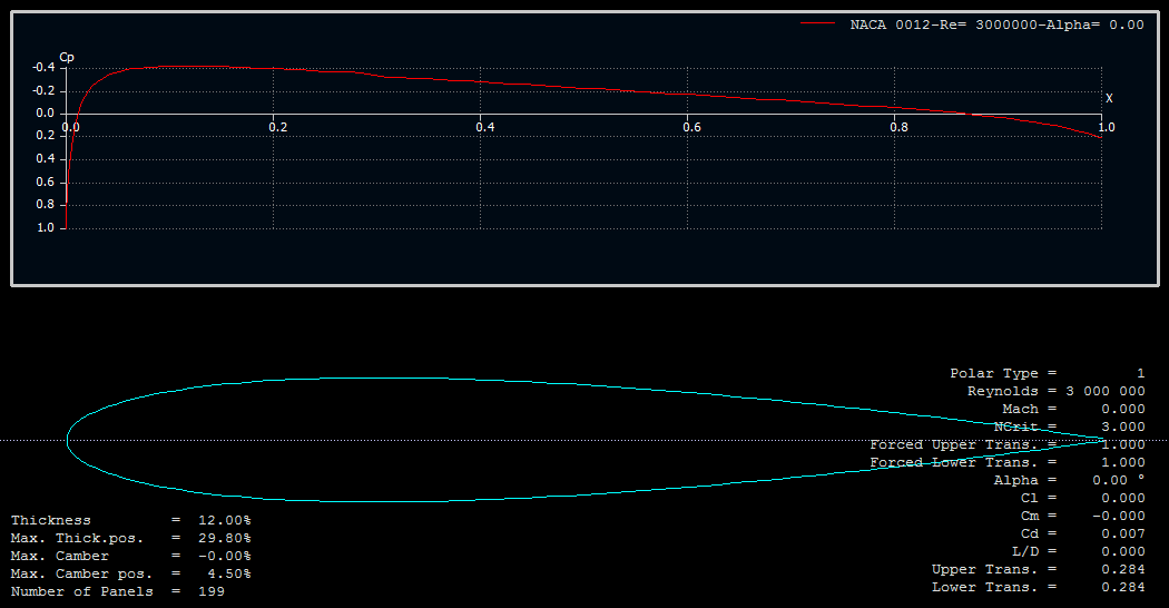

  11. Joakim
    Joined: Apr 2004
    Posts: 892
    Likes: 53, Points: 28, Legacy Rep: 422
    Location: Finland
    Joakim Senior Member
    Here is Cp of a NACA 0012 foil at 0 AoA. Note how the lowest pressure is near the leading edge and at the trailing edge the pressure is already higher than "zero". The kayak hull will have somewhat similar velocity distribution and thus also pressure distrubution due to "bernoulli effect". But waves will make the pressure distribution different and the velocities will be much closer to far field (zero) since kayak is a narrow 3D object not a infinite 2D as NACA 0012 in the picture.
    As you notice from this velocity and pressure distribution, it would not cause an aft down trim.
    A kayak travels at about Fn=0.8 during sprint event. That is 2x hull speed. Then the bow wave is half of the LWL and thus the stern will be in the deepest part of the bow wave. I'm not very familiar how such a narrow hulls trim at those speeds, but more conventional boat hulls have about the highest trim angles then.
    To me it is quite obvious that the trim change of C1 during each stroke is due to weight and moment changes caused by the canoeist and not at all due to changes in velocity during each stroke.

  13. jesdreamer
    Joined: Jan 2013
    Posts: 88
    Likes: 1, Points: 0, Legacy Rep: 10
    Location: Alabama
    jesdreamer Junior Member
    Velocity related pressure??
    It seems to me that the NASA graph of pressure distribution along flow path across (upper half of) an aerofoil at zero angle of attack might be proving my point. In the NASA aerofoil case an increase in air velocity along the convex surface of aerofoil is yielding a reduction in fluid pressure normal to wing surface -- and this is cause of lift. I visualize similar effect on a hull in water except all is inverted and the resulting reduction in pressure might cause more draft (or trim depending on CG location) -- I realize there is little curvature along keel but there is significant curvature along immersed sides which can end up causing similar effect. Now since C1 paddler is already well above hull speed (in YouTube videos) and to some extent has front area riding the bow wave, I think the NASA data is explaining why aft hull might sink under the sudden surge forward during each stroke --
    I agree with Jokim's first sentence -- "The kayak hull will have somewhat similar velocity distribution and thus also pressure distribution due to "bernoulli effect".....
    But this 2nd sentence sounds like mumbo jumbo to me -- "But waves will make the pressure distribution different and the velocities will be much closer to far field (zero) since kayak is a narrow 3D object not a infinite 2D as NACA 0012 in the picture...." -- And I can't see why 2D wing analysis should have any different significance than a 3D hull in our current area of discussion
    Why is this train of thought wrong??

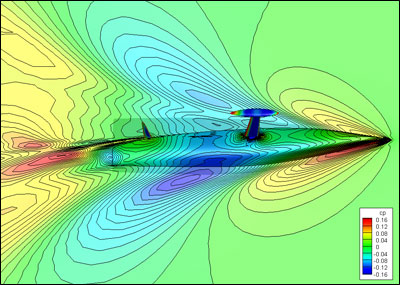

  14. Joakim
    Joined: Apr 2004
    Posts: 892
    Location: Finland
    In the simulation I made the NACA 0012 is 2D that is it is infinitely long perpendicular to the picture. Velcity is high where fluid is "pushed away" by the profile. That is when its thickness is close to the maximum and still increasing. As soon as thickness is constant the velocity starts to decreace and pressure starts to rise towards zero.
    Since this NACA 0012 is a 2D object fluid is "pushed" only in one direction (on one half of the profile). On a 3D object like a kayak hull, submarine, airplane fuselage etc. there is much more directions for the fluid to deflect.
    Imagine that 12 cm thick NACA 0012 is in a 24 cm high wind tunnel. At maximum thickness the free area is only 12/24 thus 50 % of the area and thus the average velocity is 2*V.
    Now take the same NACA 0012 profile as a rotated profile looking like a torpedo. It is still 12 cm thick and you put it in a 24 cm diameter cylindrical wind tunnel. Now the free are at the thickest poist is (12^2-6^2)/12^2 = 75% of the area and thus the average velocity is 1.33*V.
    Then you should also compare the profile of a kayak to that of a torpedo or a wing profile. Note how slowly the cross sectional area increases in a kayak compared to those other ones. This is to minimize waves. At the same time it makes velocity increase much smaller.
    Now take look at the pressure coefficient of an long and narrow AC yacht. Note how badly the Cp correlates to the Cp of a NACA 0012. Cp shows mostly the effect of waves (except for appendages).
