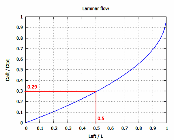

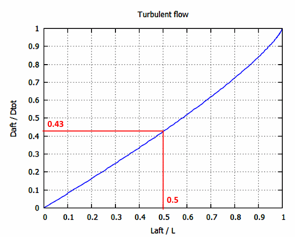

  15. TANSL
    Joined: Sep 2011
    Posts: 8,012
    Likes: 971, Points: 123, Legacy Rep: 300
    Location: Spain
    TANSL Senior Member
    What are you looking for, 1 or 2?
