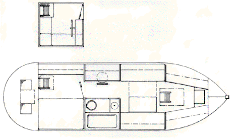

    I have mentioned before my interest in pursuing something like Tom MacNaughton's Hero 33 concept for a liveaboard/modest cruiser with a freighter-like aesthetic and a lot of living space for the length of the hull. That said, that concept is for a steel hull professionally built and then fitted out with interior and systems by the owner, and it is not yet a completed design.
    What are some good alternatives for an owner-built wood design with similar vibes? I am looking for available plans, not concepts or sketches, that would channel a freighter or fishing boat style to provide generous interior living space where the hold ought to be.
    Rough specs are no more than 40 ft long, preferably less, at least one double and one single berth, enclosed head, pilot house or steering from a cabin, four-stroke outboard or small diesel inboard power, simple auxiliary sail rig nice but not mandatory. Since I have only built small Bolger/Payson plywood boats in the past, simplicity, ease of building, and low cost would all be important factors.
    Any ideas?

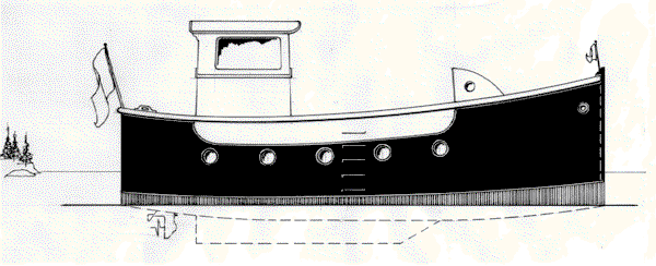

    What is your opinion re the smaller Florida Bay coasters designed by Jay Benford?
    Models http://floridabaycoasters.com/models/
    Or the 32' motor barge designed by Paul Fisher in England?
    Motor Boats over 30' https://www.selway-fisher.com/Mcover30.htm#32
    Maybe a boat like the Sea Piper would come close - but she is only available as a finished yacht.
    SeaPiper 35 - Modern Compact Trawler - SeaPiper https://www.seapiper.com/
    Or Ruel Parker's 36' Motorsailer?
    Australia 47 https://parker-marine.com/mot36page.html
    Or Sam Devlin's 32' Amak tug? There is also a 38' version.
    Amak 32 https://devlinboat.com/amak-32/
    A few more from Devlin -
    Czarinna 35 https://devlinboat.com/czarinna-35/
    and
    Devlin Cruiser 37 https://devlinboat.com/devlin-cruiser-37/
    and
    Dynamo Too 38 https://devlinboat.com/dynamo-too-38/
    and
    Josephine 40 https://devlinboat.com/josephine-40/
    There are lots of other very neat designs in the Devlin catalogue - have a scroll through.

    Thanks, Bajan and all, for the suggestions, please keep them coming. Of the ones you mentioned, the Selway-Fisher motor barge isn’t bad, ditto the Devlin Oysta motor-sailer series, but none are close to the Hero in terms of living space for the length and overall simplicity.

    Here is a 1943 plan for a 36' inboard workboat that can be adapted.

    cluttonfred Junior Member
    Thanks for the suggestion of the Ox, fallguy. Is that an Atkin design? What is the source, maybe I can find it on Google Books? On the houseboat/cruiser question, please take a look at the Tom MacNaughton article on Hero 33 that I referenced in my initial post. The idea is a boat capable of modest cruising but with the emphasis on living aboard first and foremost.
