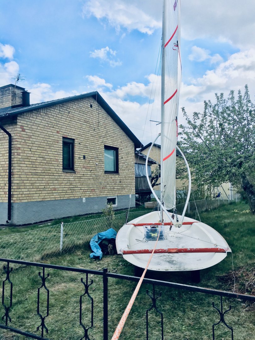

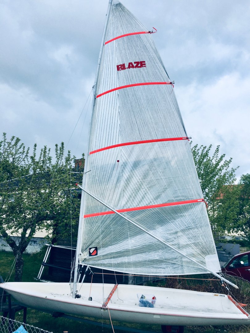

    Played around with some items I found in the backyard this Eastern. BIC 410 hull(free), Flipperjolle rotating round mast tube($50), Blaze prototype sail($100), boom from an old Windglider windsurfer(free), 1m alu tube to extend the boom($15), Nacra 5.5 rudder blade(free) and a roll of Dyneema(on sale at $0,2/m).
    Got as far that I could hoist the main and realize the mast and the extensions for the boom where to short. Will add the 8" extension to the mast top and if that isn´t enough I also have an extender for the lower mast end. About the boom it should probably be long enough just by sliding it down its track under the spreaders as it seems be angled to much upwards. I can also pull out the extensions almost 2". The sail will of course look better with all of its battens in place.
    Next step is adding the same type of lightweight racks I am using on the Frankencat, seen to the left leaning against the shed.
    As I have never play with wishbone rigs before, are there any rules of thumb to make it work acceptable?
    No comments about how worthless this type of rig is, please;).

    Can you adjust the wishbone angle and tension independently while on the water? That would give you a really nice outhaul and kicker (vang) functionality because angle adjusts the foot:leach tension ratio. It looks like the wishbone would crash into the forward lower shroud though.
    Are you happy with the position of centre of effort? If you could rake the mast forward it would increase space under the foot without extending the mast.

    The rule of thumb I've heard for the wishbone angle is that it should bisect the angle at the clew. That's only a very rough starting point though.
    tlouth7 has the right idea about making it adjustable, but I was never happy with my clumsy attempts to do that on Broomstick.

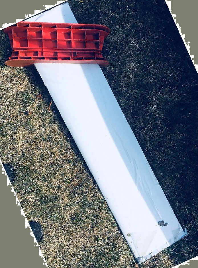

    About CoE it seems to be in the ballpark and can be adjusted, as the daggerboard slot is much longer(will make an adjustable adapter), than the chord of the Windknife FF27 daggerboard section I will use. It might be necessary to move the mast base more forward, though.
    Doug, checked my image and the boom seems to bisect the clew. My initial feel was that it is a little to high as foot tension was very low and leach tension the opposite. Was actually a little inspired by your smaller Broomstick rig and also found a thread you started about wishbone, but the answers didn´t make me any wiser. Thanks for the SA links, will study them.

    The picture suggests that the boat will have a bitchin' lot of weather helm.......depending on the location of the board. I suspect that the mast might need to be moved forward for some distance.

    messabout, not so sure about that, but will draw it up graphically with the help of the line drawing from the leaflet above, before water test. Discussed that earlier, as tlouth7 suspected the same.

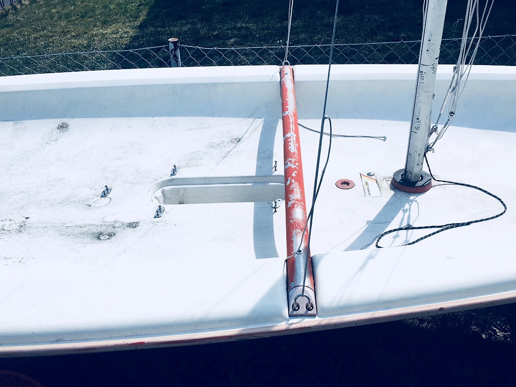

    Anyway the daggerboard slot is very long wrt to my Windknife 27cm chord daggerboard section. Images shows most farward, most rearward position and opening in hull.
    If not enough, I will bolt slab of 12mm or 20mm HDPE from my stash, to the ABS bottom to spread the load. The mastfoot has a 10mm pin at the end. Will then drill a row of holes in the slab to find the correct mast position.

    Did a very corse drawing indicating the rig might be moved ca 20cm forward if the original daggerboard was used. Maybe sail CoE is also a little more forward?

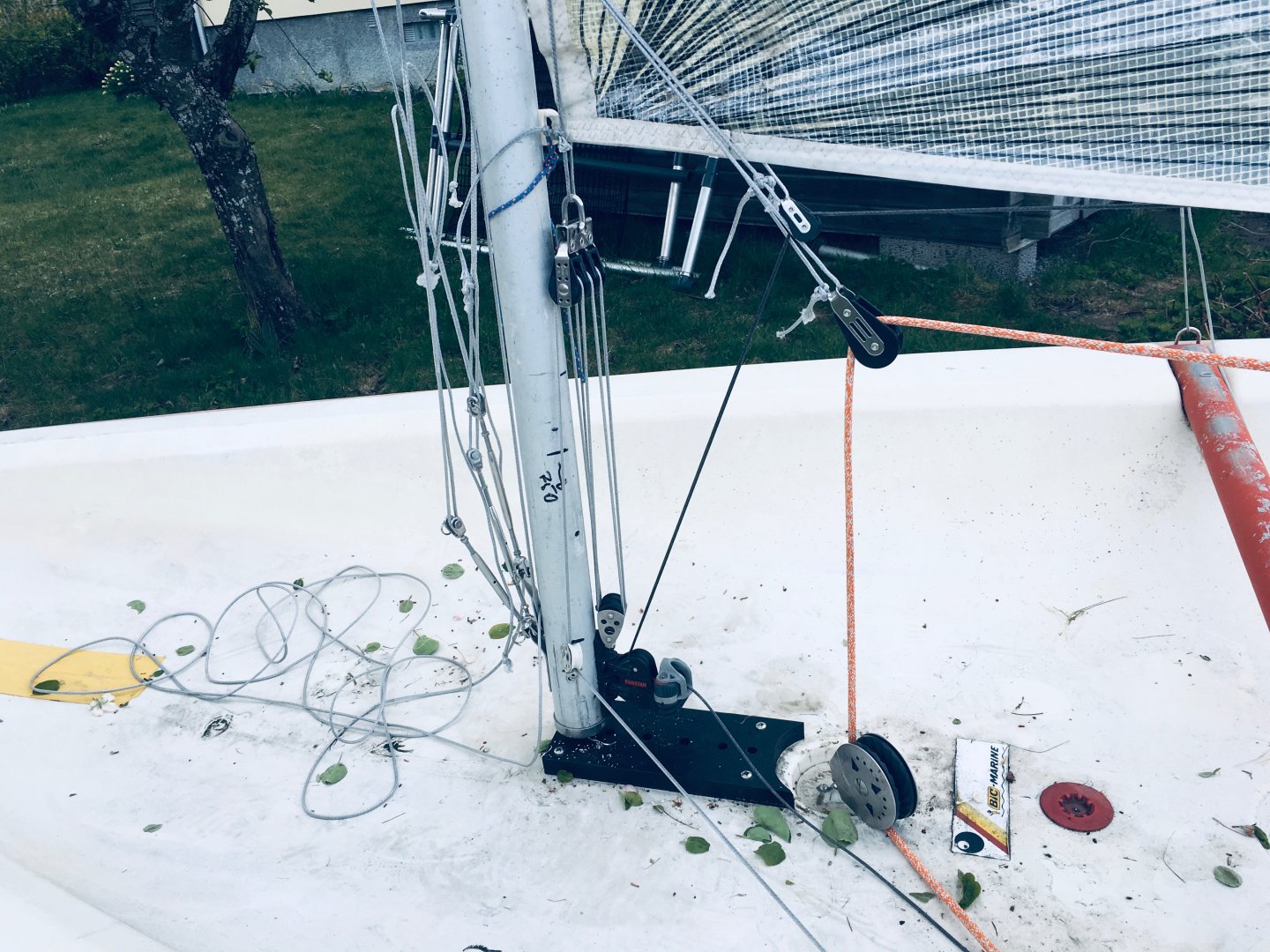

    The 195mm extension on top of the mast, together with the added extension of the boom seems to be just perfect . Made a new mast base from HDPE(nice material to work with), forward of the previous and used the original for fitting for the exclusive Swiss Oxen ratchet main sheet block. Mast in its most forward position and wishbone in its lowest position on the mast.
    Lots of soft shackles needed to make everything work and also being easy to detach. Every trim is extremely dependant of each other. Anyway it looks promising and worthwhile testing on water.
    Used the Waszp concept and will now refine everything. Downhaul will be led to camcleats each side just forward of the forward beam tube.
    The GRP battens that where delivered with the sail, are non tapered, will have to grind them down at the front.
    Time to rebuild the 80-90cm wings and add rudder and daggerboard!

    Finished the Waszp style sheet arrangement, outhaul and downhaul(decided to go 8:1 instead of 6:1). Will adjust wishbone height position when on water. Also began building the racks. Two weeks left to first sailing test. Love that sail!

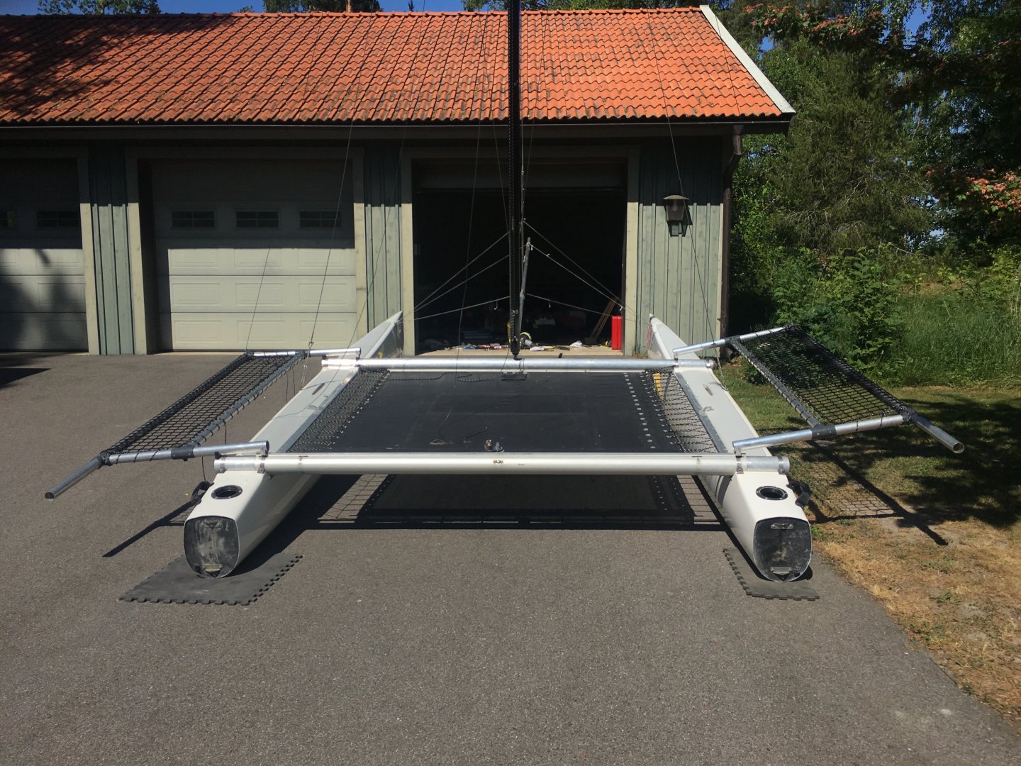

    Haha, no worries;)! The racks will completed with an inner tube with a net between the inner and outer.
    This is my 1ft 4" widened Nacra 5.5 with completed racks. The leeward rack is automatically lifted when you sit on the windward. The forward end is hung in the trapezewire, that also carries the lifting mechanism.
    I use 50x2mm alu tubing together with high pressure PVC fittings.
