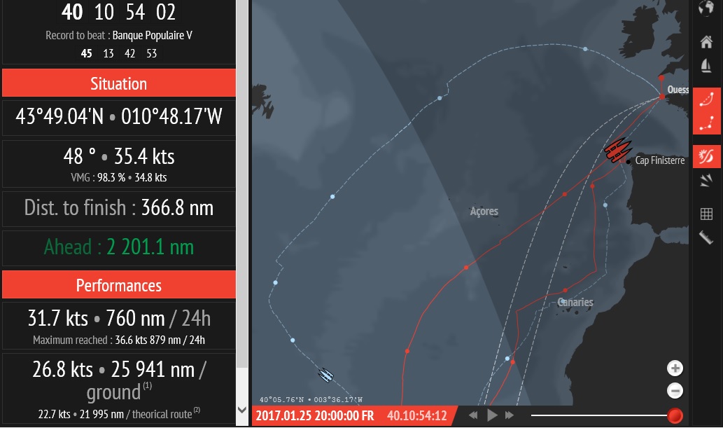

    At 7 am french time, 800 miles to go doing 31.1 knots of vmg.

    According to the tracker they have just finished with a time of approximately 40 days 23 hours and 33 minutes. Congratulations to Francis Joyon and the IDEC team.
    p.s. the official time from the IDEC team was 40 days, 23 hours and 30 minutes with an average speed of 26.9 knots over 26,412nm.
