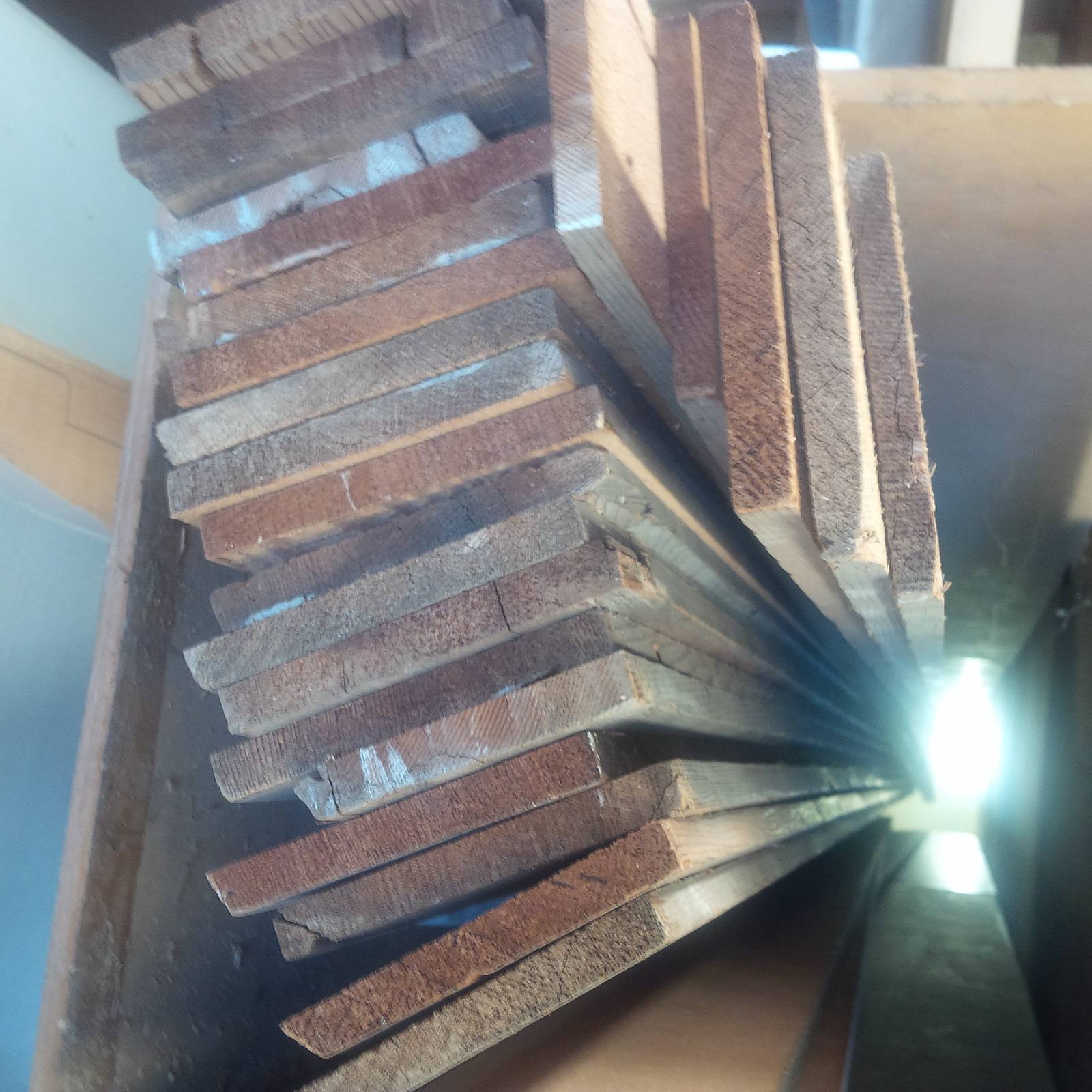

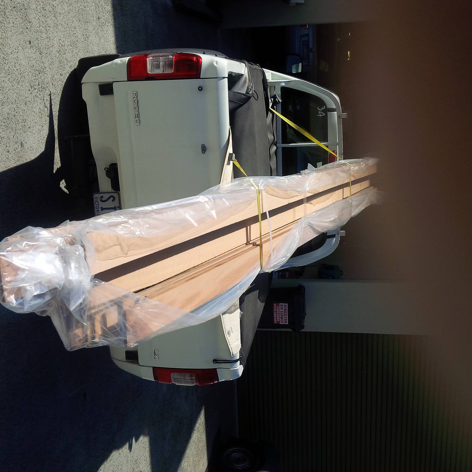

    I had my WRC resawn by a local company that specializes in recycled timber (Shiver me timbers in Clayton). The plans call for 12mm I had them cut to 13mm to allow some scope for sanding the roughsawn surface. I plan to rip the resawn timber into strips on my table saw to different widths to best accommodate the various curves that are required around the front fairing face of the beam.
