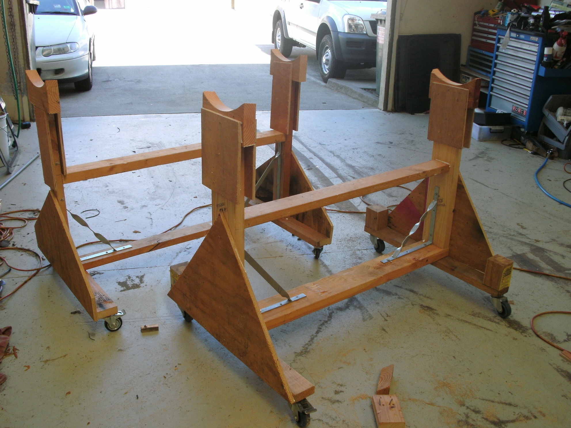

    I put together a couple of rough rolling mast cradles to support the spar when it arrives on the mast trailer tomorrow afternoon. I have a forklift which I've hired in for some work on my roller door which will be perfect for lifting into position on the cradles and then lifting up to the underside of my factories roof where we will hang it from the "C" beams till needed. Plenty of safety ties by the way to hold it up there.

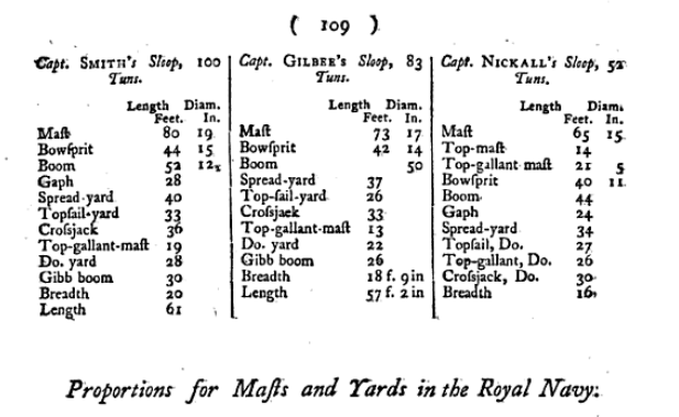

    P.S.: Maybe Corley will shock us with an 80 foot mast to overpower his F40 heavily. hehe... The table is from the book "The Elements of Naval Architecture, Or A Practical Treatise on Ship-building", published 1764. :)

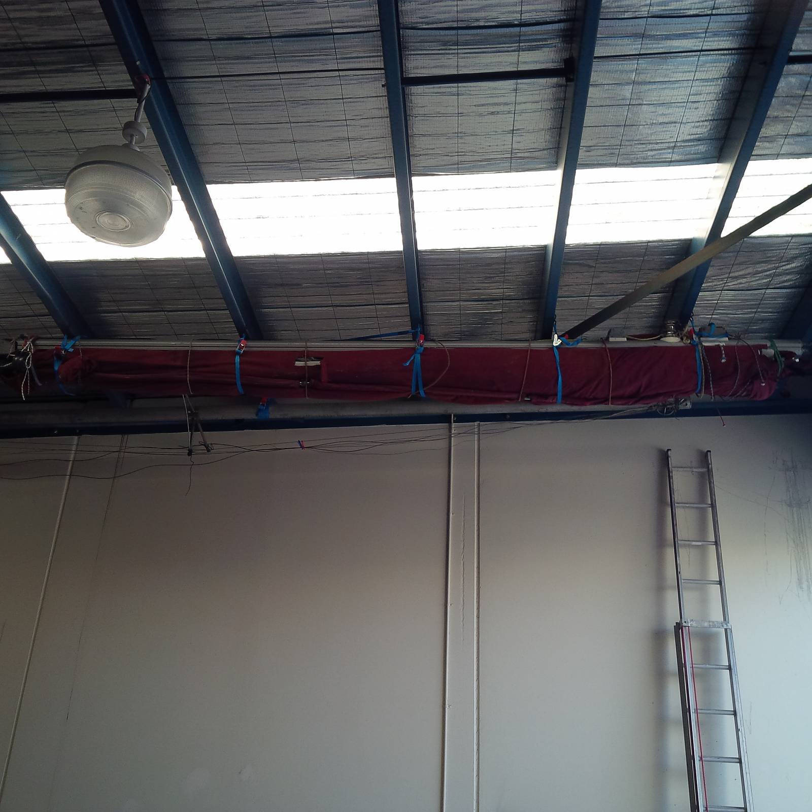

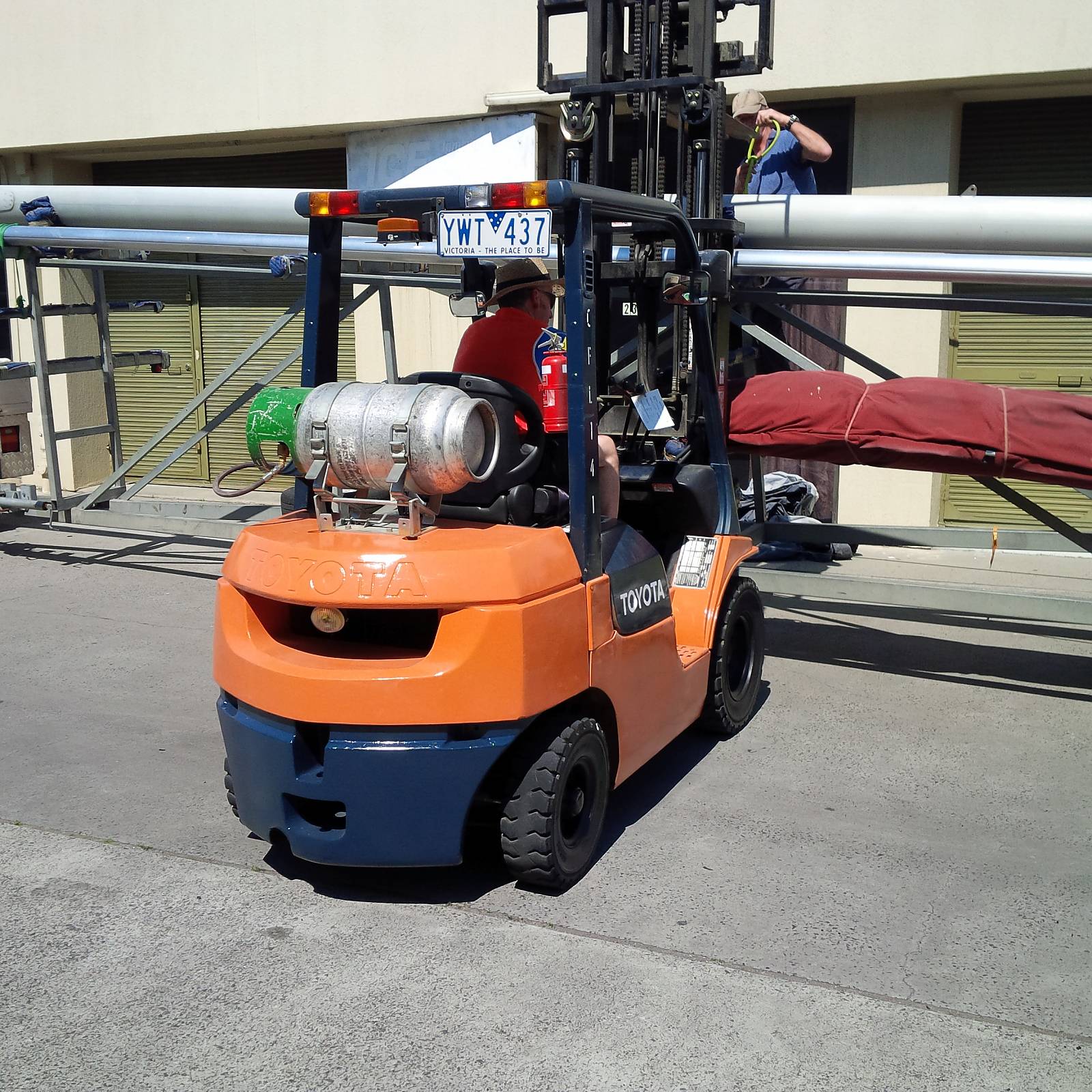

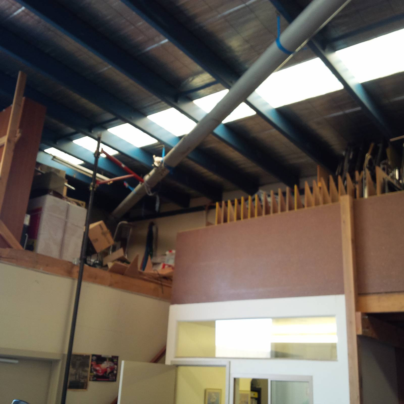

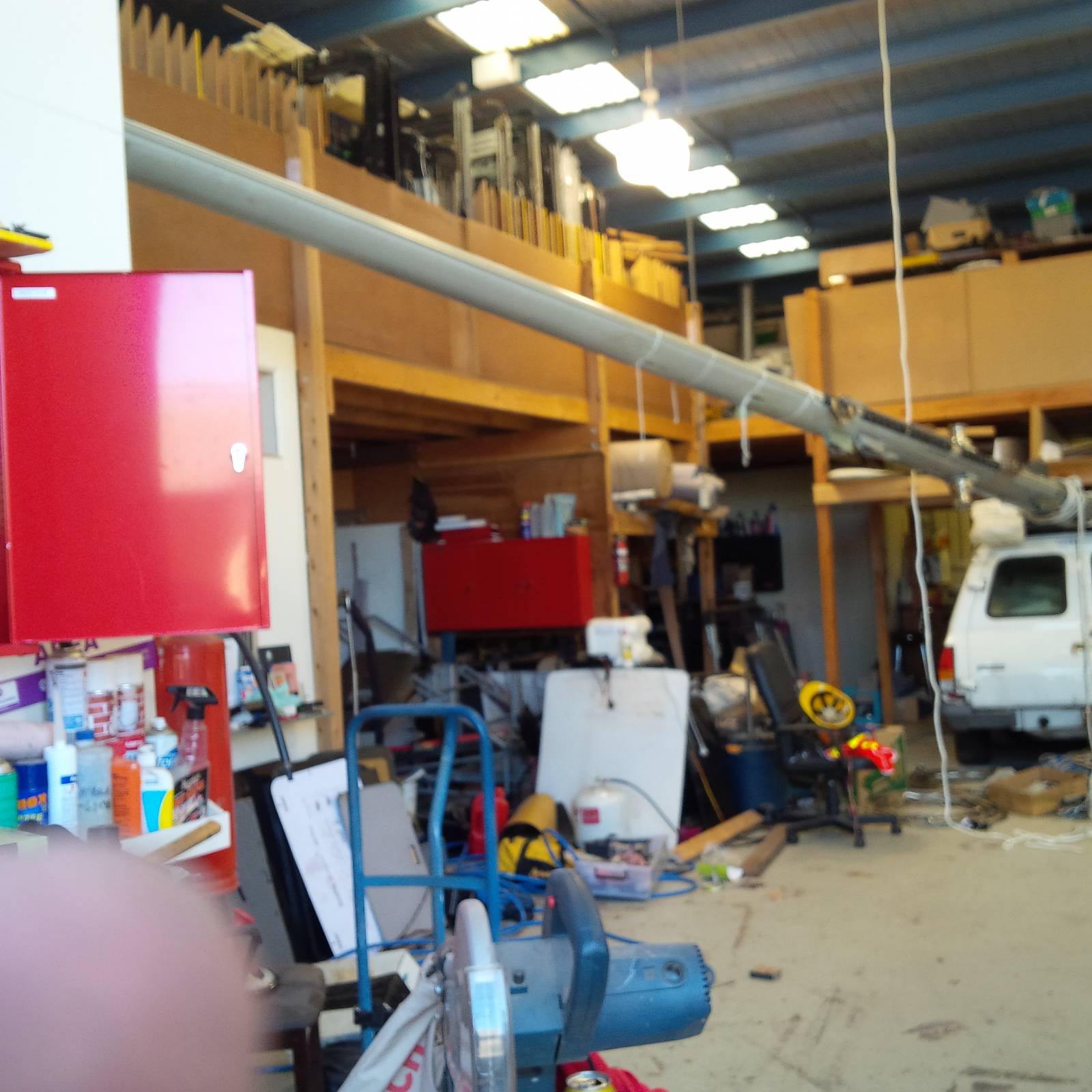

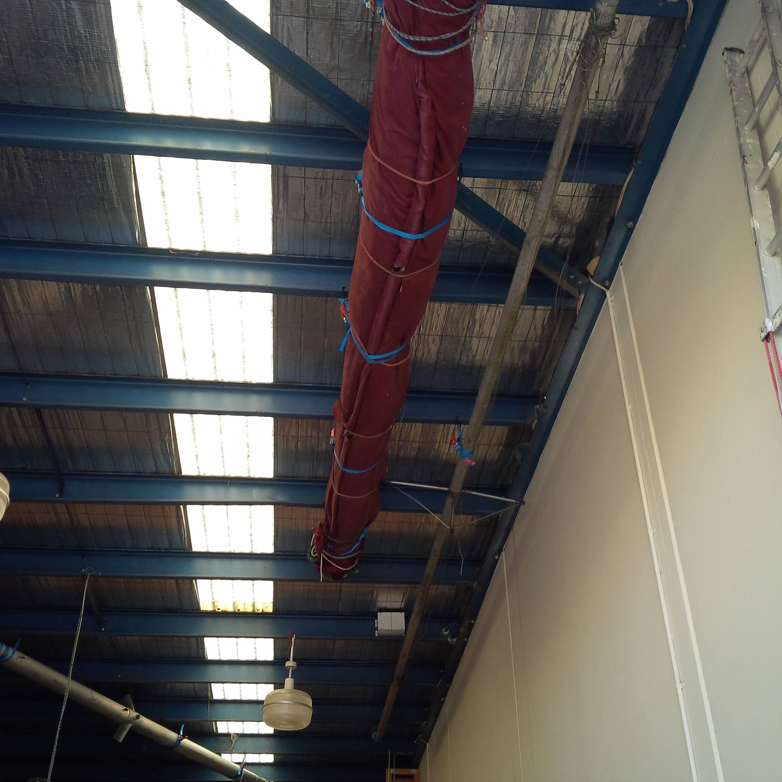

    After a hell of a lot of hard work and the help of my dad Graeme and good mate Murray I managed to fork, drag, hoist and strap the mast onto the ceiling beams of my small factory. It was collected from a storage yard at Toronto by Lake Macquarie stripped by the team at Whale Spars and transported down with a batch of spars that were being anodized in Altona. I had to cut a hole in the front of my factory's fascia to allow room to get the 19metre spar in. We did manage to fit it inside with room to spare although I think I'll get a second forklift next time to make it a bit easier.
    A few observations the spar has really good gear on it with lewmar rope clutches and Anderson winches. The mast base and crane are beautifully fabricated with very good welding evident throughout. The section is suitable for a boat with a fair bit of righting moment. The deal included a good main and boom plus 2 jibs a flat cut screecher and a masthead spinnaker. There is a halyard mount for a fractional kite as well.
