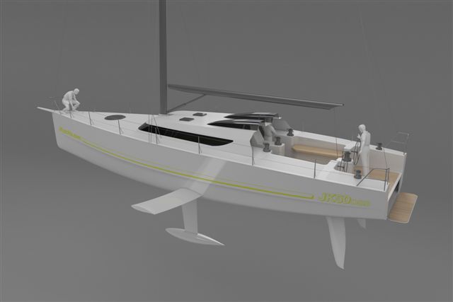

    Not reversed at all-the physics of the way the IMOCA foils operate is nearly identical to the way an UptiP foil operates with respect to leeway. But entirely different with respect to lift: the uptip foils are unique because of their ability to control the flight altitude of the boat they are attached to with leeway coupling. Since the IMOCA boats are not foilers(they don't fly above the water) the altitude is irrelevant but the foil assist lift -similar to DSS foils- generates substantial additional righting moment as well as reducing the displacement of the boat.
    There is absolutely no reason why these foils need be limited to "high performance" boats-"foil assist" ,particularly retractable versions of DSS, can be used on cruising boats as well as high performance boats.

    DSS foils don't encroach into interior space-they fit under the cabin sole and take up zero room in living accommodations. Maintenance is not a problem since the board is easily accessible.
