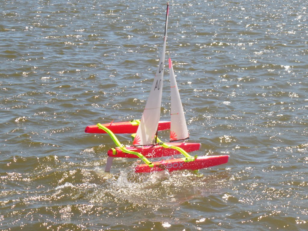

    Dusted off the cobwebs from the One Metre tri and took it for a sail south of Perth after Christmas - had a great time and will upload a video later this week.

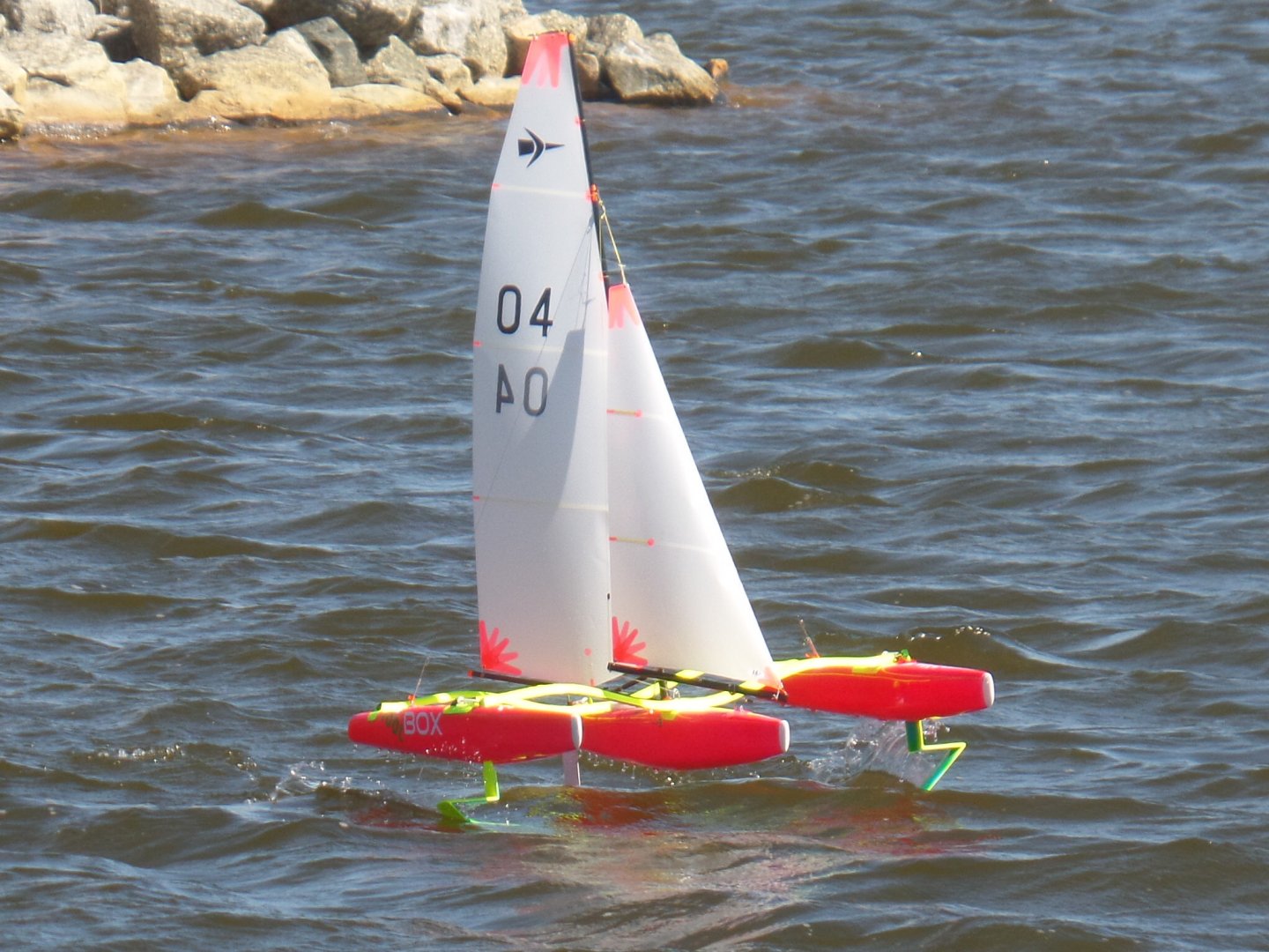

    Gusty winds today, needed #4 rig. Tried out a number of foil configurations but keep coming back to the simple hydroptere configuration
    cover2.jpg IMG_7398.JPG IMG_7412.JPG IMG_7449.JPG IMG_7456.JPG IMG_7492.JPG IMG_7371.JPG IMG_7375.JPG IMG_7459.JPG IMG_7536.JPG IMG_7532.JPG
    Doug Lord likes this.

    Always nice to watch
    Simple in appearance but great balance. The boat really wants to lift flat from the beginning. Quite a few other foilers appear to mismatch initial fore/aft lift.
    Do you push more of the weight onto the rear foil?

    Hi
    I just focus on making sure that the boat never sails with the bows up. If it does, then it means that the T foil on the rudder has too much angle of attack, holding the stern down and hence creating unnecessary drag. The T foil dictates how the boat lifts out of the water. If I am brave I actually encourage a fraction of bow-down sailing attitude, but not in winds such as I had on Sunday! Some people are looking into have the T foil adjustable when sailing. I simply don't see the need for this - the stern always follows the bows if the angle is right.
    But it is important that you CAN adjust the angle of attack, when on the shore. We used to just guess the setting then epoxy a shaft tube into the hull. Now we make a tapered shaft tube out of fibreglass so we can rake the whole rudder for or aft when on the shore to fine tune the setting.
