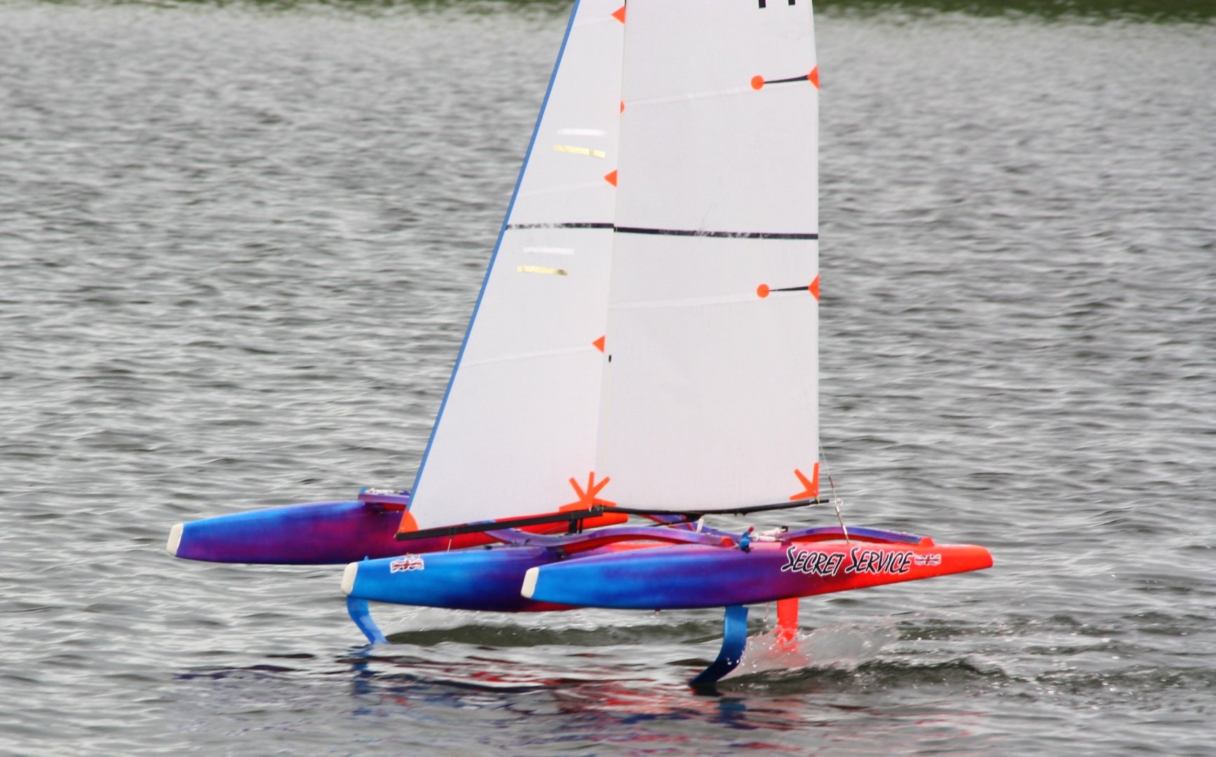

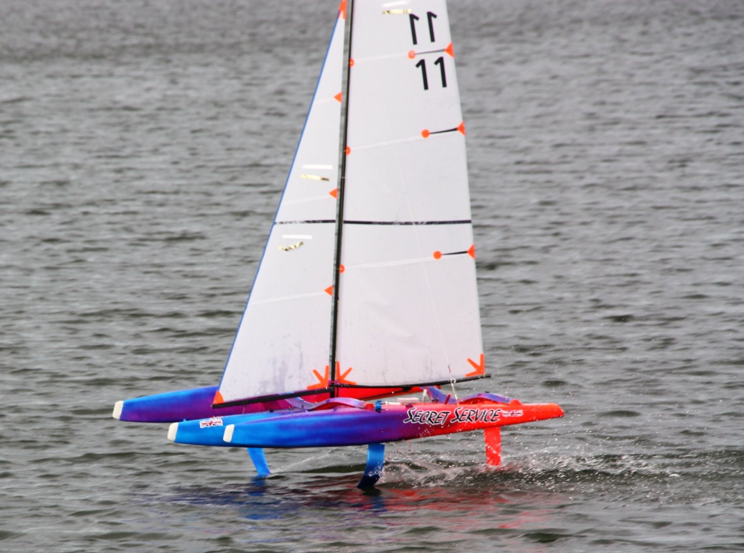

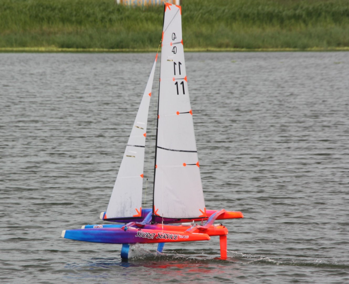

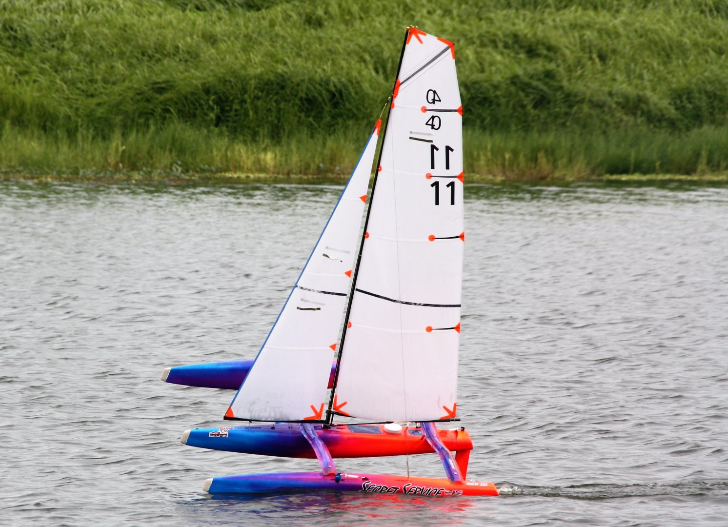

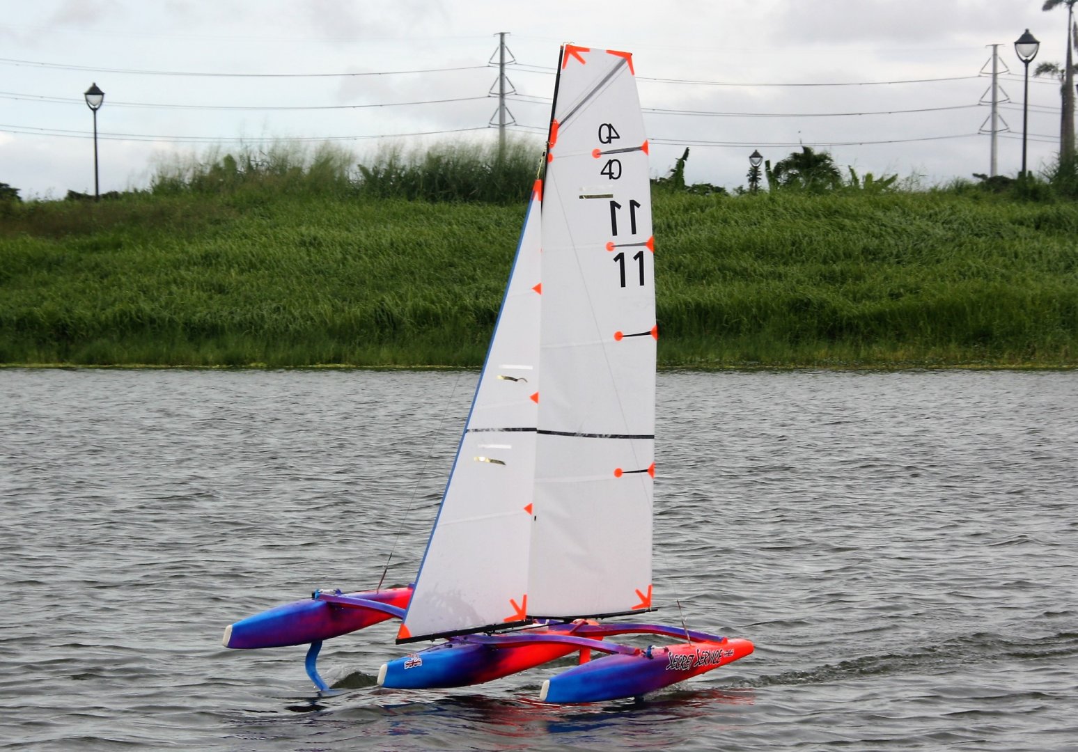

A good day today, the wind filled in for some decent sailing, and my latest attempts at sailmaking are an improvement on the past set of sails. The cut-down rudder looks perfect. its 29cm long from base of shaft to T foil. I tried my double foil at the end of the day but tests were inconclusive as I got the receiver wet inside the boat so had to stop. But the S foils are very good. I think it is sailing upwind better than my previous Mini40s in Australia, not sure if this is because of the new foils or the lower rig, or both!
Video is here:
Some pics attached too

The stability is very impressive given that you have no in-flight foil adjuster?.
Yes that's correct, I can only adjust the foil angles by the screw-adjuster while on the shore - same for the rudder T foil. Once sailing they are fixed. A couple of people are looking at installing gyros, as used in rc helicopters, but I am cautious about adding a lot of electrics. I am constantly looking at wand-controlled configurations and think I am getting close to having another go at this idea

Wonder if a wand would work on the rudder/foil rather than the conventional arrangement on the front foils. We steer the boat through the stern. Might provide system damping.
Keep up with the innovations.
The rudder foil adjusts pitch, not altitude so no, that won't work. Wand adjustment of the main foil directly affects height since the main foil carries all the weight, so a much more direct response.
pitch of the hull will determine height, pitch down to lower, pitch up to raise. The control wand alternates between pitch up and down and gives you height.
Yes, its possible to directly raise and lower the main foils but that requires far more energy than controlling pitch.
Controlling pitch of the fwd foils directly would seem to yield a twitchy control system.
It might be a possibility, that is all.
At the moment PerthMini40 is getting interesting results with fixed foils, fwd and aft. Controlling just the aft foil - he already has the pitch system built in - would seem to be easiest.
