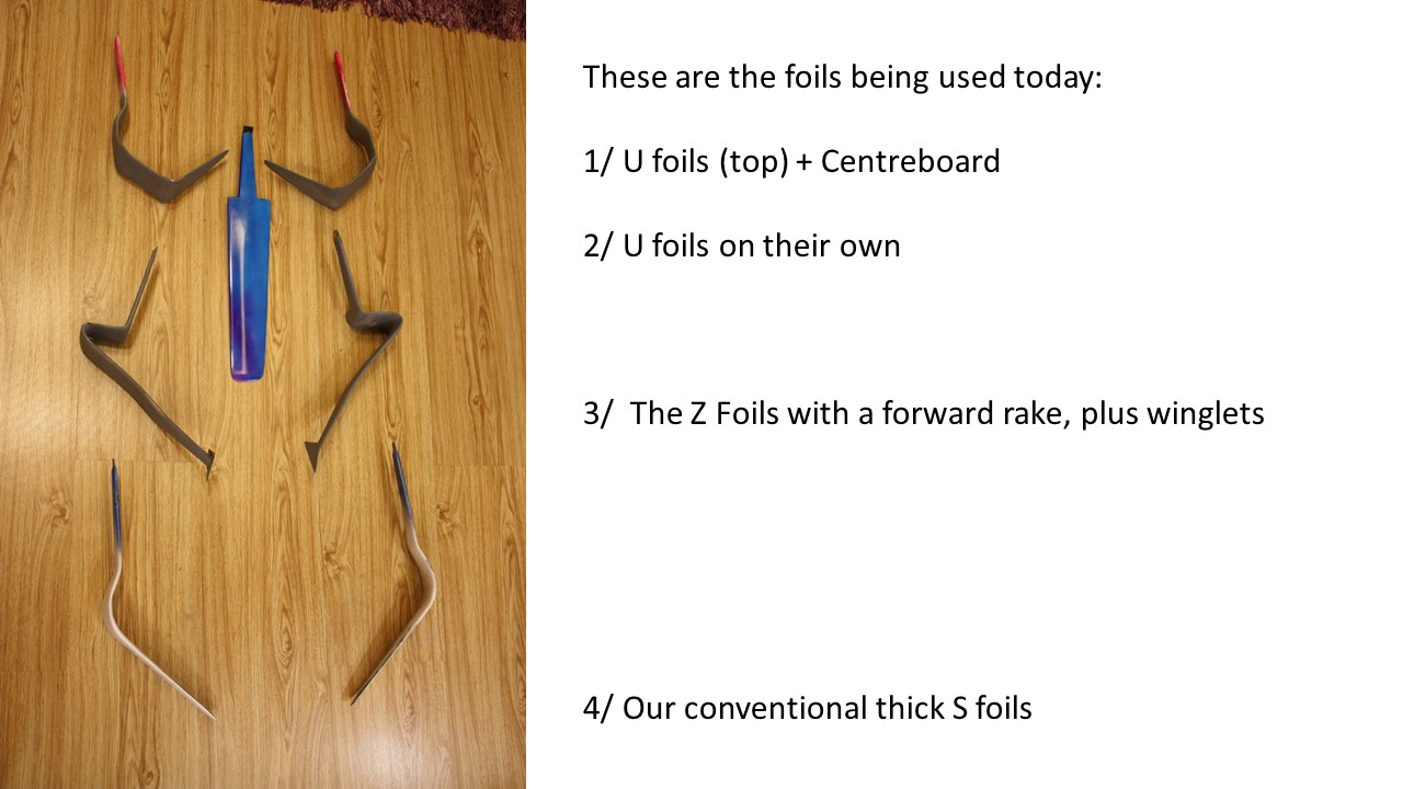

    Had a productive day yesterday, using 3 sets of foils and the centreboard, using B and C rigs, and learnt quite a lot. The forward raked foils with winglets on the bottom showed some promise (sorry, no photos of these on the boat). I'll upload a video later in the week

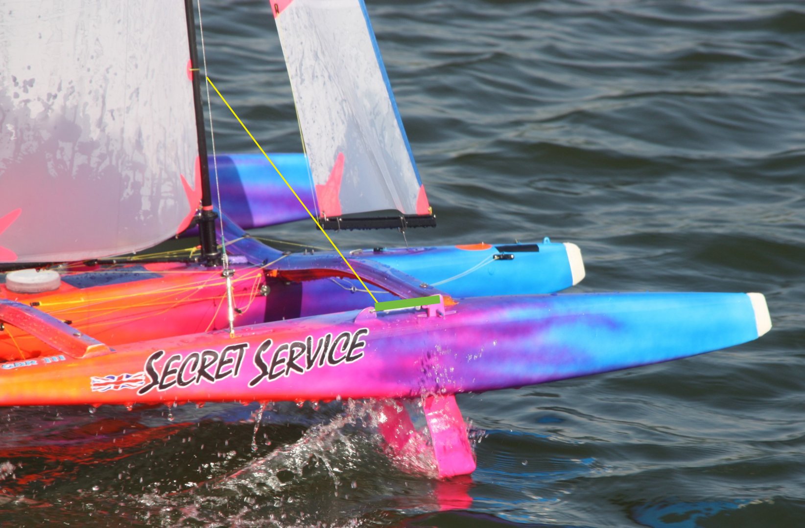

    The surface planing created by the windward U-foil looks to be significant and must make the boat very difficult to control. Did you increase the taper on those conventional kinked foils?
    one idea. The windward stay is carrying very heavy loads. No possibility of using the tension to drive the windward foil to slight negative AoA?
    The lee stay is slack so the lee foil takes its default setting of positive AoA.

    We have another idea - let the boat twist. If the cross beams are not locked solid to the floats, the pull from the windward shroud towards the back of the windward float will angle the windward float to point down at the bows to give less (or negative) angle of attack. So I am going to try sailing the boat next weekend with the front bolts on the cross beam/float connection intentionally loose (just a couple of mm) and see what happens. It won't have any effect on the lee float and foil, and the boat won't rack since the cross beams will still be rigidly attached to the main hull.

    Quick and simple test can be done when the boat has mast up and floating. With the "lee" float against a board, pull the mast top to lee and watch for windward float twist.
    I'll keep my fingers crossed for good results.
    You may get better response by splitting the shrouds, keeping the aft chainplate as is and taking the lower end of fwd shroud (yellow line) to the aft of the foil head, i.e. behind the foil pivot.
