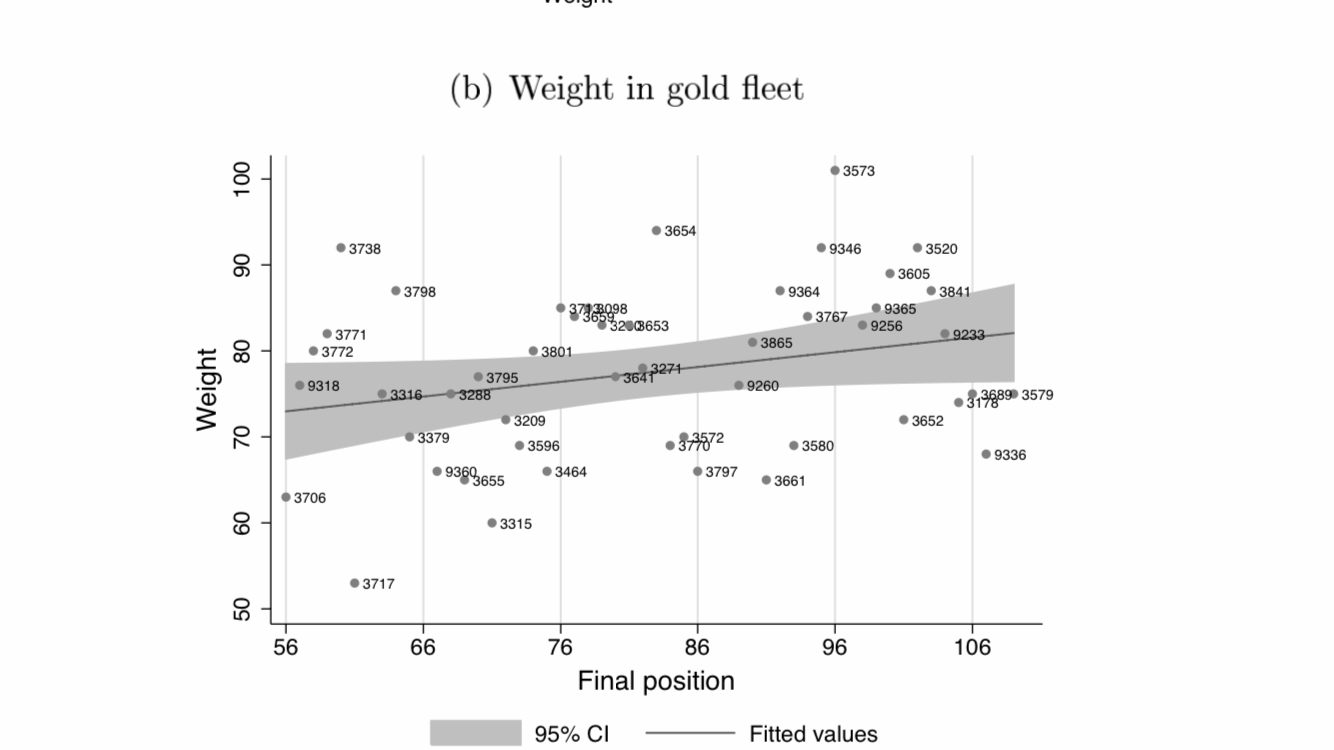

    Back to the original subject about foiling boats and crew weight! I suppose we are talking about sailing in winds where the boat is foiling. It would be interesting if there where some statistics from something like Waszp where all boats are equal. The graph about foiling moths I presented in the beginning of the thread shows a tendency to favour lighter crews. If everything else is alike the added incidence needed for a heavier crew would add some drag. But on the other hand a heavier sailor could trim the sail for added power to compensate and have added righting moment at hand. A VPP might tell us what to expect, but statistics from foiler championships will probably give more info. Maybe the Nacra 17 class have collected some data?

    That figure seems to only be showing the back half of the fleet. Or am I misinterpreting?

    My guess is aero and wing design matter more than weight. Aero already makes a huge difference in the much lower speeds (15-25kn) I do wingfoiling. When racing wingfoiling, the difference between squatting and standing can win you an upwind leg. What also helps is using the mast for upwind lift, which levels the board and decreases aero drag. A bigger rider could need a bigger board or kite, and is probably bigger themselves, increasing the aero drag. Every foil design also has an optimum lift coefficient for max l/d; different rider weights or sail sizes will change the load on a one design foil and thus Cl of the wings.
    I did some racing against Kai Lenny wingfoiling, he’s 50lbs lighter than I am and the winner was the one who had the best fitting gear, sailing skill (tacks, reading shifts, sailing correct angles), and luck.
    Predicting this will be really hard without more information on the exact wing, sail, and board design, the rules of the race, and loads on the rider’s body. As for a general sailing trend, scaling up seems to make things faster.
