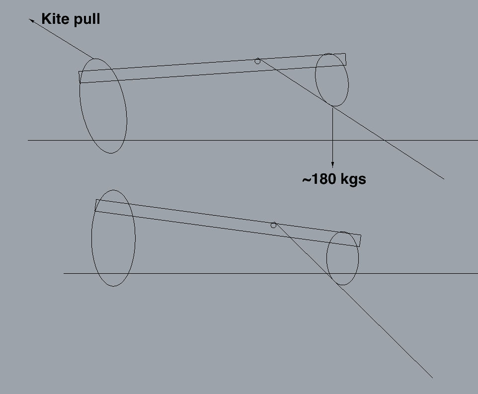

    The boat at https://vimeo.com/127926604 is a 7.5m/25' proa. It has a fixed foil under the 4m windward hull. 300mm chord, 12% ogival section with a flat high pressure side and a rounded tip. The kite is attached to the other hull, so the foil is lifting the crew, hull, half the beams and itself. About 180 kgs. The surface of the foil is peel ply/40 grit sandpaper, ie pretty rough by most foil standards. The edges are sharp, except for a few dings. Angle to the water surface is about 50 degrees at rest, 40 when flying. Lift off speed is about 10-12 knots.
    The foil was built for another purpose and used for this boat because we had it. Due to it's crudeness, I thought it would fail, was pleasantly surprised at how well it works.
    The kite/proa/foil arrangement has been successful enough that we are thinking about scaling it up to a 15m and sailing it offshore.
    Questions:
    1) How should we scale the foil up for the bigger boat. Kite sizes will be 50% larger, weight to be lifted will vary between 140 and 300 kgs, depending on where the crew sit. Lift off speed about the same.
    2) the foil ventilates for half it's chord and almost it's entire length a few times in the video. I thought that this would cause loss of lift and/or large drag. Doesn't seem to. I also thought it would be hard to get the flow to reattach. Doesn't seem to be.
    3) The faster the boat, the more foil comes out. So the tip shape gets more important. At present it is bog rounded with a grinder. What is the best shape?
    4) Downwind, the kite loops lift the bows up to a metre out of the water and speed increases, a lot. No idea how much, but let's say 20 knots. However, it does not foil, even with my 80 kgs moved onto the long hull.
    5)What would the optimum foil size, shape and section be for the boat in the video, and how much improvement would each aspect make?m Ditto for the 15m.

    Is the primary purpose of the foil to resist the sideforce from the kite (like a daggerboard), with the vertical lift being sort of a bonus. Or do the hulls and/or other appendages provide enough lateral resistance that the foil is mainly there for its vertical lift ?

    Both. There are no other appendages (steering is by moving the kite line attachment). The hulls are semi circular cross section and draw comparatively little. We go upwind without the foil a little better than a well sailed twin tip kite board.
    Doug,
    The foil is attached to a tube between the beams and bears against the hull. Pretty ugly, but I had so little faith that it would work that I did not bother with elegance. I have added a fairing piece where it connects to the hull to spread the load (first test, the foil holed the 5mm foam with 300 carbon each side hull) and fill the gap between the round foil and the hull.

    Rob : I'm not going to pretend that I can answer all of your questions, but I do have some thoughts about the foil on your proa that might be helpful.
    In my earlier post in this thread, I asked about what you considered the primary role of the foil to be. My own view of this is that it is primarily an augmentation to the lateral resistance, with a bonus that it can be used to lift your windward hull sometimes. I emphasize the word "sometimes" because a boat that has only a single inclined planar foil needs more than just boatspeed to get the foil to lift. Unlike most other foil systems, it
    depends heavily on the sideforce, because the force on the foil (excluding drag) is essentially entirely in the direction perpendicular to its surface. This is not true for systems with 2 or more foils or with foils having fins or other nonplanar shapes.
    To explain what I mean, let's consider the balance of forces. If we can assume that the hulls contribute very little to the sideforce, then these force balances are especially simple. The sideforce on the foil is simply the same as the sideforce generated by the kite (in the opposite direction), and the vertical force is that sideforce divided by the tangent of the foil's dihedral angle. (Assuming the foil is large enough to generate the force required). If you try to increase the vertical force by increasing the foil's incidence (in pitch), the boat will simply slide sideways & adjust its leeway angle until the force balance is reestablished.
    In your case, the vertical & horizontal force components would be about equal, since the dihedral angle is close to 45 degrees. So, if you can estimate (or measure) the forces on your kite, you can easily determine whether your foil will be able to provide the sort of vertical force you need.
    Obviously, in many cases, it won't be able to. In particular, the foil will never lift when you are going downwind, because there is little or no sideforce. This explains the situation in question #4 of your original post.
    Including the hulls' contribution to the sideforce will probably make the situation worse, since it reduces the sideforce that the foil must develop. However, since your foil has a large amount of camber, you may encounter some situations where the hulls & the foil are lifting in opposite directions (ie - negative leeway angle), & then the sideforce on the foil would be larger than the kite's. That's a weird situation, though so I won't discuss that more now.
    It was interesting to watch all the ventilation & reattachment in the video, especially how readily the flow seemed to recover. Supposedly, ventilation will not occur unless there is flow separation present & the sharp leading edge is certainly conducive to separation if the incidence is outside a very narrow range. It might help to diagnose the situation if you could use the force estimates (determined as above) to calculate the force coefficients that the foil is operating at.
    Determining the coefficients should also be of some help in trying to optimize the foil on your current boat & deciding how to scale the foil for your larger boat.
    All-in-all, this is a very interesting project & I wish you all the best in it!

    Rob : Here's a quick look at some numbers :
    If the kite is pulling on the boat with a force of 100 kg at 45Deg above horizontal, then projecting onto a horizontal plane gives 100 * Cos(45Deg) = 70.7 kg. If that force is angled 15Deg. forward of the beam, then the side component is 70.7 * cos(15Deg.) = 68.3 kg, & assuming a foil at 45Deg, the vertical force component is also 68.3 kg.
    This is a far cry from the 180 kg you would like it to lift, but maybe the assumed force of 100 kg is too low. Would you know, for instance if the force could be twice that much ? Or did you just pick 100 kg as a nice round number to illustrate the calculations?
    In any case, given the force components on the foil, the total force is just the square-root of the sum of the squares of the components. (Fn=96.6) And the normal force coefficient (Cn) is just the total force (Fn) divided by the product of the dynamic pressure (q) and the planform area (A). (Cn = Fn / (q * A))
    To go further, I have to make up some numbers that you didn't tell me. To get the dynamic pressure (q = 1/2 * waterdensity * boatspeed^2), we need the boatspeed. In 20 knots windspeed & sailing upwind, a boatspeed of 15 knots is a possibility. Assuming that, gives q~ 3114.5 kg/m^2. To get the planform area, we need the span, but given a chord of 300mm, I'm going to guess a span of ~1m. That gives an area of ~0.3m^2.
    Putting those numbers together gives Cn= 96.6 / (3114.5 * 0.3) ~ 0.10
    This is the value assuming that the entire foil is underwater. If it is only 50% in the water, then the value grows to ~0.2. But this is the total force coefficient & the largest local values will be somewhat higher. If they are as much as 50% higher, then the value of Cn would still only be ~0.3, which is a small enough value that you wouldn't normally expect to see very much flow separation.
    Since this is all based on a lot of very tentative numbers, I'll leave it for later before speculating about the reasons for the behavior of the foil.

    100 was pretty arbitrary, based on kite boarding guesses. ie, a kite will lift 100 kgs in a jump. But this is higher loads than when the kite is only propelling the board and rider. (I think). I will mount my trusty fish scales and see if I can get any more accuracy.
    Estimates are:
    Boatspeed at lift off is ~10 knots, 12-15 upwind.
    Span in the water is about 1m, and about ~75% of that is out of the water in the video.
    I have refitted the foil a little more securely and got my gps working. Took it for a motor yesterday and with me on the lee hull, and turning quite tight circles with the foil on the inside of the curve, it foiled at 9 knots.
