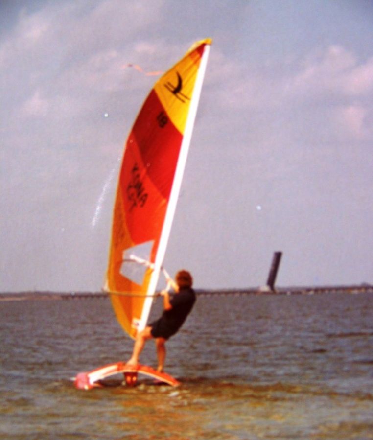

Yes-a lot. I also designed and built the first production catamaran windsurfer in the US-the Kona Kat.
I disagree 100% with your assessment of the possibility of a kid learning to foil an Optifoiler! All you have to do is watch the video's I posted earlier to realize that it won't require dramatic movement (most of the time)-because the Optifoiler has better designed-in pitch control than a kitefoiler or foiling windsurfer to start with. Once they get the hang of it it will be a blast!
Pix-Me,Tom Knight,Rosy (and her wonderful dog), Tom again- testing:
