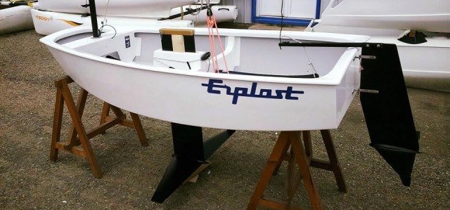

Hasn't anyone looked at this seriously? Glass–covered wooden foils? No method of controlling height or AoA of the main foil? No method of adjusting rudder angle? Extremely short rudder "strut"? Extremely inefficient foil shapes? Winglets? Really?
And best of all, no way to remove the main foil once the centreboard is inserted and the foil attached. Is it supposed to be attached and removed as part of rigging and de–rigging the boat?
All lift from the rudder will be transmitted through the locking spring on the top pintle to the top gudgeon. There is no indication of how lift from the main foil is transmitted through the centreboard case.
It's an April fools joke that missed it's deadline but was published anyway.

Hi, Gurval! Have they done any testing yet? I gather that altitude control is by moving crew weight which seems like it has a good chance of working.
Any more info would be appreciated!
I disagree with that, Doug. It is extremely hard (I am struggling to not use the word "impossible") to control the dynamic stability of that configuration by moving the crew weight.
Don't know if you have ever sailed an optimist... I did in my youngest days, and it goes like this - your legs are pushing upwards on the hiking straps, feet in mid-air. Your butt is pushing down hard on the gunwhale. You can only move your upper body and have neither the agility nor the extent of longitudinal body translation required to shift the CoG of the boat quickly enough to compensate its movements. You are left with controlling the pitch, yaw and roll of the foiling opti with the sail tension and rudder only - which is theoretically possible but I wan't to see it happen in the real life. ;)

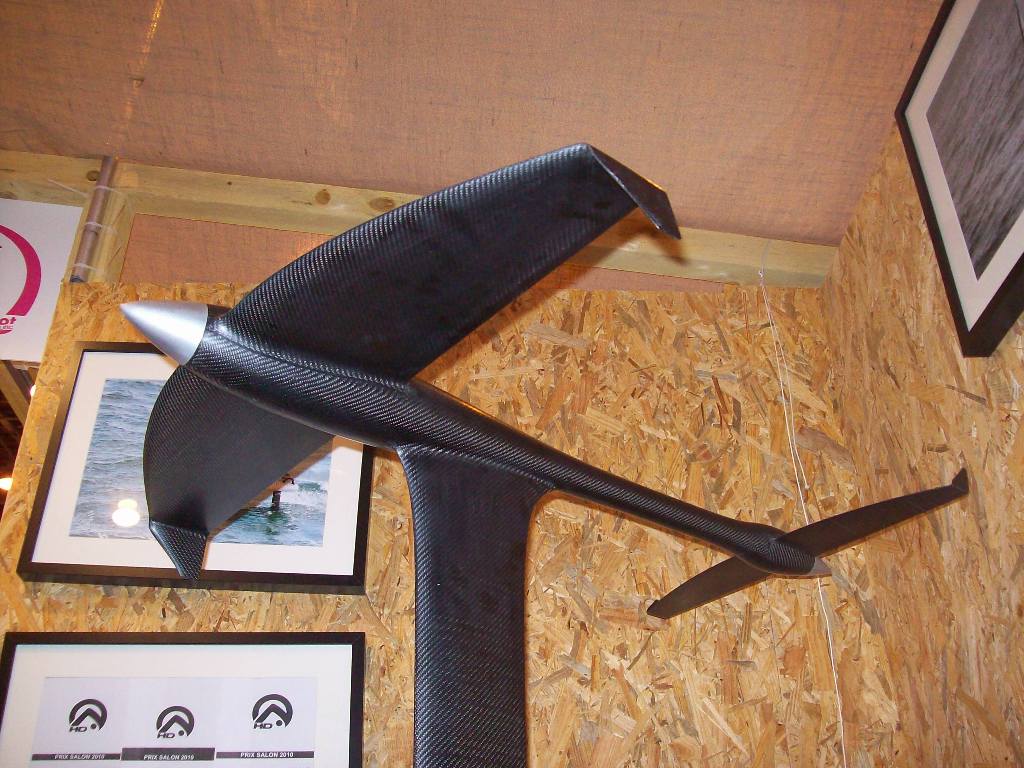

Slavi, never sailed an Opti but spent a few years in a 9' Dyer Dhow(pix below). If you look at the foils on a kiteboard or foiling windsurfer the distance(footprint) between the main foil and aft foil(footprint) is half,or so, of the footprint of the Opti and if you watch the guys foiling there is very little detectable movement. In other words, the foil system on the Opti will lend itself even better to crew weight altitude control. And then there's the comment in one of the links above that weight-shifting was what the designers intended for altitude control....

Yes that's true, it's hard to have a good weight transfer on a optimist (same for the other boats) but it is possible. It's like every systems, if you just can have a small input on it but if it's enough for control, that works.
At my humble optinion, the good way to do that is to use 2 foils (rudder and daggerboard) with positive angle of attack but a llitle bit more for the rudder.

If you look at the foils on a kiteboard or foiling windsurfer the distance(footprint) between the main foil a aft foil is probably 25% of the footprint of the Opti and if you watch the guys foiling there is very little detectable movement.
I wouldn't use kite and windsurf boards for comparison because they are very different kind of animals, relatively easy to control due to the body-mass to board-mass ratio. Basically, the CoG of kitesurfer's body is pretty much the CoG of the board + windsurfer. Similar situation for the windsurfers.
Furthermore, the apparent wind is very high (compared to the true wind), so the small true-wind perturbations are effectively damped by the high speed of the board.
In case of an Opti, the boat's weight is comparable to the body weight of the kids sailing it, hence a longitudinal body movement 2X is necessary to shift the boat's weight by X (in percentage). With their feet hooked to the hiking straps, it is a very hard task - absolutely not comparable to kiteboards and windsurfers.
Foiling speed is also necessarily lower in this case (just consider the weight and the anti-aerodynamic shape of an Opti boat), which means that any true-wind perturbance has a much bigger influence on the boat's dynamics. Hence a hypothetical foiling Optimist with that foil layout would likely require quite the oposite to what is available - quick and ample range of body movements, coordinated with an efficient sail and rudder control.
But that's just my two cents worth. I've been wrong many times before, and might be wrong in this case too. Time will tell.
Cheers
I disagree because of the huge difference in footprint---and because the designer thinks it would work.....
Anything can work in a very specific environment and under a fixed or narrow range of design conditions.
Usable things have to work and be controllable in the off-design conditions too. ;)
