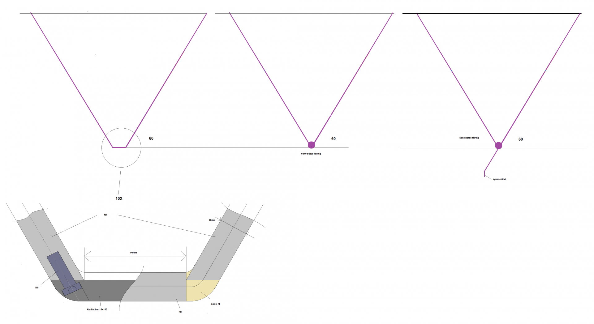

    Quite a while ago Doug Halsey and Tom Speer discussed cavitation of Doug´s Broomstick.
    Starting at post #33, Tom Speer recommended to either try a "coke bottle fairing" at the joint or "Perhaps the simplest option at this point would be to cut off the bottom of the V and add a flat piece connecting them together, changing the V to a trapezoidal U."
    Foil Cavitation at Lower Speeds Than Expected https://www.boatdesign.net/threads/foil-cavitation-at-lower-speeds-than-expected.53927/page-3#post-746625
    Tried to interpret two of Speer´s suggestions. Also added a third one that has been discussed. As only straight foils are available, question is which way to go?

    The first option is what I had in mind. I can't tell what you are doing with the second option, because you haven't shown the longitudinal profile. But I think a small fairing like you've shown may be ineffective.
    The third option is probably going to be much like the second. Extending the foil will lessen the loading and reduce the velocities near the joint a little, but I don't think you'd see much difference.

    About the second and third option, let’s say we hit it off and made an ideal ”coke bottle fairing”? From an earlier duscussion, I am aware of that it is no easy task to do the ”ideal” fairing.

    revintage: If the V-foils for your boat have the outer legs of their V's extended past the apex, you will probably have the apexes out of the water whenever cavitation might possibly occur. In that case, the extra fairings wouldn't matter. They might still be helpful in other conditions, but they seem like an unnecessary complication for any but the most determined amateur builders.

    You need to be able to estimate the surface pressures in order to properly design the fairing. A panel code is about the simplest method that will do the job. The biggest challenge is creating the surface grid for the panel code. Most panel codes originated in the aerospace industry, and our hydrofoils don't much like airplanes. But you can do it with CAD scripts.
