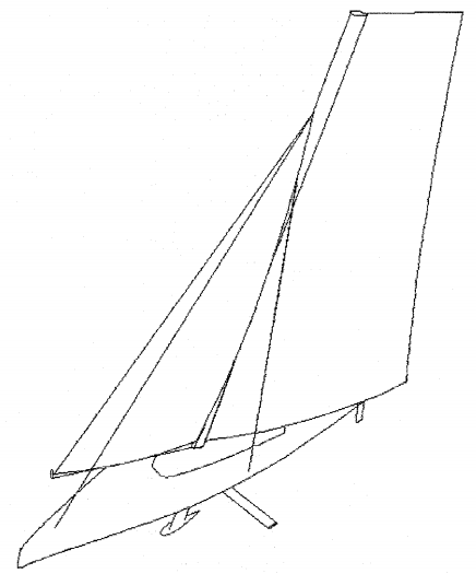

    Most of the features in the DSS patent abstract are consistent with nearly every hydrofoil (lifting, stowed and deployed conditions, protrude outward, etc.), the fact that the Sailing Booster claims similar features is not remarkable. There are many examples of stabilising fins on ships and submarines that fit most of the same criteria, but you wouldn't consider them DSS ripoffs.
    The novel (i.e. patentable) part of DSS is in the detail, not the general application of a moveable hydrofoil as a stabiliser or lifting surface.

    Yes, patents protect the novel device. The stuff thrown in explaining what good things you get out of that device are of no consequence legally.
    From what I can see, the pivot down foils would not be a violation of the DSS patent because DSS is about how the foil slides out of the hull and in what position.
    We should have a forum for "Boat Design IP" and how to handle it, respect it, and profit from it. Doug is not the only one with misconceptions.

    I have no misconceptions about patents -the DSS patent in particular. I've worked on patents researching them, writing them and getting a few for over 40 years with guidance from one of the best patent attorneys in the US. I can assure you that the "Sailing Booster" is an attempted rip-off of DSS up until the point it is sold-then it is an actual ripoff!

    As above the claims (big 13 at top of page) are the only part of the patent with any legal importance. The claims are rather specific narrowing the scope of the protected idea and making it easy to work around.
    If claim one has said something like a ‘a sailing vessel with a board projecting out of the hull at an angle plus or minus 60 degrees from the horizontal at rest’ and then become more specific latter on it would have been strong. I suspect the prior art has driven them to such a narrow set of claims.
    https://patentimages.storage.googleapis.com/3b/04/65/edda9bc741beb9/US7644672.pdf
    There is a ton of prior art and I am not going read them all, this one is poorly translated but from a scan read covers the essential operation of DSS. There are many pictures but a this one show a stabilising foil sliding through the hull.
    Google Patents https://patents.google.com/?q=lifting&q=hydrofoil&q=vessel&q=position&q=sailing&before=priority:20060407&scholar&page=4

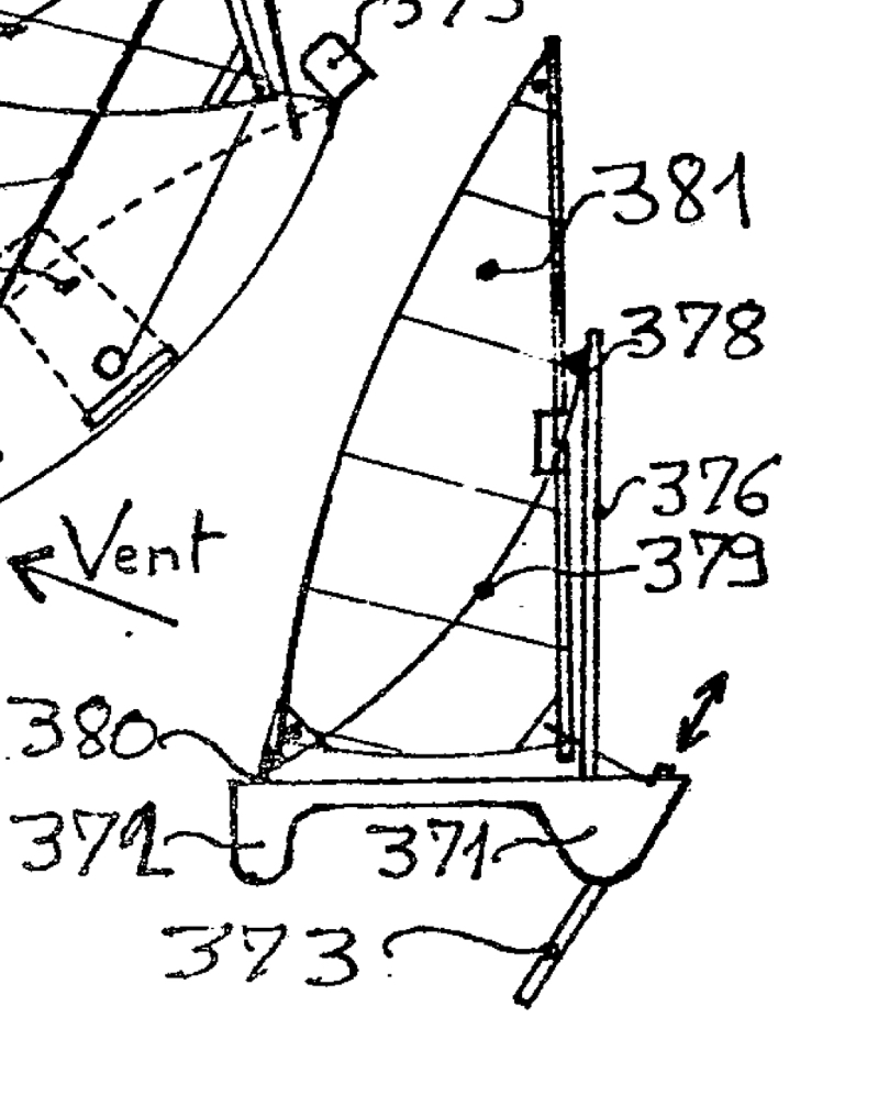

    https://patentimages.storage.googleapis.com/f5/e8/97/988229d8c74421/FR2542274A2.pdf

    In deed, there is a French patent listed by the DSS patent as prior art. Figure 1 looks remarkably like the DSS configuration, it's a pity the translation is so poor and there aren't more diagrams.

    PS. This is not to say I think the DSS patent is invalid, it's only to show that there are quite a few similarities between the various patents. Those similarities don't necessarily make any one a "ripoff" of another.

    The DSS patent is very narrow, here are a few of the clauses of claim 1 and all the following claims link back to claim 1
    (e) wherein the lifting hydrofoil when in the deployed position is oriented at a predetermined angle of attack to a fore and aft plane of the vessel, the predetermined angle of attack being between about 2 and 6 degrees;
    (f) wherein the lifting hydrofoil when in the deployed position is oriented at a mean angle of between about 5 and 20 degrees to a horizontal plane when the vessel is in a non-heeled state so that the lifting hydrofoil is substantially parallel with the water plane when the vessel is heeled to a normal optimum sailing heel angle;
    (h) wherein the lifting hydrofoil has an exposed span that is greater than about 7% of a height of the tallest mast of the vessel, the height measured from the water plane
    It doesn’t take much imagination to design I system that works like DSS but outside these claims
