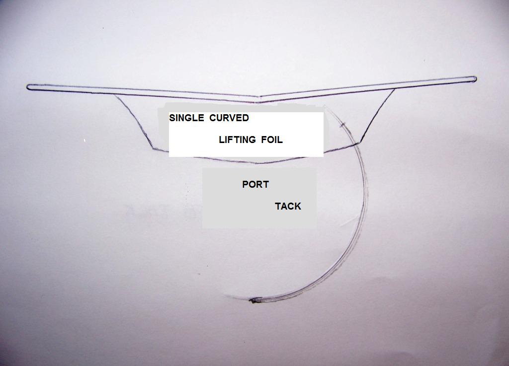

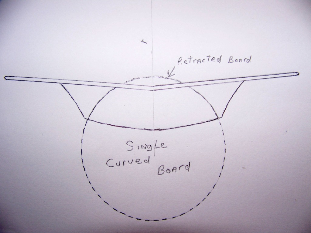

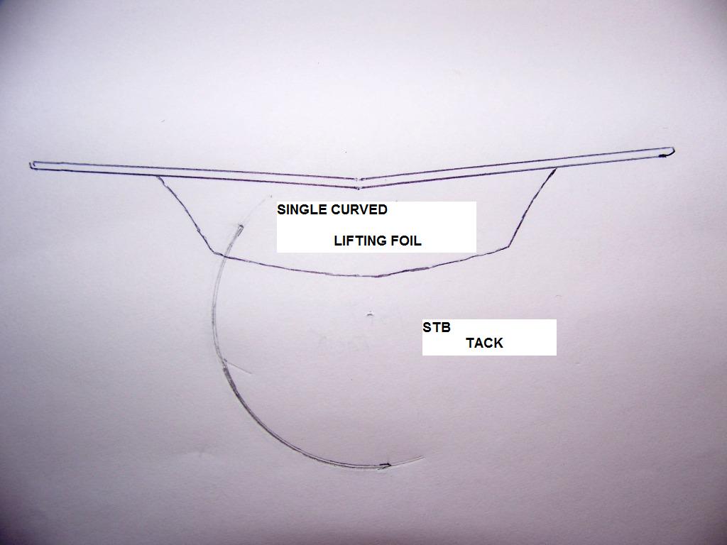

    Wow-a single curved foil! I had an idea for a continuous curved foil for a dinghy a few years ago-never did anything with it. Juan K has what looks like a real good set-up.....
    Single curved foil + Dinghy 001.JPG Single curved foil + Dinghy 002.JPG Single curved foil + Dinghy 003.JPG
