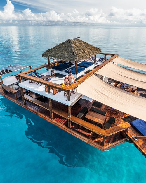

    I'm wondering if any of you fine people would be willing and able to talk through some of the logistics of building a floating bar.
    I live in The Bahamas and I'm trying to put together a business proposal that would cover all the necessary aspects. I'm in the process of designing the above water aspect, but I'm not very well versed in buoyancy and stability.
    I've attached a photo of a currently existing floating bar I think has a good design that I would like to mimic. It's about 3000sq.ft on the lower level and an additional 1000 sq.ft on the upper level. I've estimated a total weight of 65-70,000lbs that needs to be floated.
    If anyone has experience in designing something along these lines I would love an opportunity to chat with you. Happy to compensate for the right person.

    A few questions - re your floating bar, do you intend to moor it in one spot semi-permanently in the Bahamas, or will it have to be able to undertake slow cruises with passengers / drinkers along the coast?
    A floating bar that has 3,000 square feet of deck area is approx 55' x 55', or approx 70' x 43' - either way, this is a pretty big boat to build!
    Where are you planning on building this bar - locally / nearby on a beach, or further afield?
    You will definitely need to have a sound appreciation of doing calculations / estimates for buoyancy and weights before you jump too far into this project.
    I hope that you do have (at least) a seven figure budget in US$ available for building this floating bar?

    What calculations have you done so far to assert that this will give you enough buoyancy? Have you done any rough buoyancy or weight calculations yet?
    Again, what calculations have you done so far to determine that they should be 'sufficient' to carry the weight'?
    If we assume a maximum loaded draft of 2' 6", then this gives you 2' 6" of freeboard on the hulls - which is not a lot really.
    Two of the above hulls at 2' 6" draft will have a buoyancy of 128,000 lbs, or 57 tonnes - this will be your load displacement.
    But you want to be able to carry 74,000 lbs (which is 33 tonnes) - this leaves 22 tonnes for the hulls (11 tonnes each).
    Is this enough?

    The difference with decks on land, and decks floating on the sea, is that you don't need to worry about if you have enough buoyancy to support your deck on land - the land supports it very well.
    So, as a first step, you should design everything above the deck level re this bar / restaurant - sketch it out on paper, or with CAD even - and start to tally up a Bill of Materials.
    And then calculate the weights of all the materials.
    And then add on the weights of all the consumables, and the weight of the 100 guests, and all of the crew (you could assume 180 lbs per person as an average weight).
    You want the barge to float level, so if it is a symmetrical shape, then the centre of buoyancy will be in the middle - and this is where you want your overall centre of gravity of the loaded barge to be. If you take moments (weight x distance) about one of the ends of the barge, then you can calculate where the overall centre of gravity will be
    Can you explain this please?
    What is a Shugart (type of) barge?
    Are you proposing a trimaran hull form, using the two 20' x 10' barges joined end on to create a 40' x 10' barge, along with the other two 40' x 10' barges?
    Can the guy in the boatyard give you a rough idea at least as to the weight of these barges? And tell you what their construction material is?
    Can you post some photos of the barges please?
    And please post copies of any sketches / drawings you have done so far.
