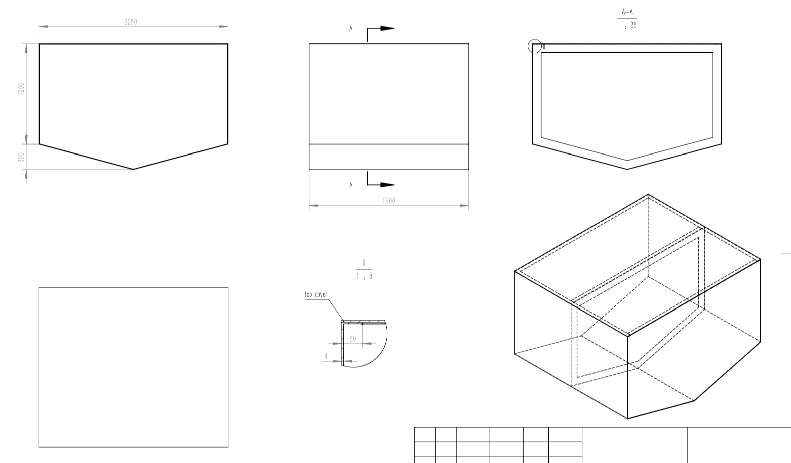

My fabricator has submitted the design below, using 4 mm aluminum.
2250 mm wide pontoons, with support baffles every 1900 mm.
Back of the envelope calculations tell me each unit can support 2,624 kg at a submerged depth of 1.5 meter.
We think we can use 12 meter long, 150x50 aluminum extrusions, 3 mm thick, spaced at 24 inch center, to create a platform 24m long by 12 m wide, with a 2.4 m overhang on both sides and a 2.4 m spacing between the pontoons.
This platform will be used in sheltered coastal waters, mild seas
Is the 4mm thick enough or would 5 be better?
Would 200 mm high extrusions be better/stronger than the 150mm?
I appreciate every comment.
Thank you.
