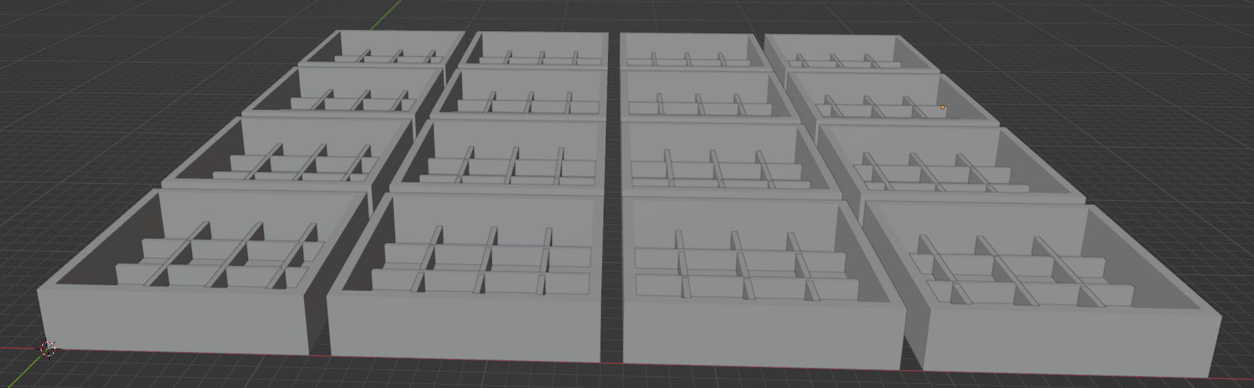

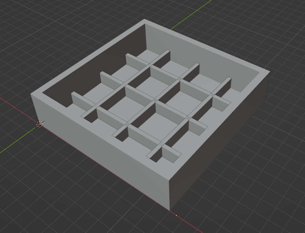

    Howdy everyone!
    I've been toying with the idea of creating a floating city. I'm aware of other projects of similar nature (like those affiliated with the Seasteading Project), but I think that my approach might be much easier and cheaper to both set up, and scale up.
    The idea is to create floating reinforced concrete boxes, each 12m x 12m x 3m (40ft x 40ft x 10ft), and connect them as a grid to allow long-term living.
    Here are some of the decisions (and hopes) I have:
    • I chose reinforced concrete as ideally that will not require dry-docking (at least for a few decades), and will require relatively low maintenance
    • When mass-produced, hopefully these can become rather cheap so that each single floater box can cost < $50k USD, obviously mostly affected by wall thickness and amount of reinforcement required
    • The internal grid (see attached images) is structural, but can also serve as ballast and rebalance center of mass based on weight distribution
    • The boxes will be connected to form a grid via 1m steel beams and the gap will be covered with removable metal sheets (again, 1m wide) to serve as roads / paths, while allowing maintenance and inspection
    • The boxes will serve as "land", allowing to build on top of them. If in the future there will be a need to support more weight (like for building multiple story buildings on top), we could create thicker, taller floater boxes to serve that, but that's not something to dwell into right now
    • Outer boxes will dual serve as wavebreakers, and the grid will quickly become larger than any wavelength (at least of the Mediterranean where it's supposed to be) to disable most movement
    I would love to hear from your experience how can I determine the thickness of the walls, and amount of steel reinforcements (I was hoping to use welded steel H-beams to maximize strength), and better design this.
    Please note that I am most aware of other non-trivial challenges (like mounting, towing such monstrousities, legal, etc). I believe that, while hard problems, they can be solved if the floater boxes themselves are viable.
    Any thoughts, ideas and improvements will be greatly appreciated! Thanks a bunch!

    Would these boxes be rigidly connected? If so, how would you deal with the bending moments?

    Initially I thought about rigid connections, but it's problematic both due to bending but also it could hide unequal weight distribution between the boxes, which may put too much stress on a single box. So my current plan is to have a semi rigid, spring-like connectors.

    Have you done even a rough initial weight estimate for one of these 12 metre x 12 metre concrete boxes?
    Where will you build them?
    I presume next to or very close to a waterway, as you won't be able to transport them on any road.
    And how will you launch them? Will you launch them first, and then build the structures on top?

    Hi Chaka, 40ft x 40ft x 10ft + some housing or construction on top is a big space in each unit. Each one could hold 8 or more small dwellings as 2 story floating buildings. You would have to make the below waterline basements inaccessible, or double walled, so home handypersons can't hammer drill into the sea water. If you gave each one a metre wide walkway, two butted together would have a 2 m wide foot path; or 1.5m wide walkways for 3m of small vehicle access between buildings, with a flexible gap needing safety covers. Supporting larger buildings with multiple floats will be heavy and expensive, and require constant inspection and maintenance.
    I wonder if hexagonal floats would nestle and jostle together with less stresses than square corners, if you were going to lay a mat of them for a permanent city. Easier to get around corners anyway.
    It would be better to have all residential boxes uniform for cost reduction, and design some other method of dissipating, and absorbing wave energy at the edges, which is then attached where needed.
    I can see hexagon shaped floats @ 5m or 6m a side, with a concrete dished bottom, 2 stories of accommodation, solar powered, with an azimuth pod, disconnecting and un-cleating from a residential arm, and motoring off down a channel between anchored residential arms like a slow heavy houseboat, to tie up and connect elsewhere for a change, not just locked in an endless matrix of floating 'land'.
