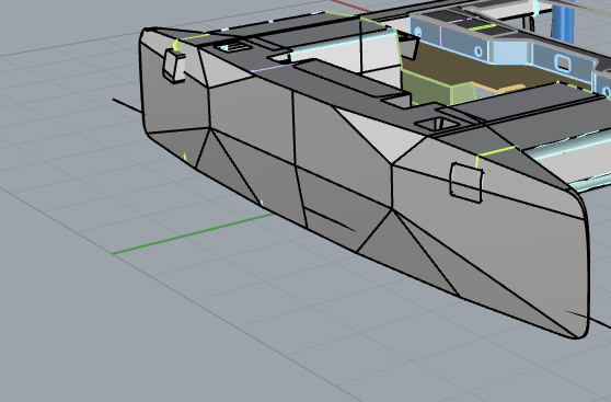

    Something like this could be good for an alu cat. Might substantially cut down on work required.

    All of Jim Brown's Searunner trimarans were built with compounded sheet ply. This was not difficult to do and added significant panel stiffness.

    Do you have an idea how much?

    Before you speculate further regarding strenght issues, I recommend that you study the dimensioning principles in modern scantling rules. There you will find that the panel camber (expressed as the curvature height/span) has a major influence on the strength of the structure. For example, in the ISO 12215 standard, the skin thickness has to be doubled when going from a camber value of 0,18 to zero, all else equal. Those rules are based on first principles of physics.

    Thank you for the reference. 124 pages of the normalized applied physics behind the ballpark figures, or, a convincing exhibit of why one needs an NA. Excellent.
