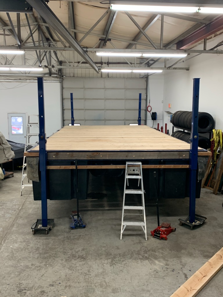

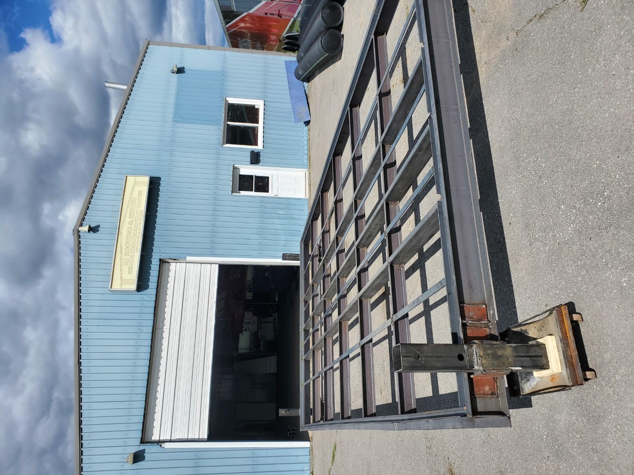

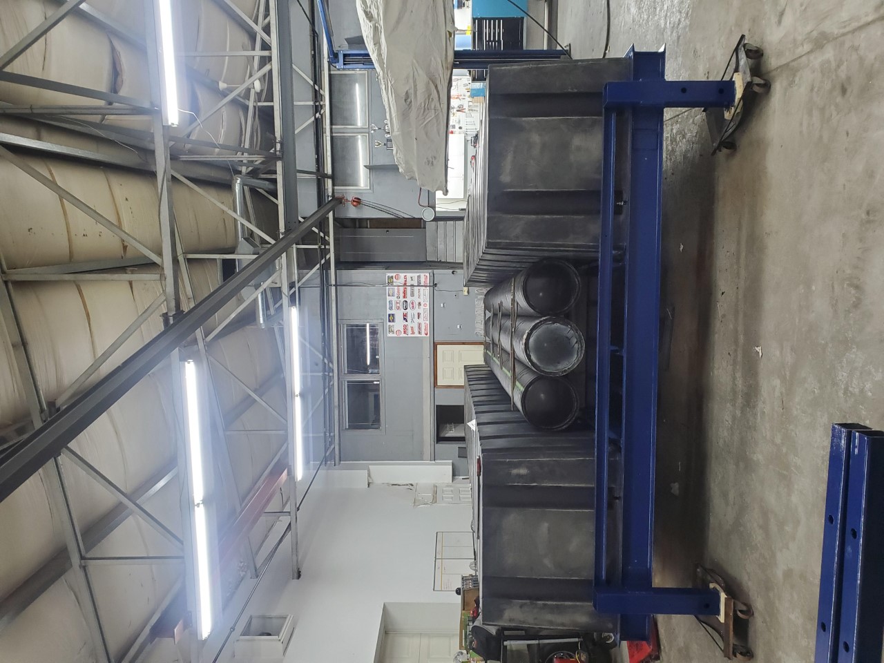

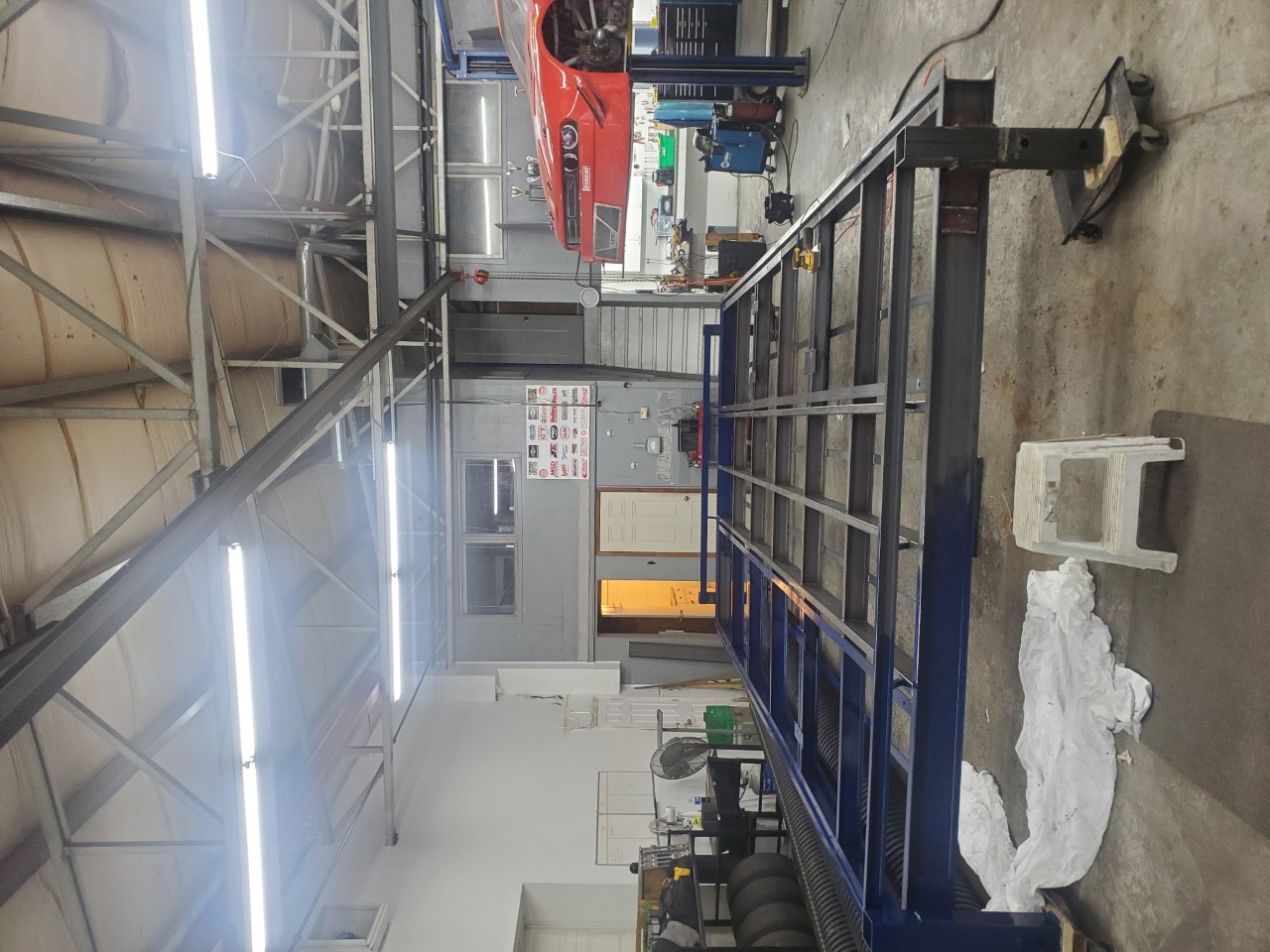

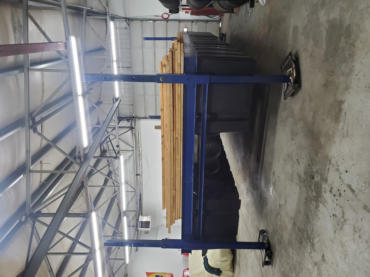

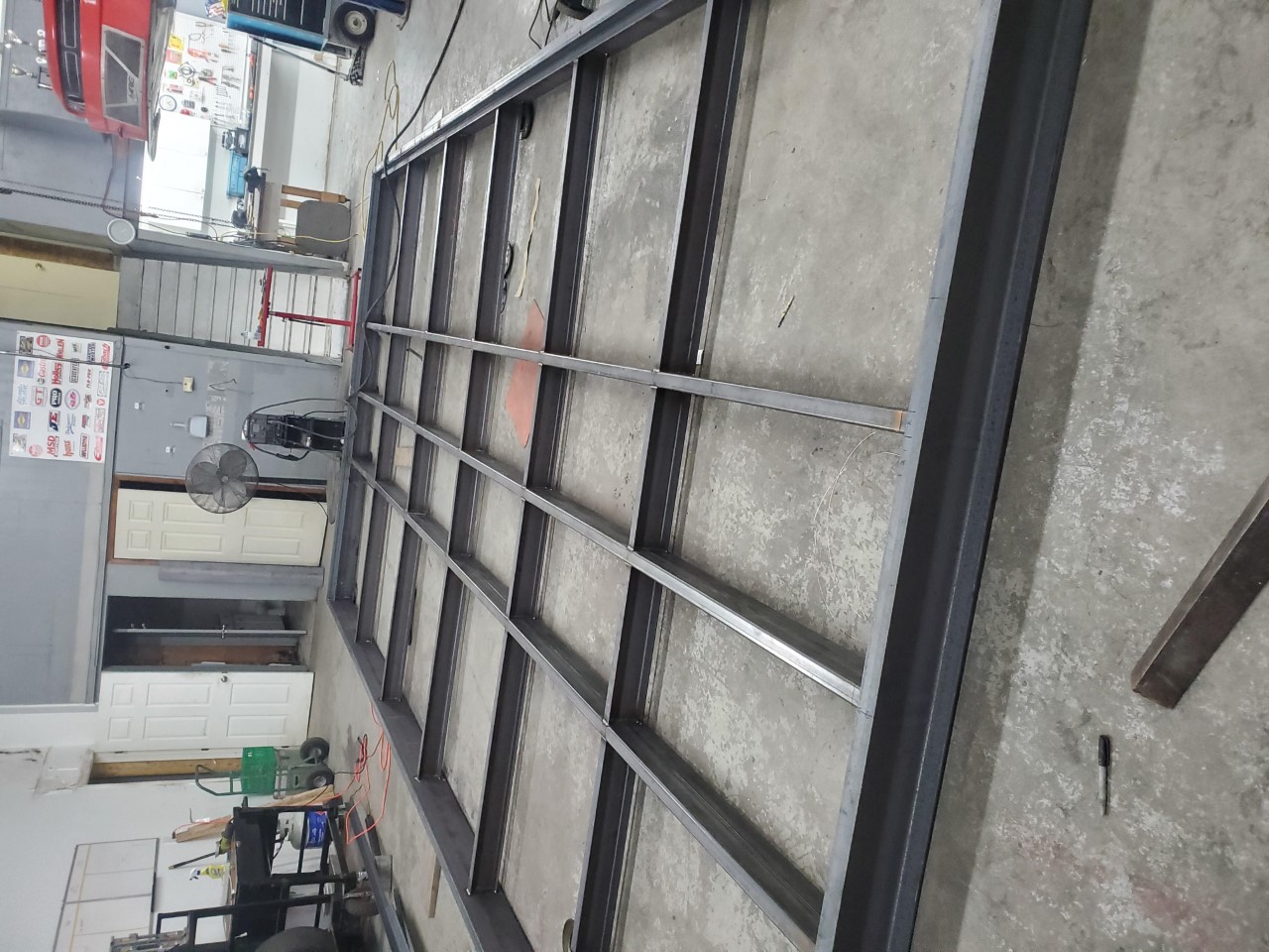

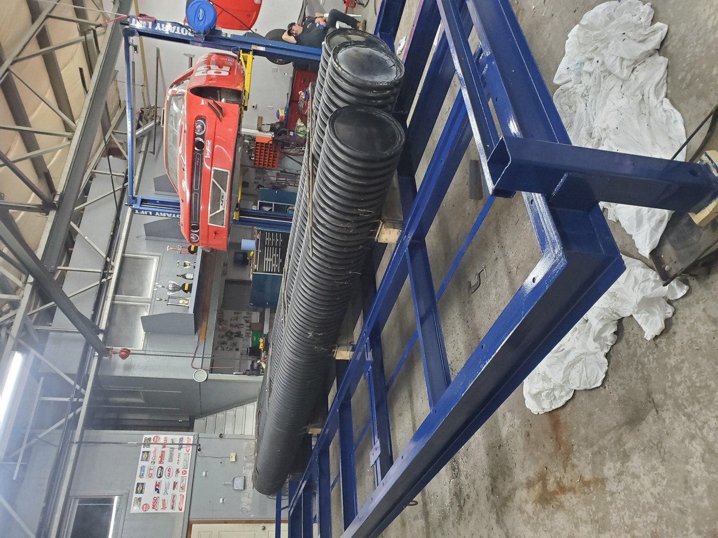

    Im back!.. and with a barge!.. Finally got 5 guys to agree on the design/build. Thought i would share some pics from start to finish. Just a bit of follow up.. we decided to go with a metal welded frame, with a 2 " thick hemlock wood deck. Our floats are a made in Canada premade poly float. from eagal floats.. was very impressed with these. We just bolted them to the underside of the 24' x 12'6" frame.. . 6 floats each support 5100 lbs..= 30600 lbs flotation. For good measure we also incorporated 3... 20 foot long 18 inch plastic welded culverts we came across which we calculated could support approx another 6000 lbs. The final unit weighed in at 7500 lbs.. ( a bit overkill on the build but better safe than sorry )..took us 5 weeks to complete, and we should be able to haul around 14000 lbs safely.

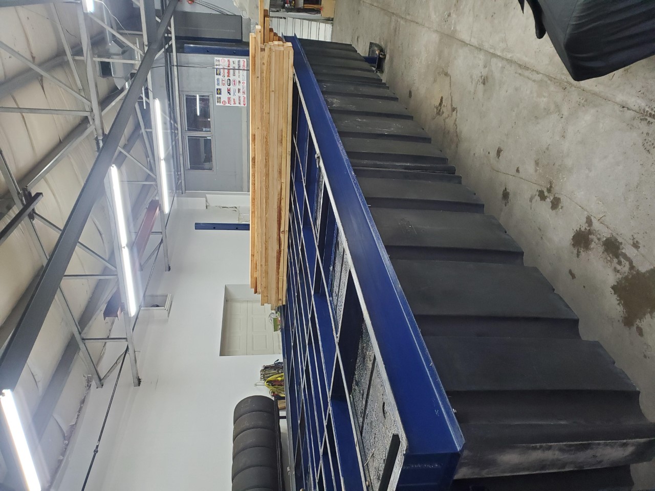

    more pics along the way

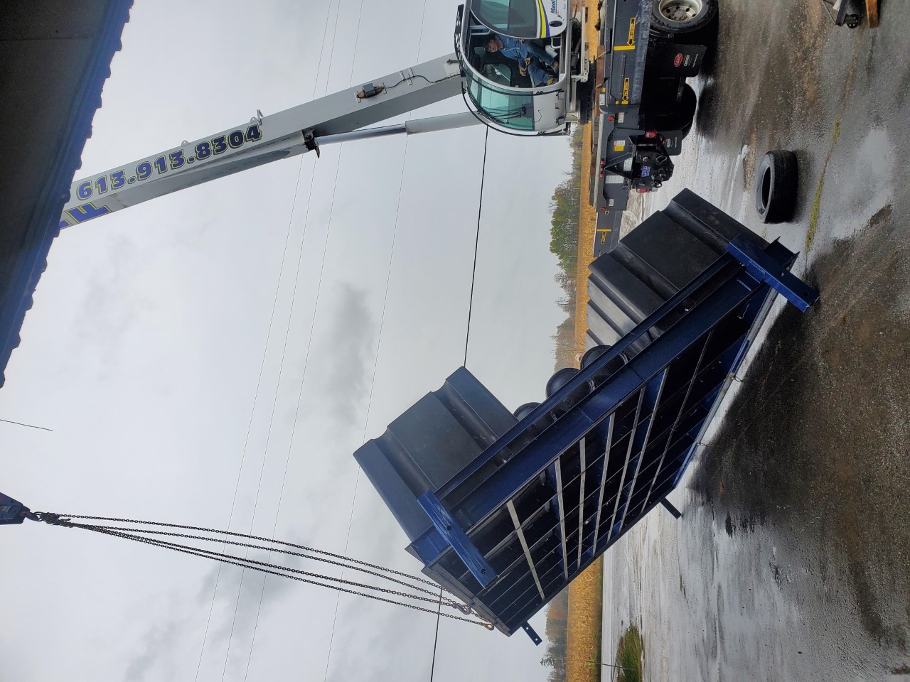

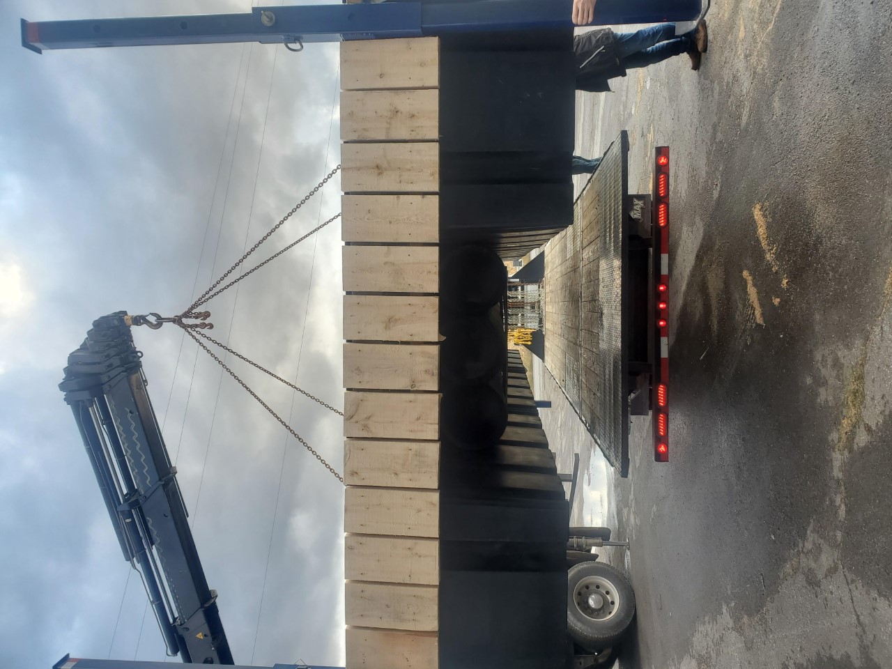

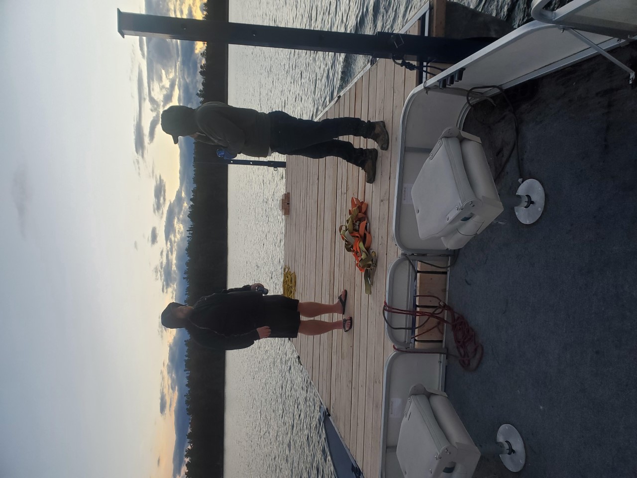

    the final push. Just wanted to give a special thank you to everyone who helped with constructive comments and suggestions along the way. It certainly helped us to get motivated to get this done.

    Many congrats Darren!
    The steelwork shown looks very impressive.
    And a good plan to go with the plastic floats, rather than building steel pontoons.
    Probably cheaper as well (?)
    In her 'lightship' condition with no cargo, as per your final photo (I am assuming that the two crew do not weigh very much), where is she floating (ie what is her draft)?
    Is it about halfway up the plastic floats, or maybe a quarter?
    I presume that the pipes lashed along the centre line are clear of the water when light?

    yes... our 3 pipes are about 3 inches above the waterline when running empty. Id say we are only down about 8-10 inches running empty. I find it pushes and steers great with my pontoon boat tied tight. Hoping to get our first heavy move before freeze up this fall. Still need to devise an easy way to pull up our spuds when we start dropping them to load the big stuff, but im sure we can figure it out. :0)
