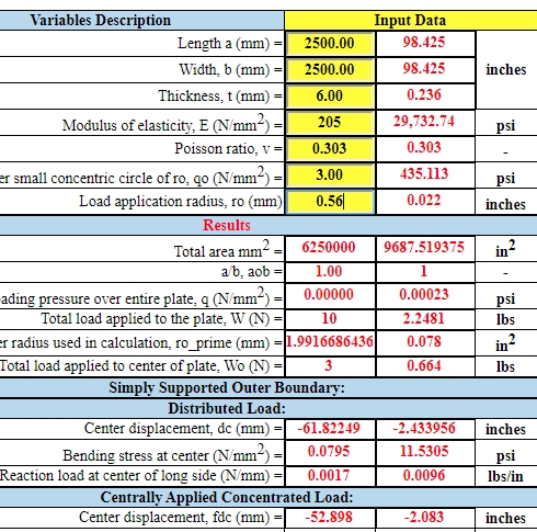

    Given comments in other threads that hull plating can be forced into almost any shape with enough force, I began to wonder what curvature in longitudinal AND vertical planes might be possible with moderate forces to enduce slight curvature in both directions into flat plate to avoid welding sections together and the associated uglyness.
    Assuming an elastic modulous of 210GPa,
    Flat Plate Deflection Calculator | Flat Plate Stress Calculator - Engineers Edge https://www.engineersedge.com/calculators/flat-plate-deflection.htm
    Using this calculator to apply a point load over 1mm sq (.56mm radius yeilds 1 mm area) of 1.5N - about the eqivalent of 2 Nautical Engineers applying their bodyweight with two fingers )
    The deflection is calculated at about 2 inches which equates to a radius of about 38m. This is adequate for the longitudinal plane.
    Since the plate will be significantly longer in the longitudinal direction along the hull, adjusting the length to say 5 or 6 m with the same two NAs hard at work applying a point load, the deflection is now 3in which equates to a radius of about 25m. My desired radius in the vertial plane is about half that which will take about 9N/mmSq or 1300 psi. Thats going to take some mechanical advantage like a come along.
    If the plate were rolled it would have to be cut into much smaller sections requiring welding and resulting uglyness, hence the exploration of using force to form the hull plating over the framework.
    Does anyone with HANDS ON experience of forming plate in this way have a comment abou these numbers?

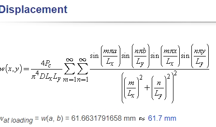

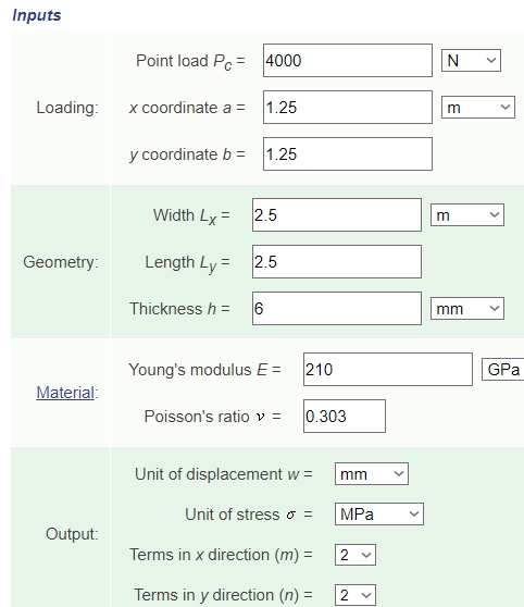

    Another calculator
    eFunda: Plate Calculator -- Simply supported rectangular plate with point load eFunda: Plate Calculator -- Simply supported rectangular plate with point load https://www.efunda.com/formulae/solid_mechanics/plates/calculators/SSSS_PPoint.cfm
    4000N point load is equivalent to hanging 100kg on each corner of a plate supported in the middle. Thats not excessive.[/QUOTE]

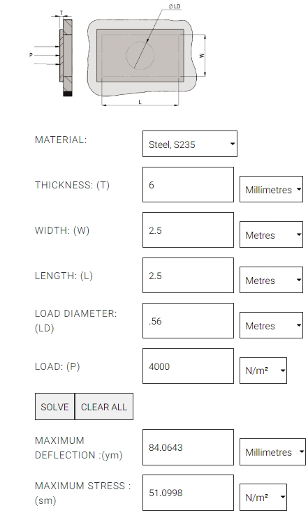

    This only has S235 which is a structural steel that is a little stiffer but still yields 84mm of delfection
