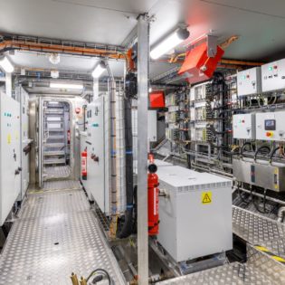

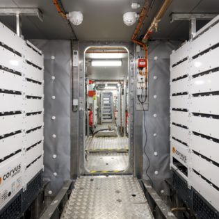

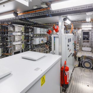

Beautiful enginroom of another -boat, a 22 meter, by Kewatec Finland.
