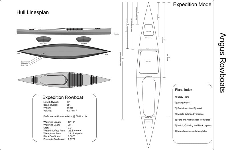

    Adirondack guideboat
    I have an Adirondack Guideboat built to these plans http://www.guillemot-kayaks.com/guillemot/catalog/boat_building_plans/adirondack_guide_boat_plans
    I found it handles waves surprisingly well with the narrow flat bottom enabling surfing and the sheer curve matching the wave, trailing the oars works as a rudder. It also takes waves from the side quite well, remaining upright unless the wave is breaking enough to get water aboard in which case it starts to tilt making it quite dry for the conditions.
    If you combined a hull like this with end and side tanks and a minimal cockpit you would have a boat which would drain when righted from a capsize and could be re-boarded. Similar to this design http://www.angusrowboats.com/expedition.html
    You can see it being righted in the video at http://www.angusrowboats.com/index.htm

    Couple things - 1.what's your maximum acceptable boat weight?
    2. I don't know how you rig a skirt to a single rower, much less two, the rowers body movement plus the relatively large cockpit would seem to require a large skirt that might hinder the recovery process - any examples of how this has been done?
    The expedition kayak/skiff is a very interesting hybrid - thanks for the link KJL38. Certainly a solution to my skirt skepticism...I love the stability of the relatively wide beam which would be very useful for fishing & comfort related movements. The cockpit might need a redesign for your use. Moe

    I have to agree with eric 818 as to weight - personally I'd aim for under 100lbs, be happy with 125lbs & saddened but accepting of 150 lbs. In my experience any beach launched craft, at some point, has to be lifted either entirely or mostly...I think any weight above 150lbs would be take 2 strong folks -the cart falls over, there's a log, short drop whatever. I can load 125lbs on a vehicle rack by lifting one end at a time - but I don't like to...So IF you want a beach launchable craft I'd get very focused on weight as a primary design goal.
    I have a Klepper double kayak with an open cockpit 101"x16.5" (2565mmx419mm) it has a spray cover & it works OK for rain & spray - it's a pain to rig, was expensive and given the Kleppers high gunnels uncomfortable. The limiting factor with a big spray cover is it has to come off quickly in an emergency - so for it to stay attached to the coaming with a lot of heavy water pushing against a large surface area the required strength of the attachment would pose a release hazard in an emergency. Not saying there isn't a spray cover solution but I'd approach it with two small cockpits as close to classic kayak size as possible and I'd spend a lot of time thinking about complete/partial self draining cockpits before I'd go that route! Incidentally the Klepper weighs 79 lbs (35.8kg) and while not a pleasure to handle solo with a cart is OK -
    Here's some interesting solutions to your goals - the first two take one path & the Ian Oughtred designs quite another...
    I'd suggest the first two are more kayak based in their low weight, rowing position, portability, wetness and related to wetness - recover-ability. They would tend to go through wave tops and thought has been given to deal with water in the cockpit as well as capsize recovery. They are particularly helpful with regards to their respective cockpit design.
    The Oughtred designs are heavier, much dryer, much more carrying capacity & are a traditional approach to small surfboats. I think a capsize would be very difficult to recover from unless it was laid out like rescue surfboats with turtle backs at both ends & a small draining cockpit. They could be built considerably lighter than his weights of 140 lbs (72kg) to 180lba (82kg) although any self-righting structures would add weight so I'm not sure how light you could go...They would be great to sail however & way more comfortable.Moe
    KJL38 sourced this Angus Expedition Rowboat-
    http://www.angusrowboats.com/images/expeditionPlans.html
