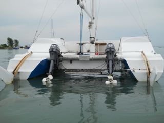

    Not much clearance, but it does seem to be trimming low at the stern in the other pix.

    That might be the problem. A 9,9 Yamaha weighs in the lightest version 93lb (42kg), the high thrust 104lb (47kg) without fuel. Two of them at the stern with fuel is a lot and a bad trim.
    http://www.boats.net/outboard_motor/Yamaha/9.9HP/parts.html
    http://www.teamscarab.com.au/7.3cat/design.html
    Length Overall................. 7.3m (24' 0")
    Beam Overall................... 4.6m (15' 0")
    Width on trailer............... 2.5 (8' 0")
    Draft.............................. 375 mm - 1250mm (1'3" - 4' 0") pivoting boards
    Displacement to DWL........1600kg (3520#)
    Weight.............................(approx) 950kg (2090#)
    Main Sail........................ 22 sq m (240 sq ft)
    Jib........................... 8 sq m (86 sq ft)
    Mast height...............9.65m (31' 8 ")
    Construction.............6mm plywood

    The photo certainly appears to suggest that the cat is overloaded and possibly not built to plan. The floor of the demountable cockpit as designed is just below (25mm) the bottom of the beam. The design specifies one 9 to 10 hp outboard mounted at the centre of the beam.
    Regards
    Ray Kendrick

    The design has been butchered, probably why its for sale, there shouldn't be anything below the rear beam let alone a huge boxy cockpit, maybe it was built by a mono sailor ?
    Still, nothing a chainsaw wouldn't fix :D

    I don't think an extra 9.9 O/B's weight is of any significance. Not a chance !

    Think about it. 2x9.9's + 20 litres of fuel is probably 20-25% of the payload. Right on the back. Choice. Take them both off and i'd bet it floats level.
    A single 5-8hp LS 2 stroke would be ample for a boat that size and mounted further forward on a GBE style centre pod would be even better. It must be frustrating being a designer and seeing people f**k your boats up like that.

    Any 23 foot boat that is unbalanced by a 9.9 hp outboard is a ***** ** *** to start with.

    Get real dude: most small multis are weight and trim sensitive. Doesn't make them heaps of ****, even if the less discerning might struggle with the concept ...........

    Give me the figure for the difference in trim by adding 50 kg ( less than 3% of the hull weight) to the stern. In this case it is actually forward of the stern. If that is enough to bugger things up, then what can I say ! The rear view shows the hulls are not that slender.

    I installed a single (steerable) 9.9 Yamaha 4 stroke OB on the first Louisiane 37 footer I imported to the USA. It pushed that boat a 7 knots in flat water, and was very maneuverable in close quarters once you got use to it. (steerable engine/prop is key word/concept)
    No need for twin OB's on that 24' design.

    I’m building one of these, you can clearly see the box below the rear beam. The sterns sit a little lower than designed but as already mentioned this has a lot more weight on the stern than it should, you also wonder how much weight is in the box design...

    Could simply be a dead battery (no pumps) and rain water.
