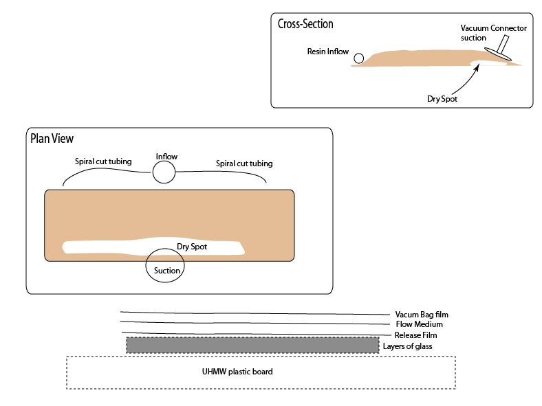

    My first attempt at vacuum bagging several layers of fiberglass had a small dry spot. This job was resin infusion.
    What did I do wrong? I couldn't see the dry spot until after all was finished, I took everything apart and flipped the panel upside down. It was not visible during layup.
    Do I need to put some kind of flow medium between the layup table (UHMW board) and the layers of fiberglass?
    Maybe I had too much vacuum and the dry area got pinched off by the pressure?
    I ended up with a dry spot near the suction port. Here is a rough diagram of the issue (attached picture)
    I slowly let the resin flow thorough to the vacuum bag connector and it was starting to suck up into the tube (and into the resin can)
    Dimension of laid-up fiberglass panel is about 6" x 18" and the 12 layers ended up being about 3/8" thick.
    I layered 1708, mat, 10 oz cloth, mat, 1708, mat, 10 oz cloth, etc... for about 12 or 15 layers
    I also had a bunch of tiny air leaks. I expected the leaks because i didn't have any butyl tape and used clear packing tape. That was a mistake.
    Even with the leaks, the vacuum pump kept up, vacuum ranged from 21" to 25" (that is the swing of my vacuum valve the cycles the pump.
    When flowing resin into dry material, what vacuum value should be used? 10", 15", 25"?

    Vacuum should be 30" for expoxy, you can't have leaks though that will mess you up in so many ways. Not only will you end up with dry spots but when you clamp the resin line, the resin inside the part will continue to be pulled out. It helps to shoot pics every few minutes of resin flow, it could be the resin found an alternate faster route (racehorse) to the suction in which case that part in the middle got cut off. Had you had perfect vacuum, the chances of the dry spot would have been reduced greatly. Also I am a fan of infusing inward in which case the resin line would have circled the part and your vacuum would have been in the center. Leave a flow media break before the outlet point to slow the resin down, 2 inches by 2 inches is enough.

    Thank your for the help. I will try the running the inlet around the perimeter with suction in center.

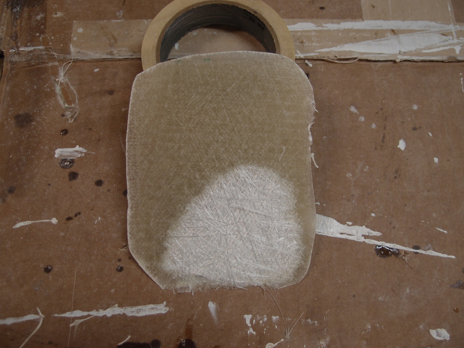

    Yeah, a hole in the middle. I think that's it because it just seems like resin just can't get to it. I hope so, this doesn't seem that complicated. I just have to figure it out.
    When I tested without core (before core testing), just 3 layers of 1708, there were no dry spots.
    Here are the pictures of the three fails, one of which (lower left) is the one with perimeter inflow tube.
    The top has a hole (nail hole, scrap wood) and resin did get to it.
    These pieces are just tests with scrap 1/4" plywood. The shelves and bulkheads will have 3/8" to 1/2" balsa core. ONce I get those, I'll test to see if the balsa needs holes.
    Here is a link to higher res pictures
    Vacuum Bag - LA Gallery http://bodylens.com/Gallery/thumbnails.php?album=37
    I'll drill a few holes and see how that goes.

    If you want to infuse in a mold and have one finished side, get perfed or cut core so you can flow the resin across the top face and it will seep over to the mold side... Otherwise, in-or-out infusing is going to fail on the side against the mold. Leaks can not be tolerated and on bigger parts let the vac pump run a few hours to flash off any humidity in the glass.

    if plywood is the core it needs to be sealed first before you infuse,perforated plywood wont work well the holes will absorb too much.flow media needs to be used and maybe your resin is kicking to fast.
    A pic of the set up before you infuse will help.

    On small parts like these you need to slow down the flow, you don't want it to flow from the feed line to the vacuum line in 30 seconds, this shuts off the resin flow to the locations you see that are dry.
    1. what resin are you using?
    2. you can use products like Rovicore as part of the laminate to aid the flow.
    3. don't use the current flow media on top of the stack, skip it on small parts.
    4. the resin should flow across the mold evenly, and slow enough so that it doesn't just bridge across the top and shut down the flow.
    5. on parts this size you should put the feed line on one side and the vacuum on the other side.
