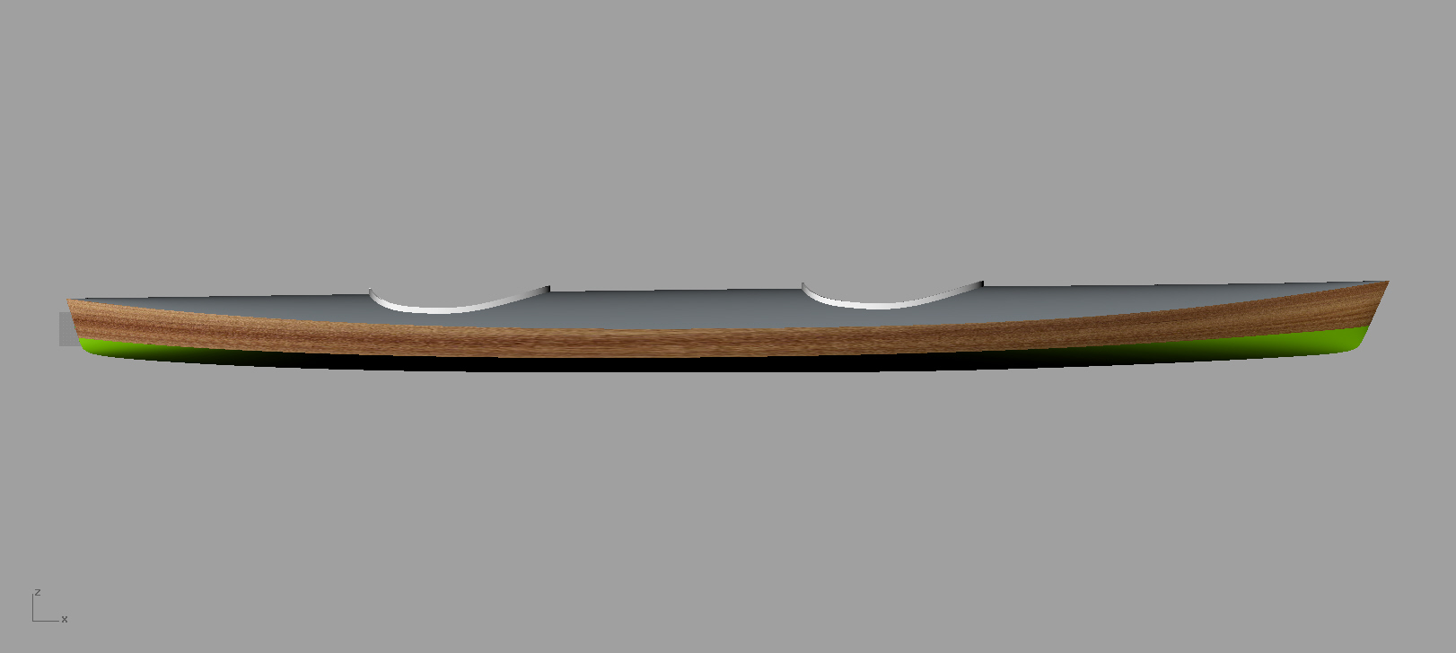

    I am planning to build a 18.5 feet double kayak with fiberglass. The breadth is 27 inches and the depth is 14 inches.
    Will it be strong enough if I use 3 layers (– 1 mat – 1 net – 1 mat) in the skin surfaces and 3 bulkheads as the only stiffeners ( the 3 bulkhead adjacent to the 2 cockpits) and without any extra longitudinal or transverse stiffeners?
    I have attached a photo from my 3d model in Rhino.

    From your drawing, it appears that the rear seat is quite near the stern. I would go to some of the larger kayak manufacturers' web sites an look at the profile from the top.
    Normally the rear of the kayak is narrower than the front, much like a fish, to get better pressure recovery in the aft half. This then lowers the amount of buoyancy that you will achieve say on the basis of the buoyancy per lineal foot.
    To me it appears that the stern cockpit is too far back unless the back is extremely wide which is not the best profile for efficiency
    I would build a keel that is perhaps 2 inch deep by 3/4 inch horizontal. This looks like an ocean cruising kayak and you will not need quick turning response. Alternatively, a rudder helps in pointing into a wind.

    Your design is wrong. The seating will make the stern drag.
    See the attached positions for a proven double design

    The aft cockpit is not as backward as it seems in the perspective view, here is the profile view. The aft portion of the hull is fuller so there will be severe trim by stern.

    The aft section should not be "fuller" in the rear if you are trying to optimize efficiency. Efficiency for this note would be the least amount of effort to propel the boat to say 4-5 knots
    You can be "fuller" in the front, and a slimmer less full taper in the back permits more pressure recovery from the energy that you have already "spent" that created a higher pressure area in the front portion of the kayak.
    Examples in nature, fish
    Examples, man made, 747's, all other airplanes, submarines, sailboats etc and most other items that are trying to reduce drag
    "fuller" in the aft section is not the most efficient profile
    A symmetrical profile would probably be the best and the cockpits situated to accommodate the weight that the seats will be carrying
    Ie if you are 100 kg's and your normal paddling partner is 50 kgs, then the location of the cockpits should be placed so the kayak runs flat
    It is an easy task to look at some of the well designed kayaks on the internet, print the picture, scale the position of the rear cockpit and move your position ahead.

    The more efficient designs have a fine entry and relatively full aft sections. From the profile alone, it is not possible to tell the volume of the sections. You should at least post a plan view. Normally, the rear person is seated more forward than what you show.
