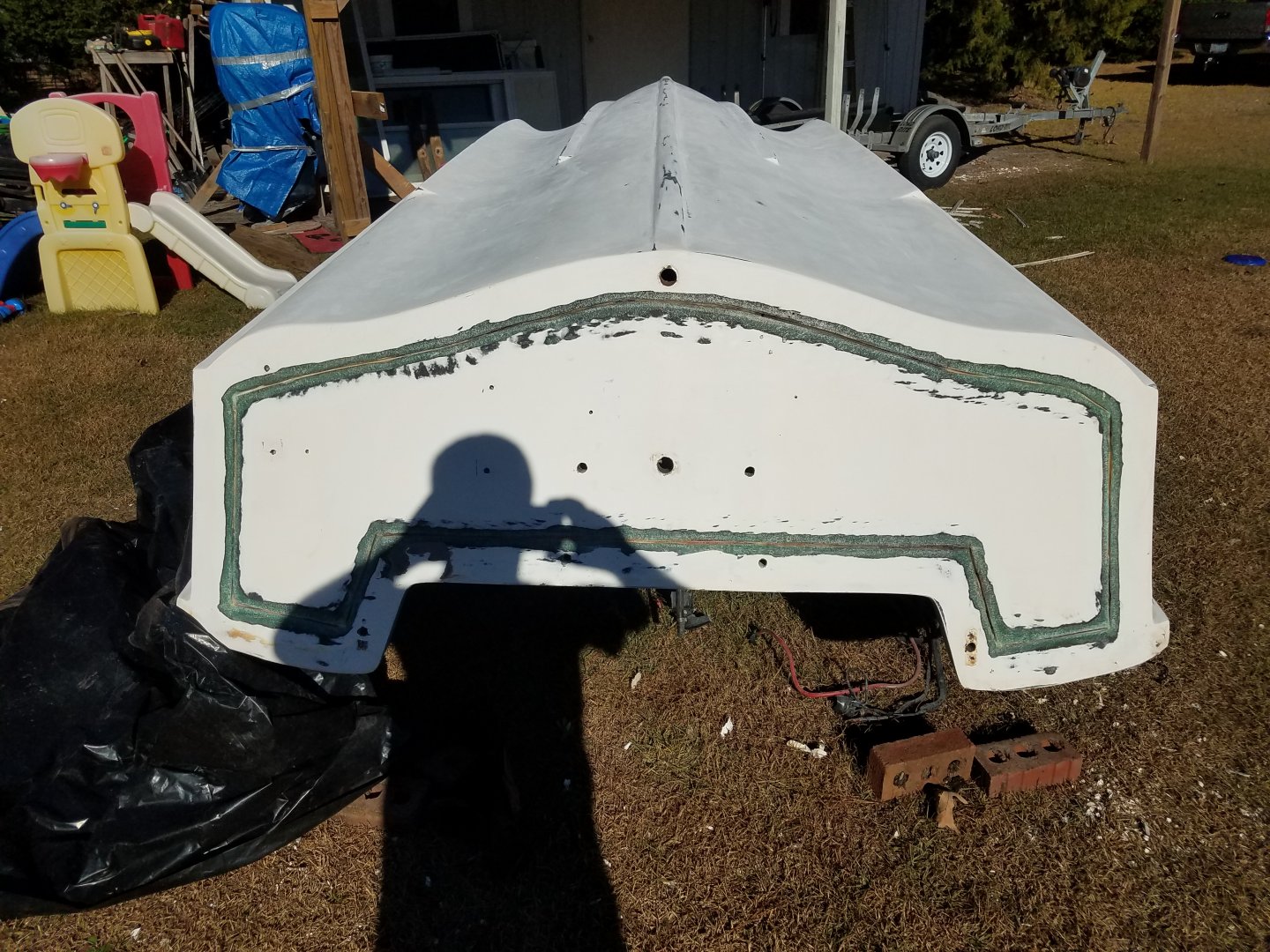

    One thing to point out is this water tank is in my keel - attaching a quick picture of what the plan sorta looks like - circles drawn on my little glass pieces are where fittings might go. I'm working aft forward as I close it off. Stopped to figure this out. I have perfect access under the top of the tank until I start moving along and close it off - then the only access will be in the front to allow spraying or scrubbing the inside out.
    Hopefully this somehow makes a little sense.

    Although worth mentioning - that grey stuff in the picture, which the inside of the keel is well coated with as I move along, is VE barrier coat (or thick VE gelcoat whichever way you look at it).
