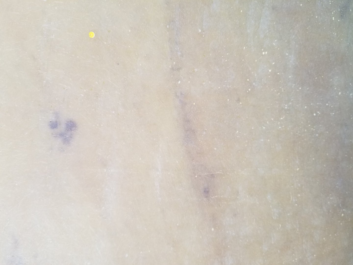

    I would think the lighter colored glass was best, the darker makes me think of water or wetness or high "humidity". It's probably ok either way.
    OP, take some close up pictures with strong light coming from the side that will create shadows and show how big of gouges you carved into the boat, or how uneven the surface is.
    In the center photo, the checkerboard pattern faintly visible is woven roving and you don't want to grind into that, that stuff is structural. The outside is yellow, the next layer is mat, a non-directional layer that is needed (smoothness and waterproofing) but not too much structurally, and then is woven roving. You probably haven't wrecked anything, but you'll have some repairs and then some body work, finishing to a smooth surface kind of work. More photos are needed.

    This sounds like it has been an unfortunate exercise of the OP making work for himself, that was not necessary. Especially as it was (apparently) above the waterline, and not much more than a cosmetic gel coat gouge, that could easily have been repaired with no grinding. Now it has become a lot of work. Sorry mate, but you should have come here with a picture of the original damage, and asked how to proceed. Assuming there isn't any structural damage that is visible, and you have not gouged too deeply with your grinder, and the laminate isn't wafer-thin, I would screed over the whole exposed area with a filled polyester resin (talc will do as the filler), then sand it down using a long board. Then proceed to paint the area with a one-pack system that you can get a good colour match with, for the final coat. A sandable undercoat will give a more respectable finish. If the damage and your gouging is basically above waterline, it is not that critical what you do with it.

    I didn't want to alarm you earlier, I wanted to confirm my suspicions before bringing it up. SamSam associates darkness with water absorption. I associate paleness with delamination. I could not detect any of the other tell tale signs because of the low resulution on my screen. I hope I'm wrong but I think the constellation I asked for detailed photo of will indicate separation between the CSM and roving.

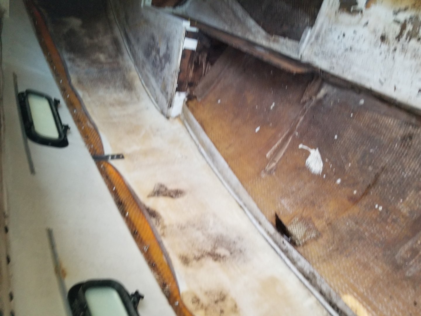

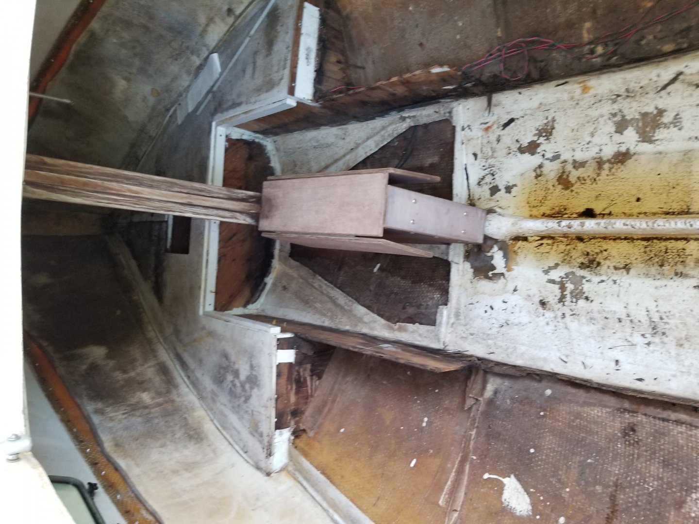

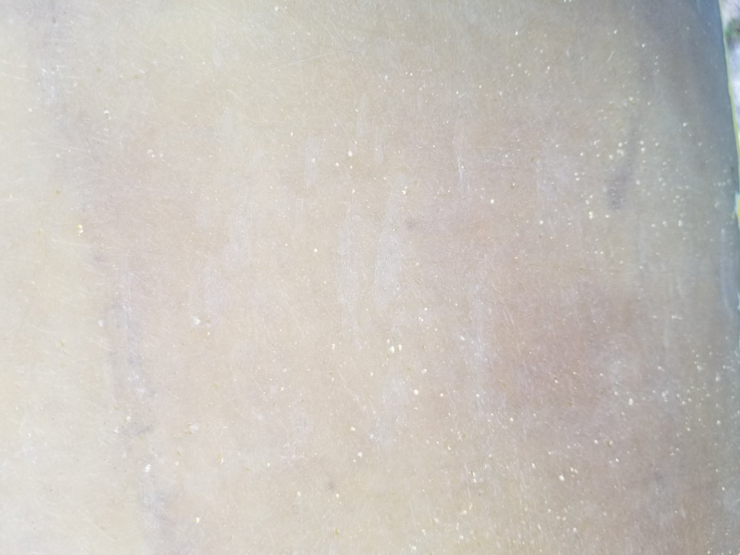

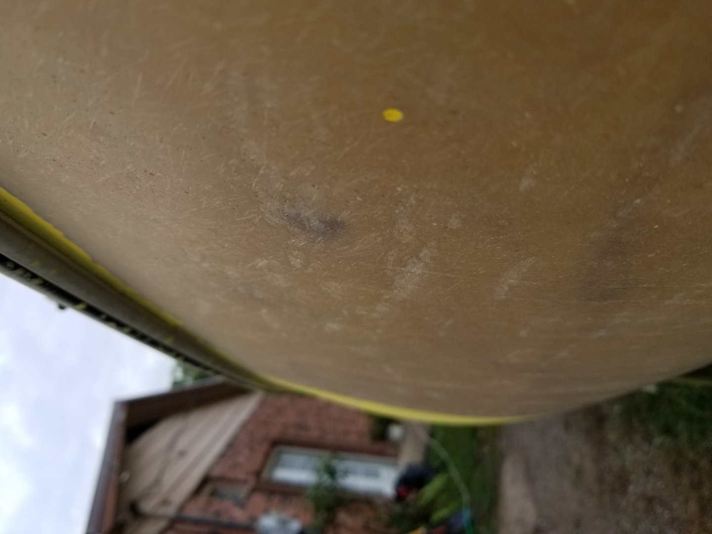

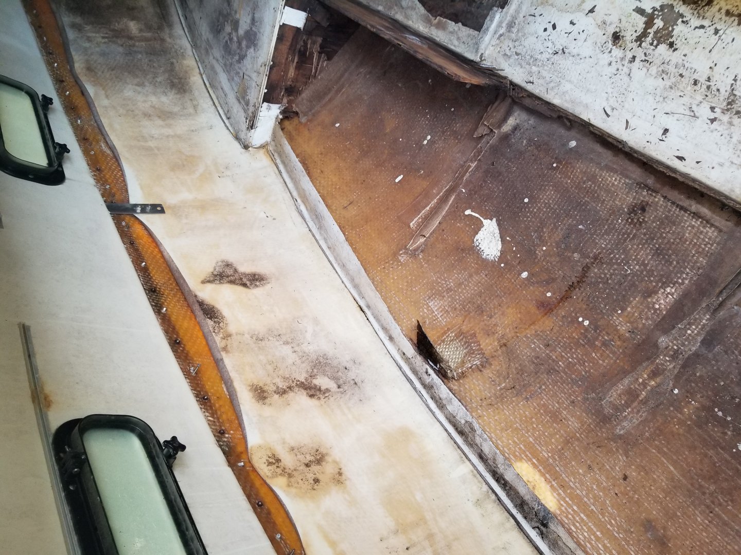

    These are more photos of the area. I realise now that I made more work for myself, but it will be a learning and growing experience. I need to learn how to fix things like this anyway. There is a lot of water damage on the inside of the boat. It has been completely gutted. I'm sure there is damage in there somewhere. As I said I'm using this boat to learn. By the way. The previous owner gutted it.

    Good news. The close ups clearly show no delamination.
    Bad news. That is a major project boat!!!
    You said you got it at a great deal. So the previous owner gave you thousands to finish his problem project.

    One thing noticed repeatedly, with these fibreglass restoration boats, is that the interiors are stripped out, usually with no thought of having the boat nestling in a suitable cradle, to retain the original shape. Which admittedly, in some cases, has already been lost through disintegrated stringers etc, and sitting on trailers that lacked a good spread of support. I saw a very thorough resto of a "classic" glass runabout, which cost a bomb to do, and included "blueprinting" of the hull lines, which would presumably require detailed design drawings of the hull. Slap-up jobs where everything is dug out without regard to what is going to go out of shape, can easily lead to twisted, warped, bowed, sagged, and generally unfair hulls, which is a disappointing end to a lot of hard work, and money spent.

    First fair and color coat port hip. As stated earlier, the CSM you ground is non-structural. Fairing compound will prevent the roving texture from printing thru to surface and provide adequate dock rash abrasion protection to the structural roving. You could add CSM back in at great increase of work for minimal if any advantage.
    2nd. Obtaine line plans as originally built. You don't have to go back to original interior, but should try to keep original exterior shape. Some of the original interior furniture is structural and you must reincoperate into your new interior furnishings.
    3rd . Return proper external shape and fully support. You will almost certainly need to add to trailer's bunk system.
    4th .DO NOT remove any more interior support until new piece is ready to install. The remnants are providing some support and hold clues as to location and dementions. I leave one side of old tabbing until things are tabbed on the other. Then grind away and tab in second side
