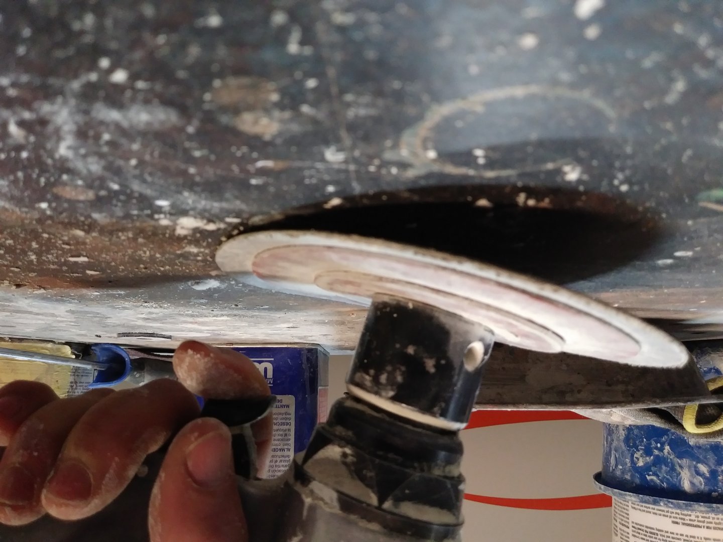

    When I use flapper disks I often get ridges as you describe. They are caused by the too stiff backing plate. I prefer grinding with soft plates. This is pneumatic but still works on electric. See how it flexes to almost conform to surface. Leaves far fewer ridges.
    How much glass thickness did you remove?

    @Blueknarr I believe I only removed maybe a millimeter below the paint, not much. The gash wasn't very deep, but it was long and slightly into the glass. Thank you for your reply... the most informative and actually addressed my the most by far.

    As the outside corner of the flappy disk is worn down it well behave better. Grinding on concrete can speed the process. Time working with the tool will teach you how to finesse things. No way to speed up that process.
    80 grit probably didn't cause too great ripples to have too worry about. Sanding with less aggressive tool won't hurt.
