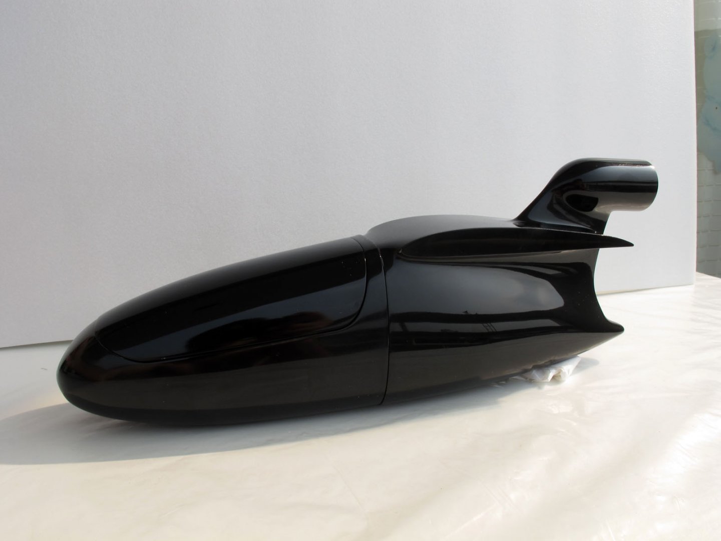

    I have experience with composites, I've designed and built a few composite model airplanes, mold, foam, vacuum bagging, all that sort of fun so I'm OK in the making things department, same same just bigger, I hope.

    I'm not too concerned about complex shapes, I've done much more complicated plugs for model airplanes were I had to be precise to less than a millimeter, this would be bigger but I expect easier in that regard. On top of that one of my lines of work involves 3D scanning so I can use that to check the shape quite precisely if I need to.
