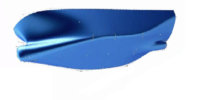

    Thank you. I have done everything I can to try to obtain lines for this hull. They just are not out there to copy.
    I have even talked with a modeler that repaired a display model of one of the later Titans, which was damaged in shipping for a presentation.
    The sinusoidal curves are both vertical and from bow to stern.

    If you send me the information you have, I can study it to try to draw a body lines plan. Once that is achieved, I will also be able to perform naval architecture calculations, hydrostatics, cross-curves of stability, ...

    This is what I have at the moment.
    I need information to generate bulbous bow and bulge.
    Also let me know LOA, max breadth, depth to main deck and full load draft.
    Please, use this path to exchange information as it seems impossible to do so through email. RamForm.jpg

    Here you have something that looks quite like your boat. Not exactly what you wanted but I think, from there, a good renderer can do wonders. Tell me in which format and by what procedure I send you the CAD plan Snap23.jpg

    Thank you so very much. It looks a lot like the concept yachts for the Ramform Hull.
    dxf would probably be the most universally adaptable.
