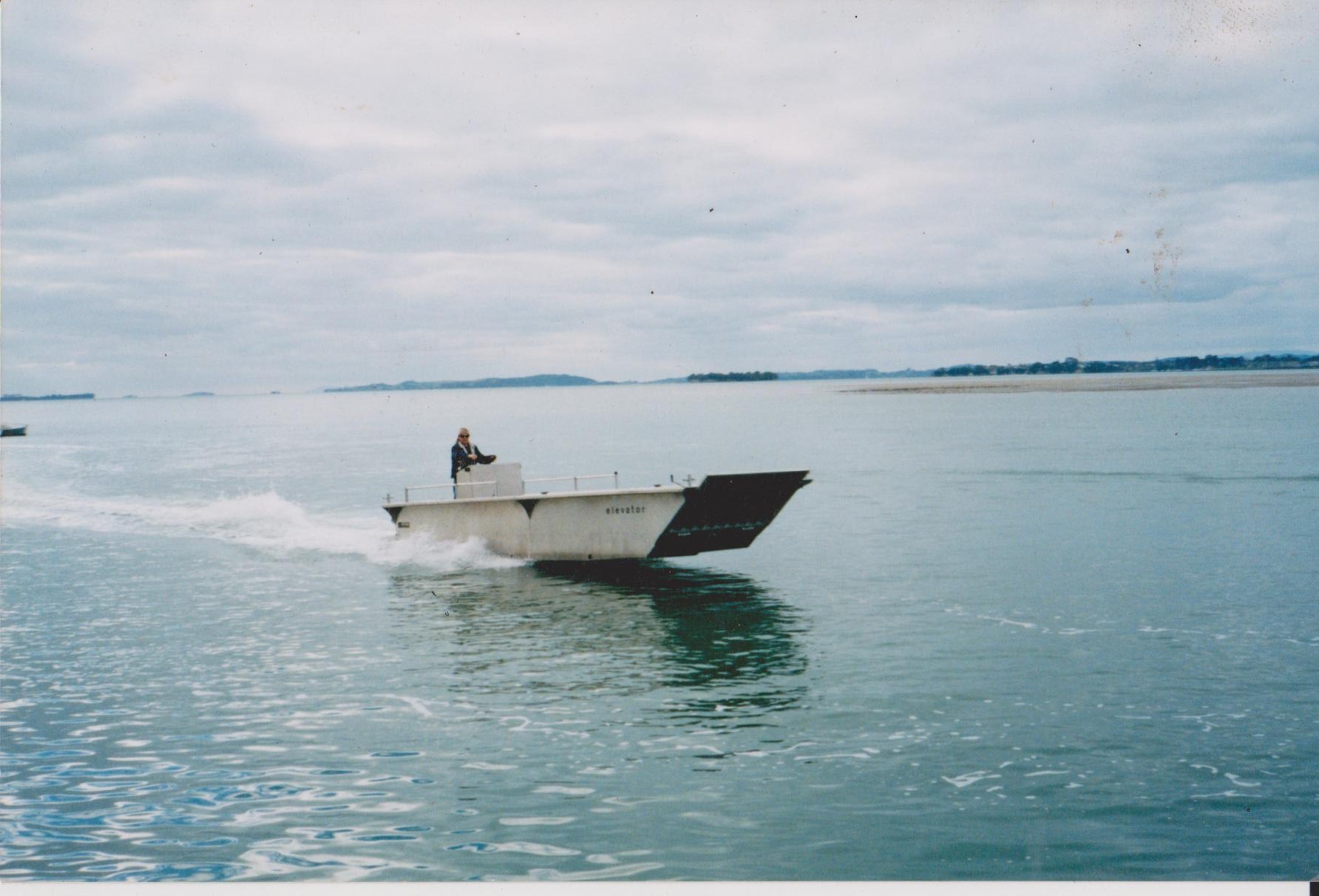

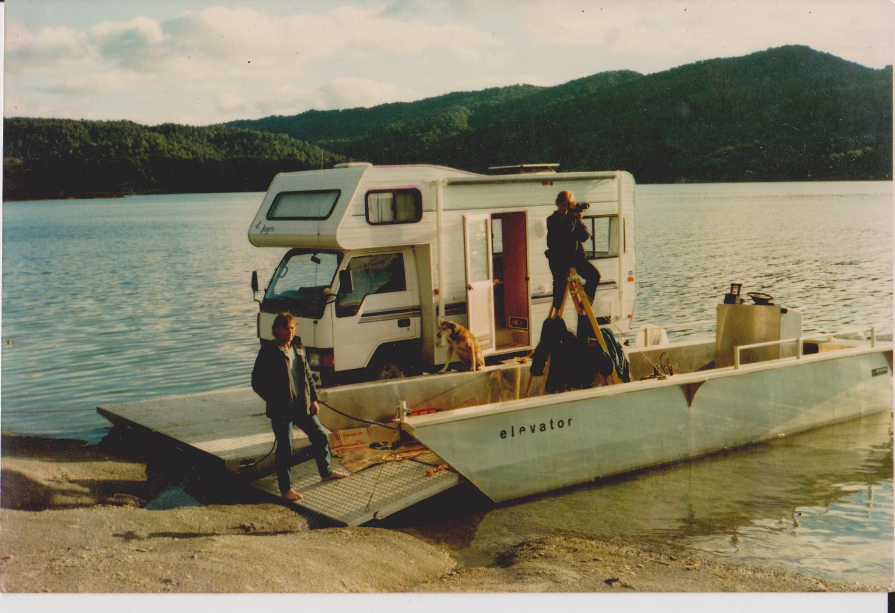

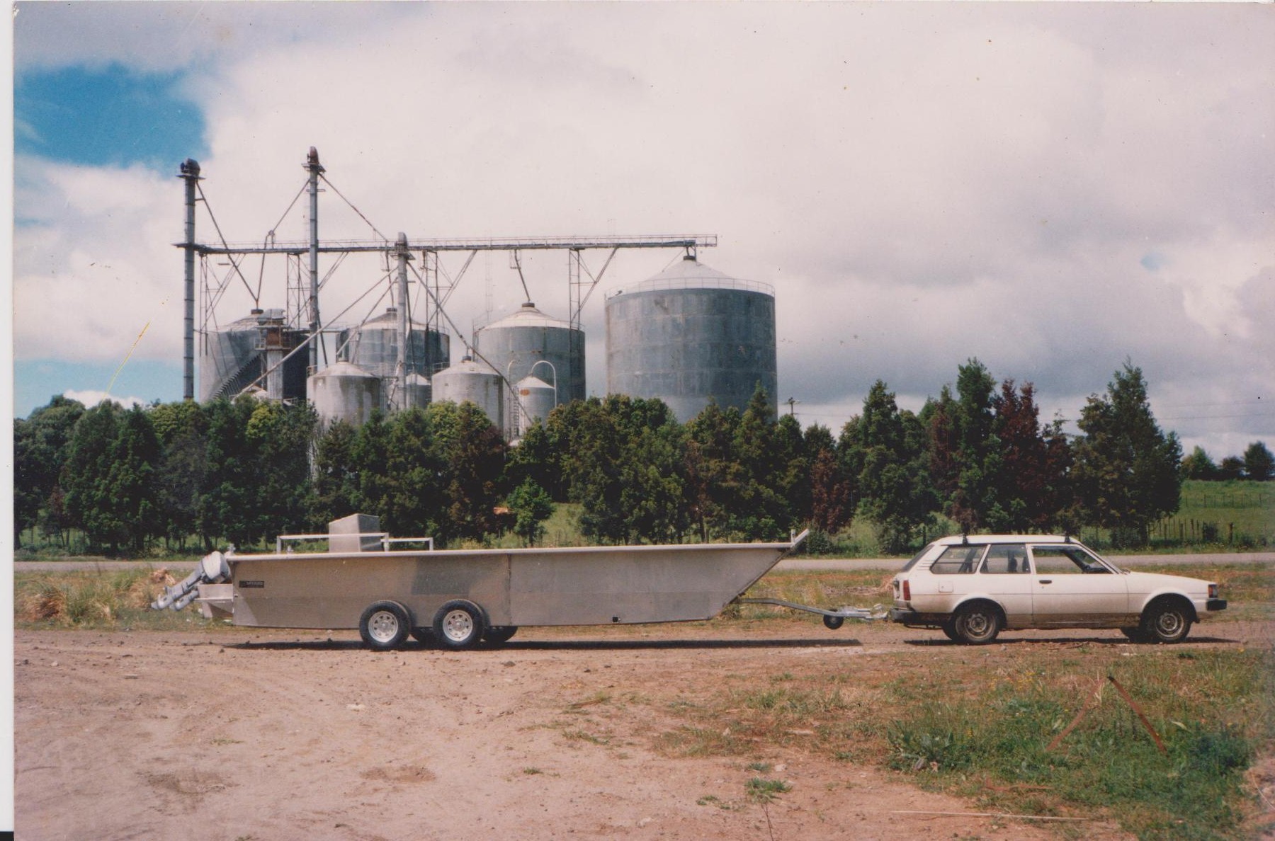

    Flat bottom boats have an advantage with draught meaning less drag in the water for example the Myark 8.5 m self trailer barge has a slight kick ups in the front and back ends which when accelerates, it rocks the front up and because it floats in two inches of water it immediately gets up and plans.
    The picture shows two 25hp out boards which work well and can compete with smaller V hulls that have larger outboard motors.
    Better on gas, more people aboard and stable plus you can place your car on top if wanted and most of all land in shallow water, plus the plug in torsions suspension and wheels allows beach landings.
