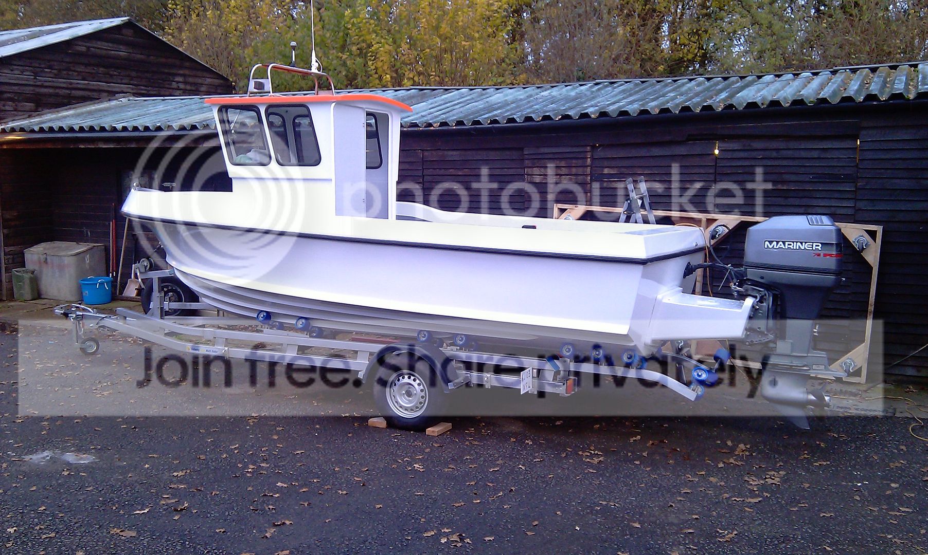

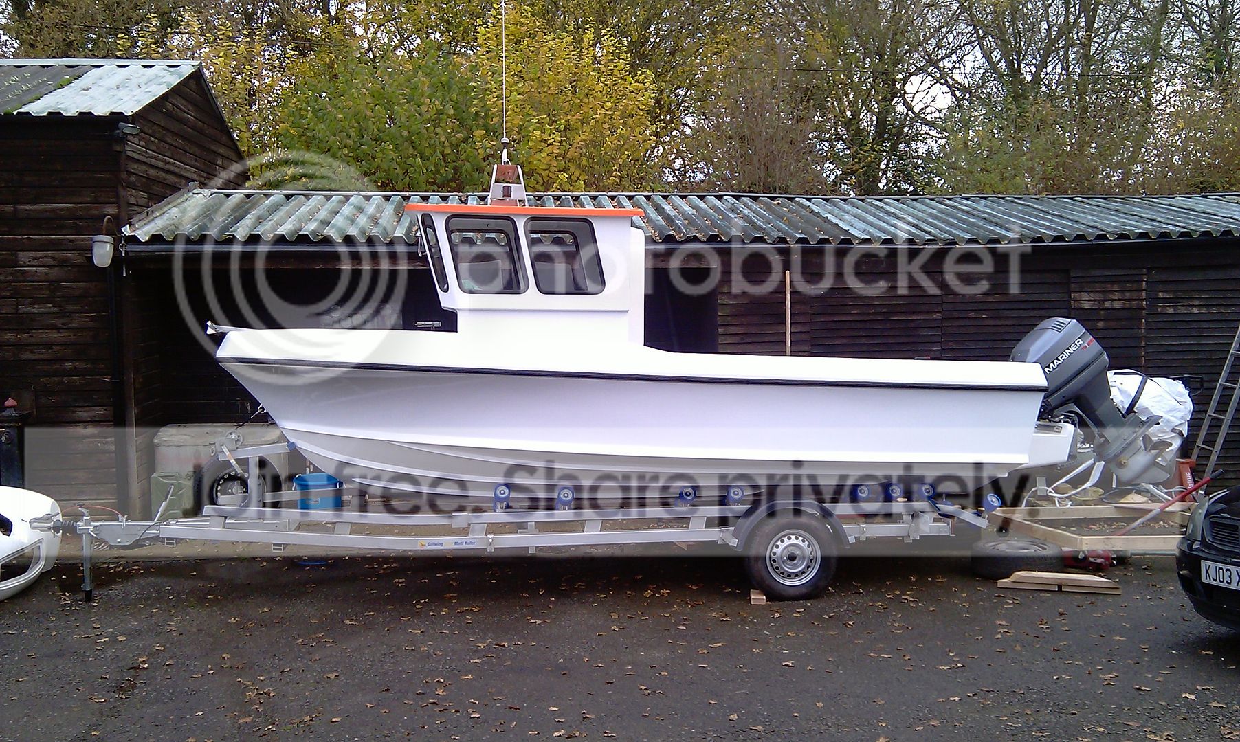

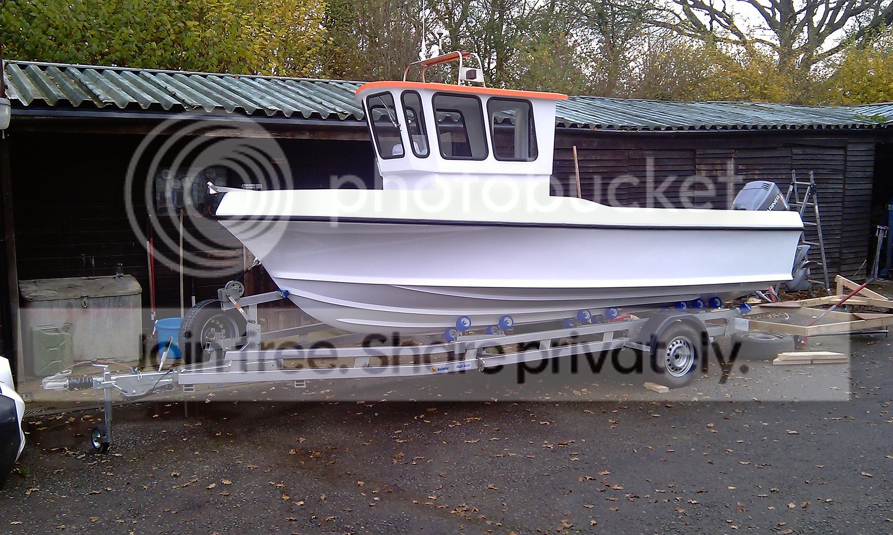

    couple of pics of the boat sat on the trailer ready for the off tomorrow morning.

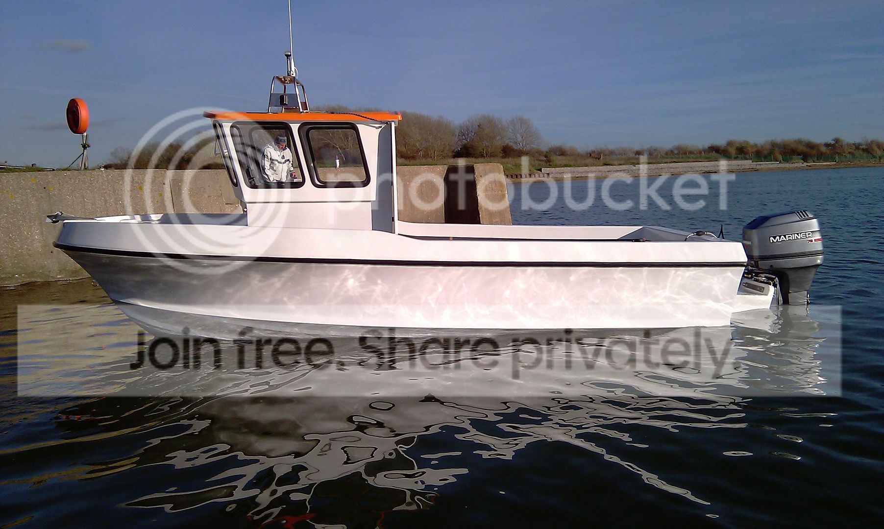

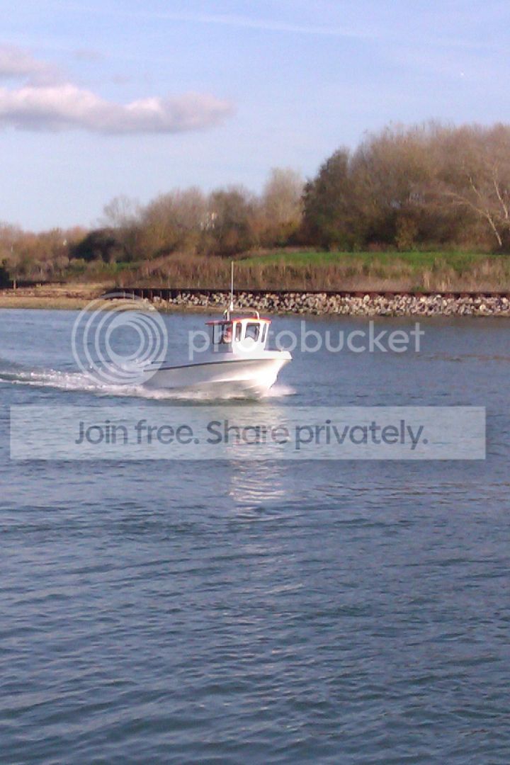

    well got the boat in the water today and it looked good sat in the water and thats pretty much all it did.
    i have 3 little bits to sort out and then it should be fine.
    firstly the engine would only rev to 4000 at which the boat was doing 22.6 knots. will have to try another prop with smaller pitch to get the revs up and i need to lift the engine up by a hole or 2.
    secondly the carbs need stripping and cleaning as when pushing the throttle forward it would cut out some times or splutter due to not getting the fuel through. im also going to change the fuel pump diaphragm as well.
    thirdly the bow of the boat sits a bit too high so im going to put some ballast up front to bring it down a bit.
    other than that it handled fine and when doing 20 knots you can turn the wheel and the boat turns nicely.
    performance wise it think the 75hp lump will be ideal. once i get the revs up to where they should be i reckon i'll see near on 30 knots. im down on revs by at least 1400 rpm.
    so fingers crossed next time out it will be all sorted.
    for got to add that my fishfinder works a treat with the transducer in the little box i made and at 22 knots it was showing the bottom fine.

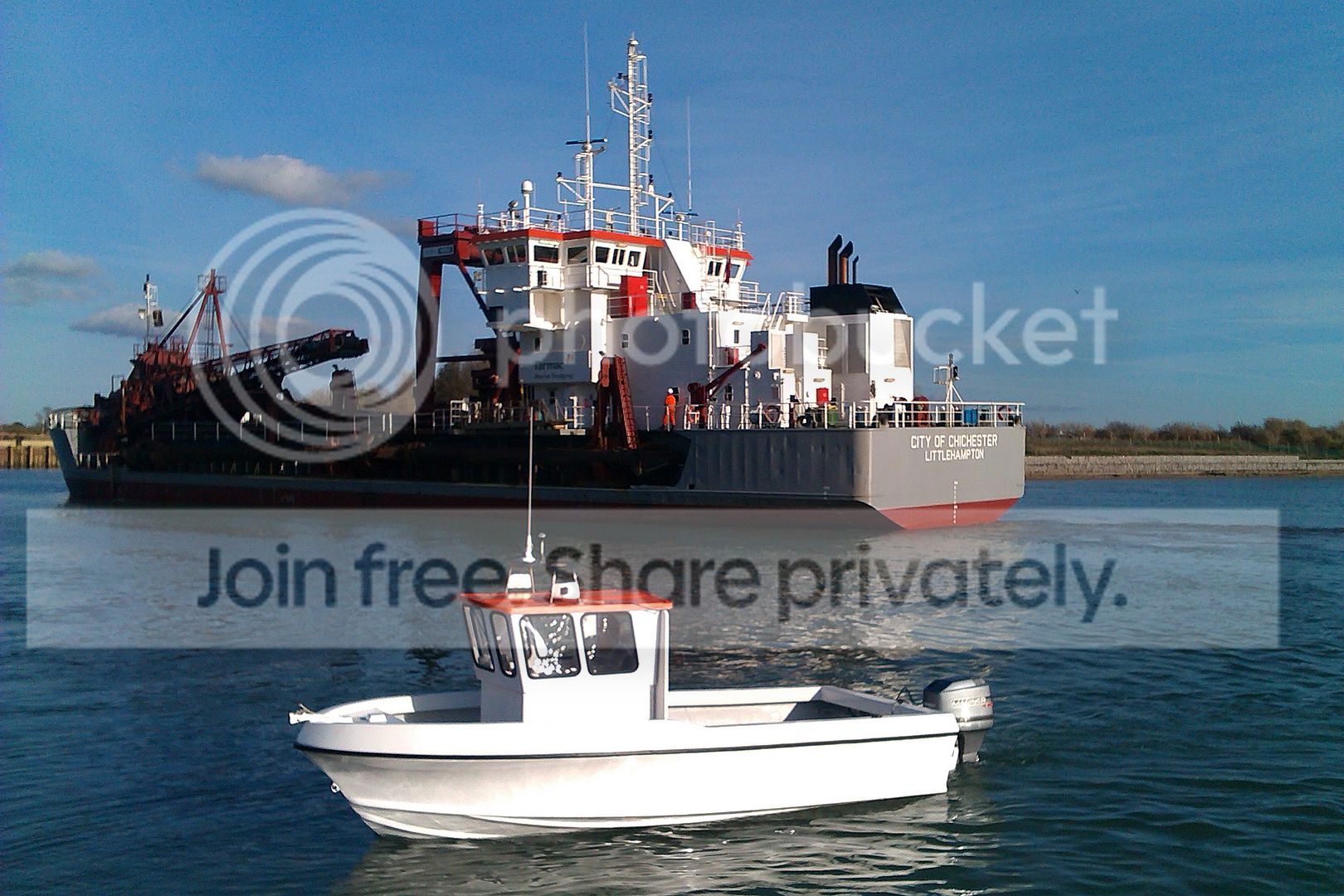

    another pic which i really like with the local dredging boat in the back ground.
