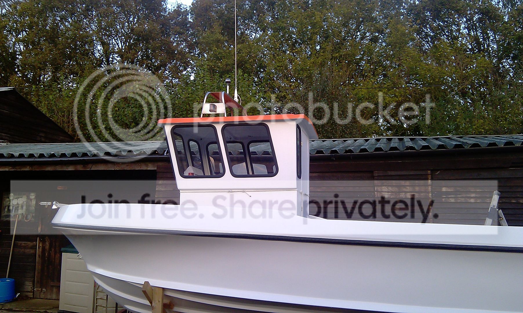

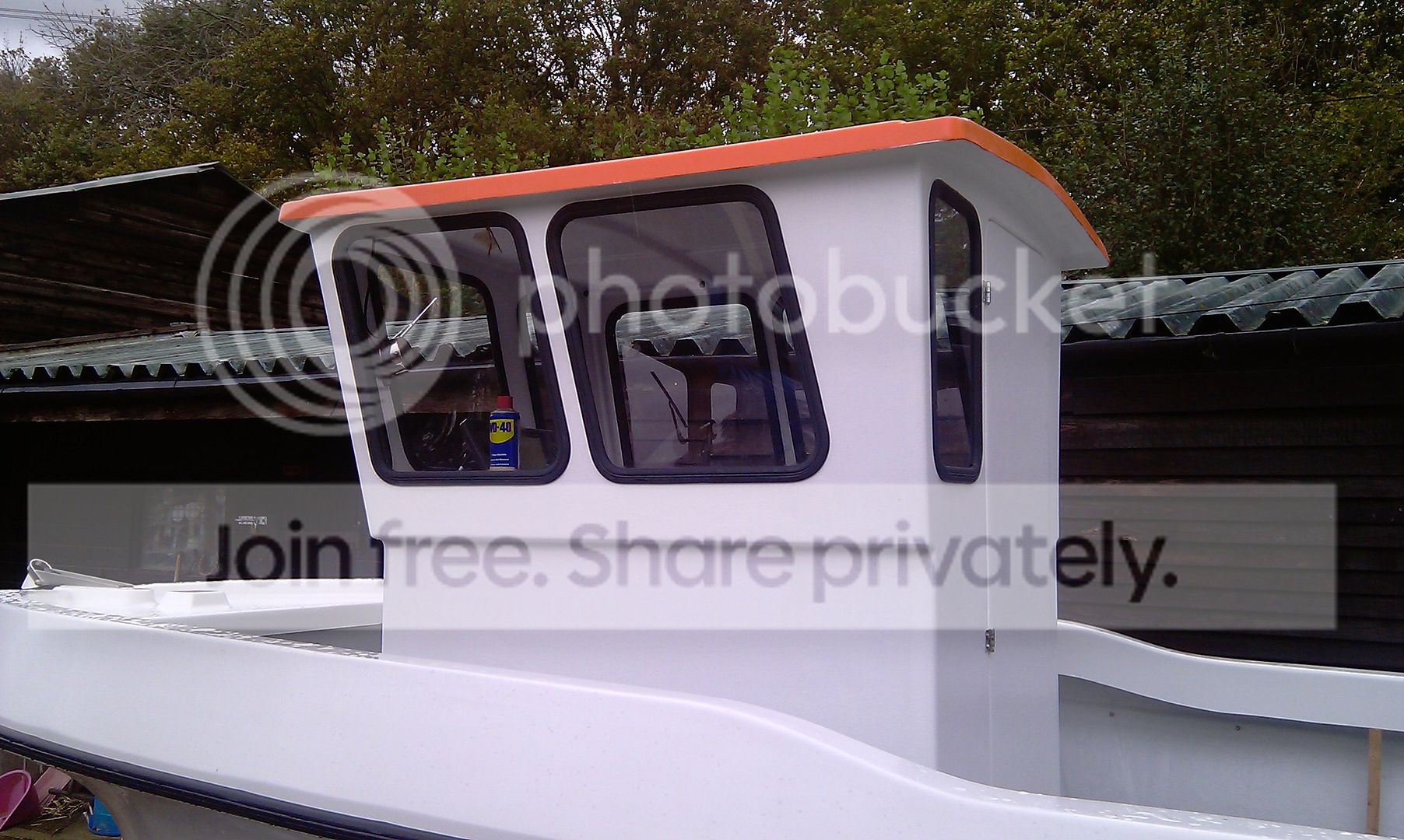

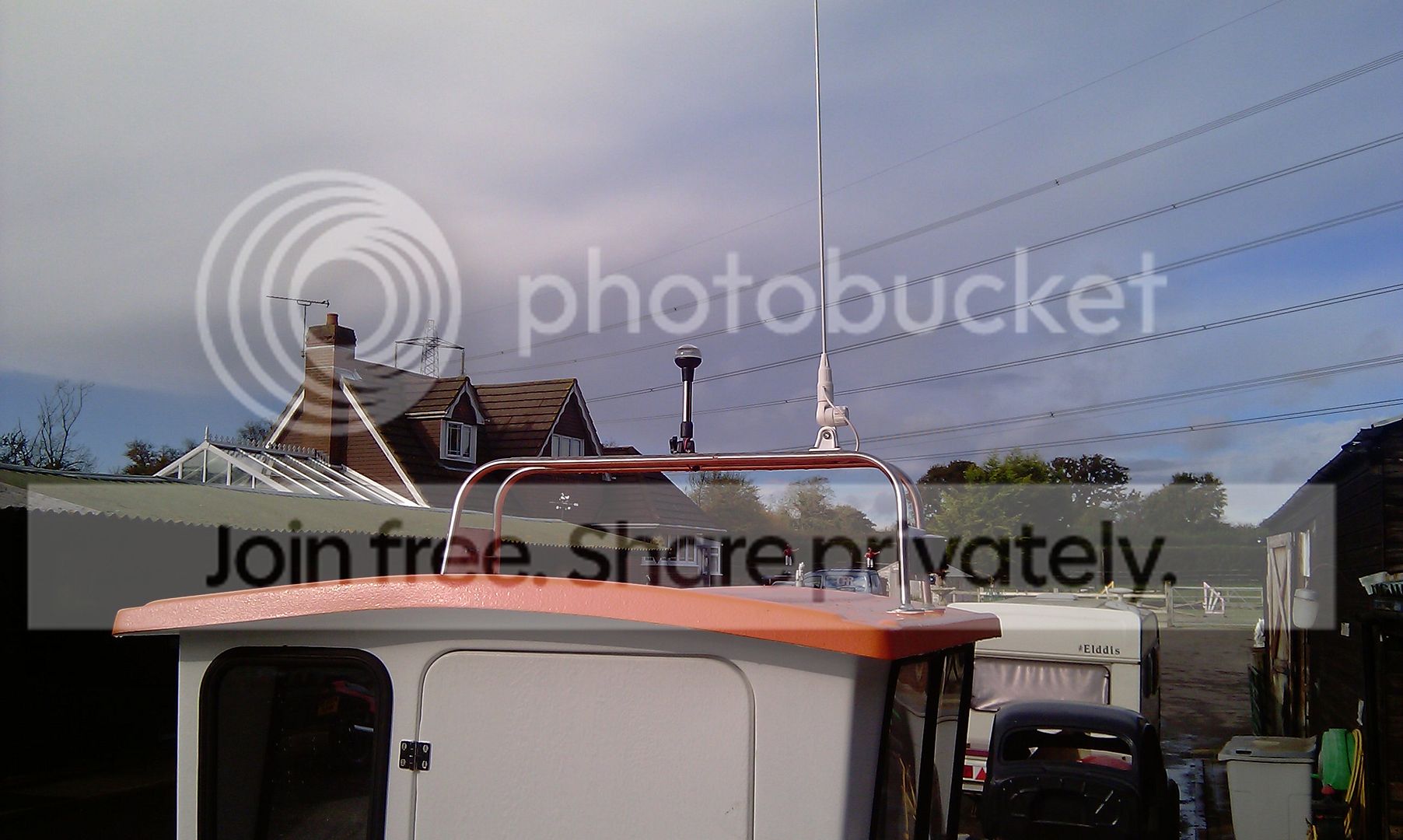

    got a bit done over the past week.

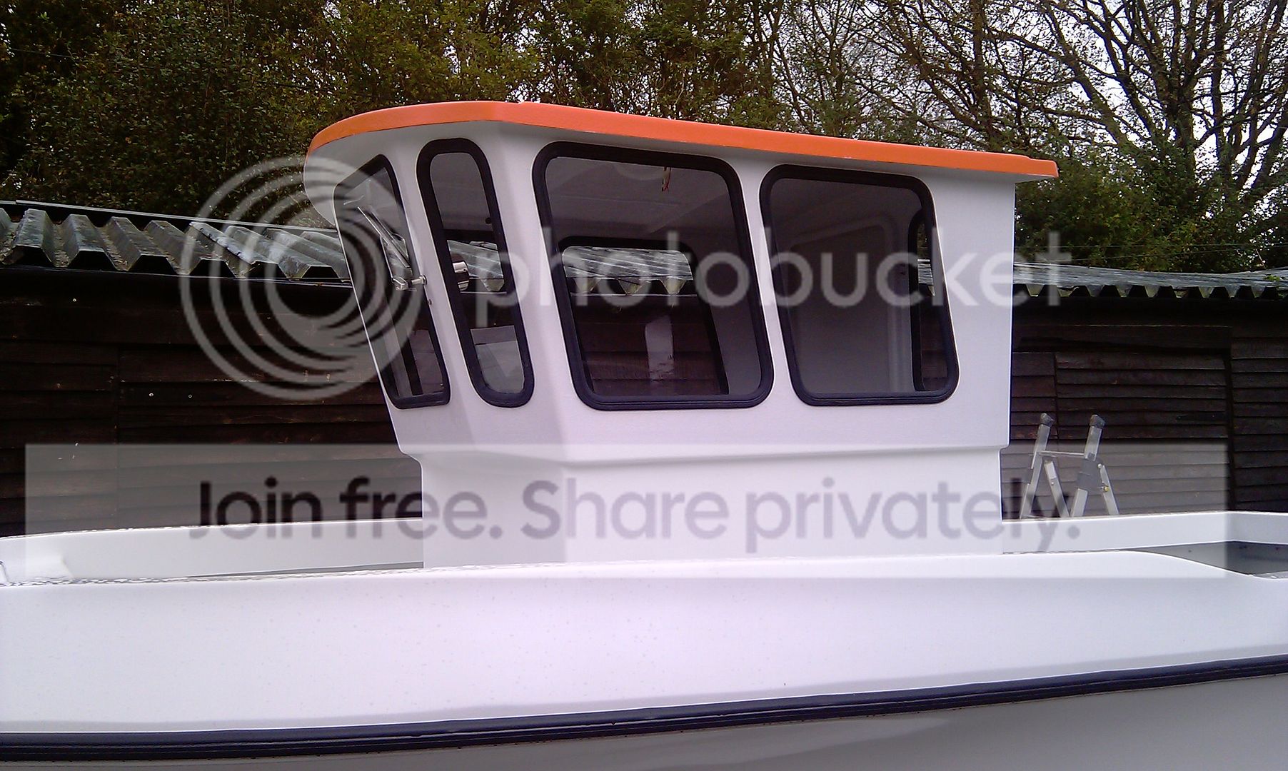

    windows are now in and radar arch mounted. windows are mounted on rubbers as that was the quickest way of sorting it out. i may change the main front windows at a later date for alloy framed windows.
    not a great deal has been done lately due to work slowing down and not much cash to buy the bits i need but next week will be a good week so a bit of progress will be made.

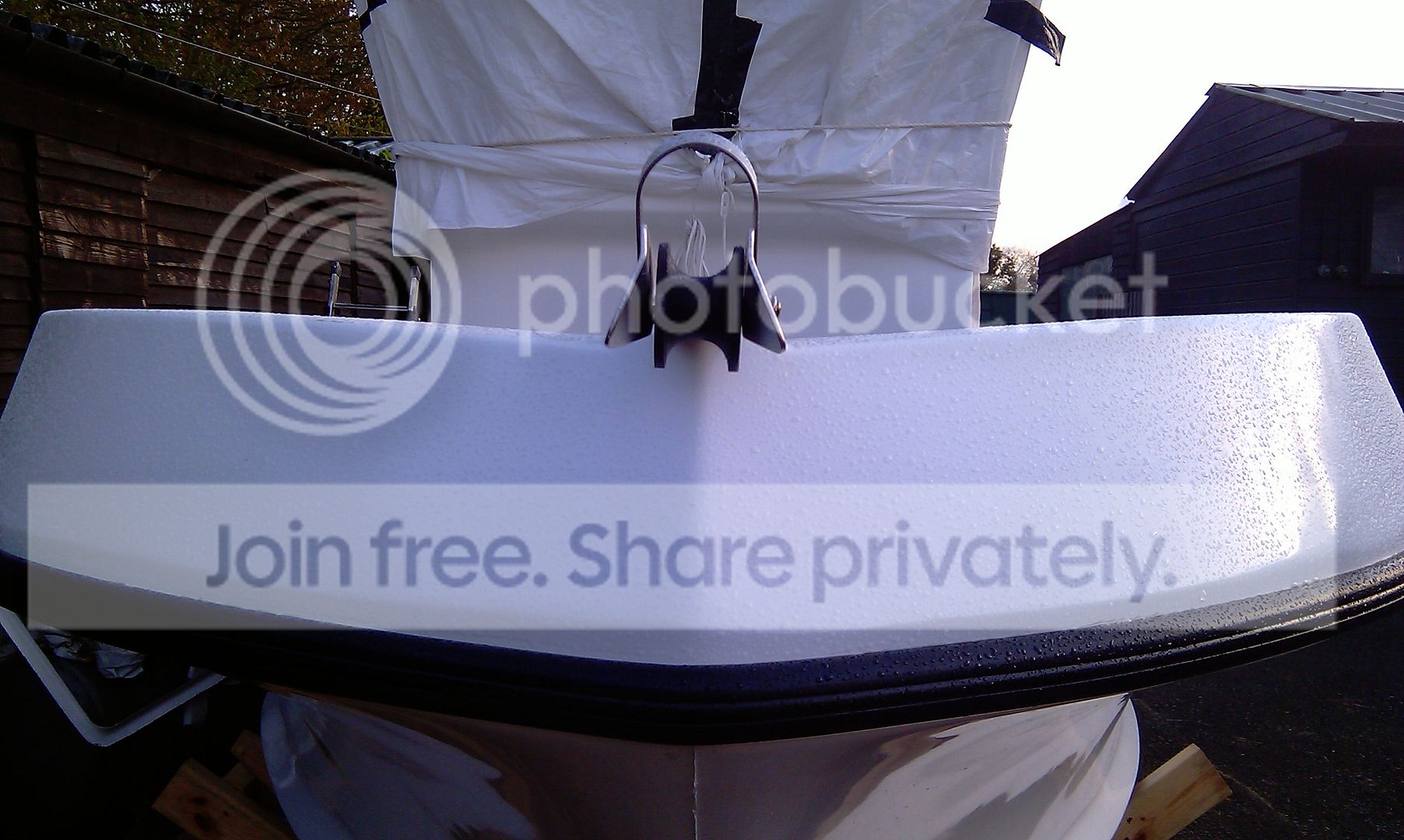

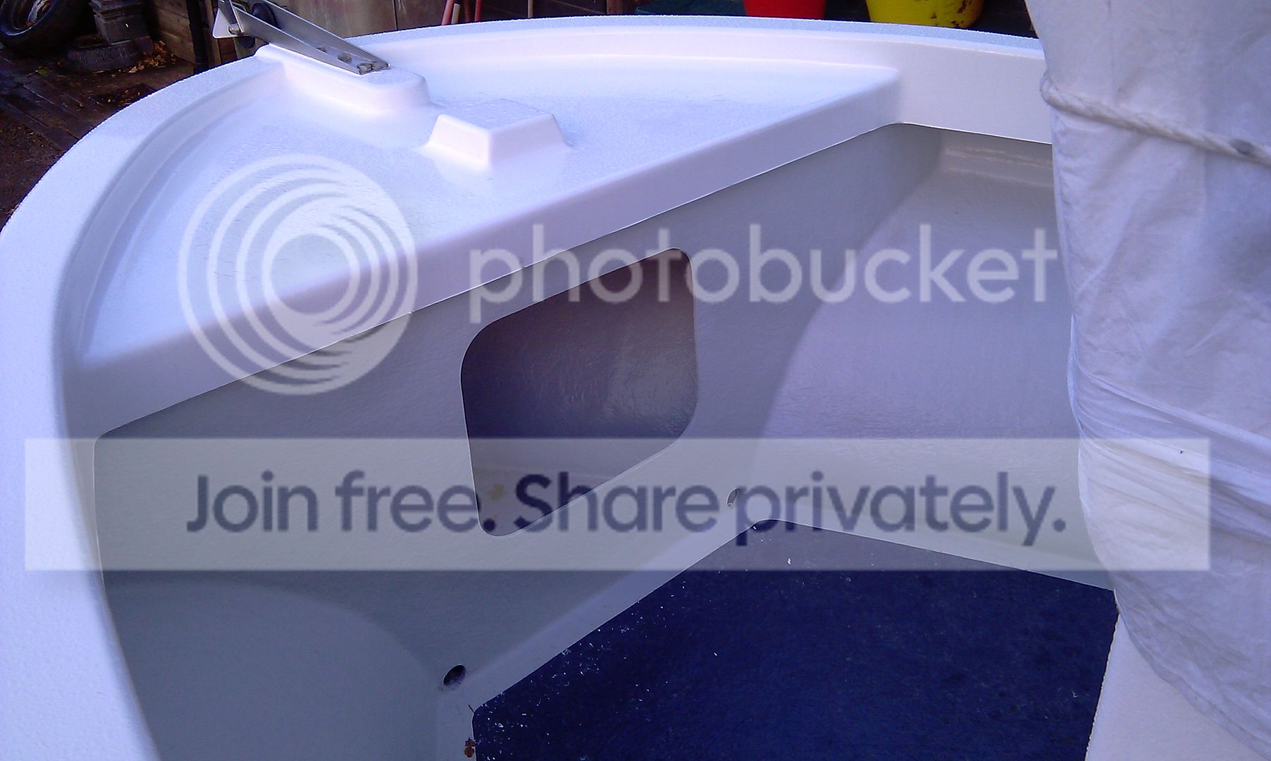

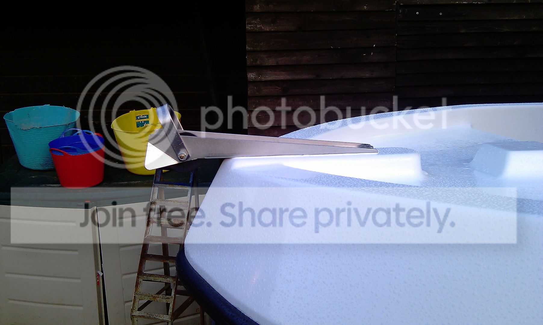

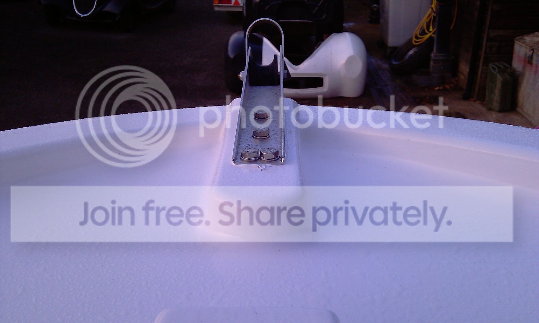

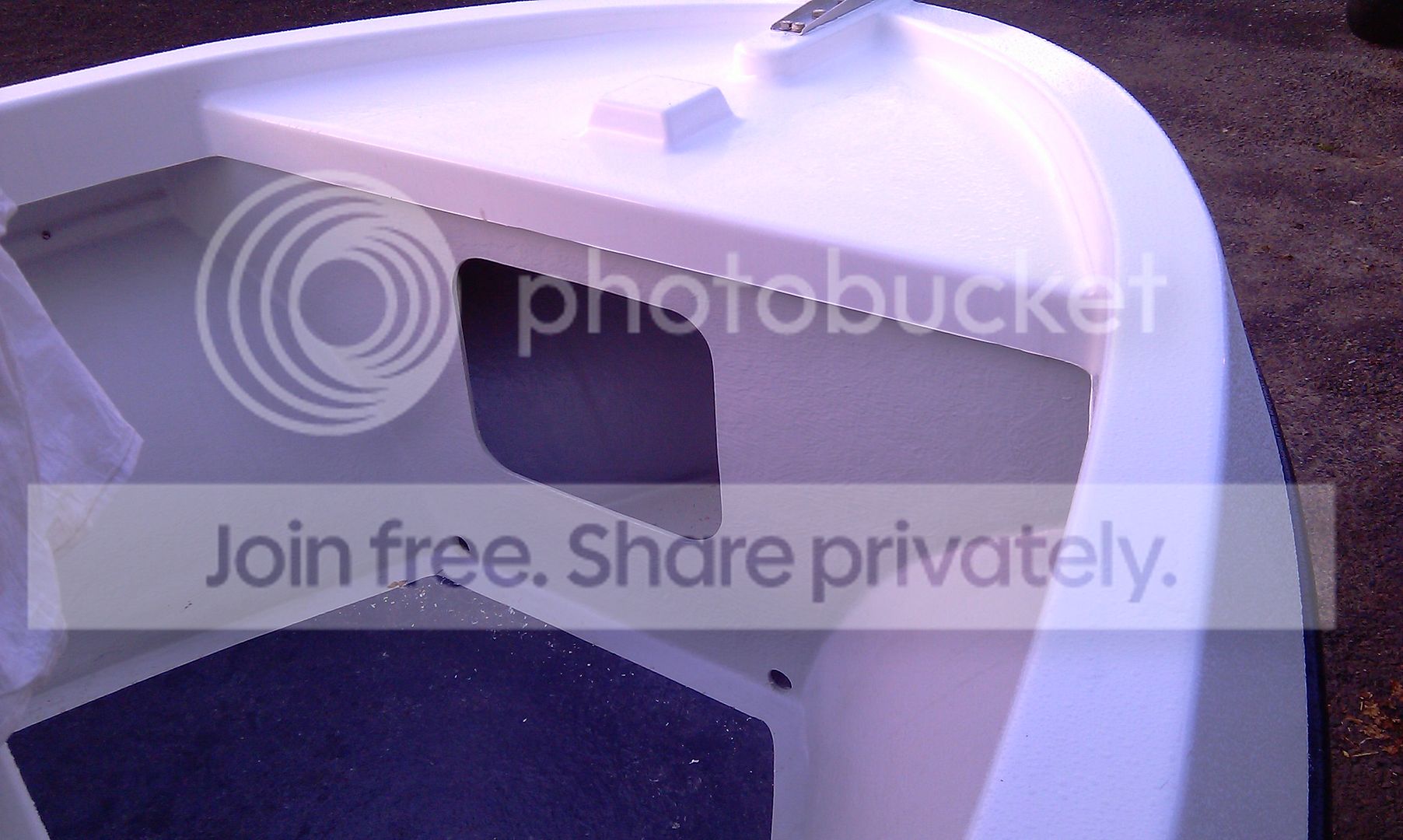

    also bow roller is bolted on and i've cut a hole out the anchor locker as i couldn't get a hatch the size i wanted so i decided to cut a hole out and i will fit a rubber trim to it at a later date to neaten it up.
  8. tunnels
    tunnels Previous Member
    Fantastic !! really look the part !! a chrome horn and search light on the cabin top and your there .
    I hope you are pleased with all you have done because it a credit to you and your helpers . Well done !!:D

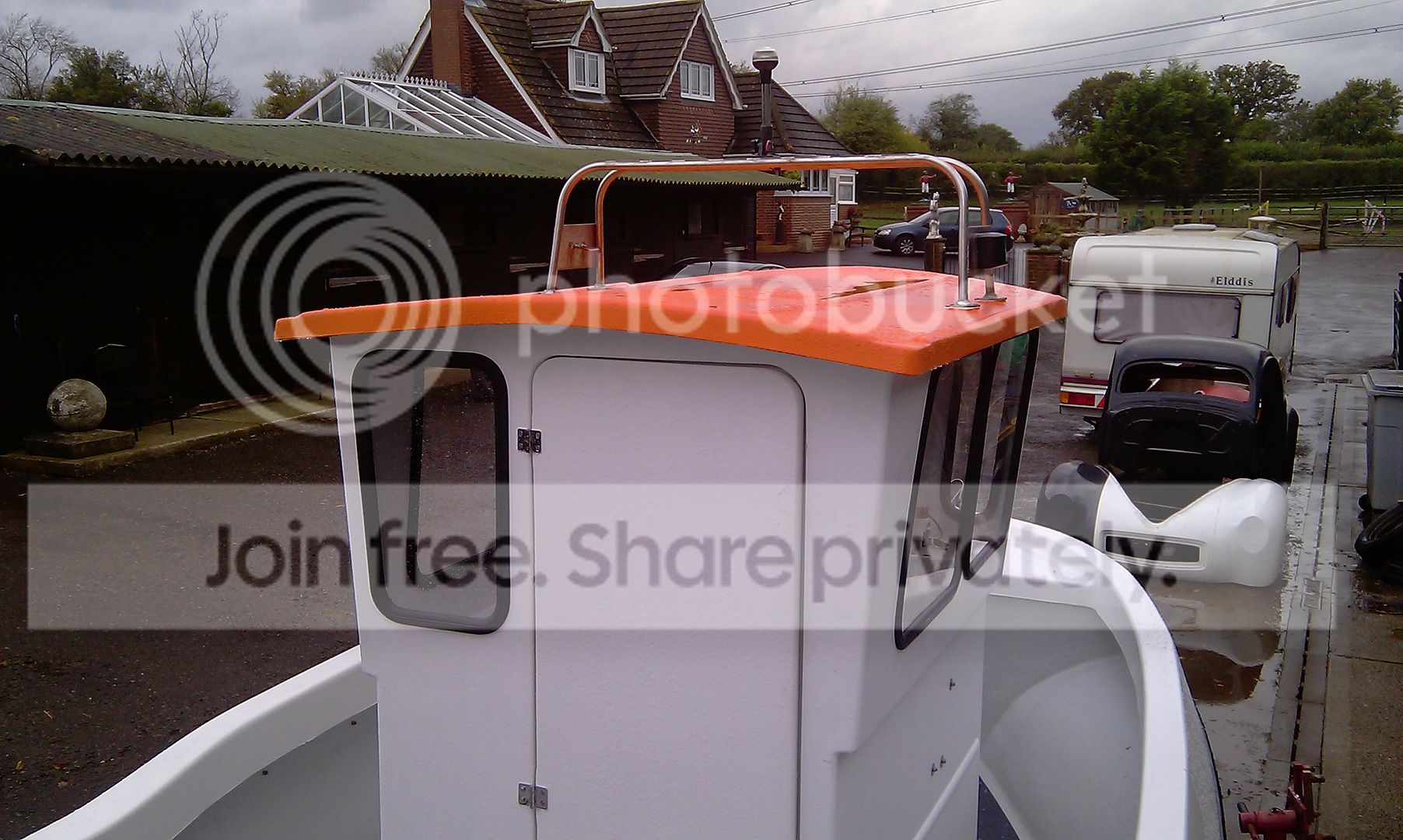

    vhf antenna is now mounted on the arch.
    going to fit a twin stainless horn set up on the arch as well.
    i've got a remote search light which has got a suction bottom to it so it can be mounted any where when needed so that will go on the roof , foredeck , any where really as the lead is long.
    im going to mount a rear deck light to the rear edge of the roof. i may fit a froward facing spot light if i think it needs it.

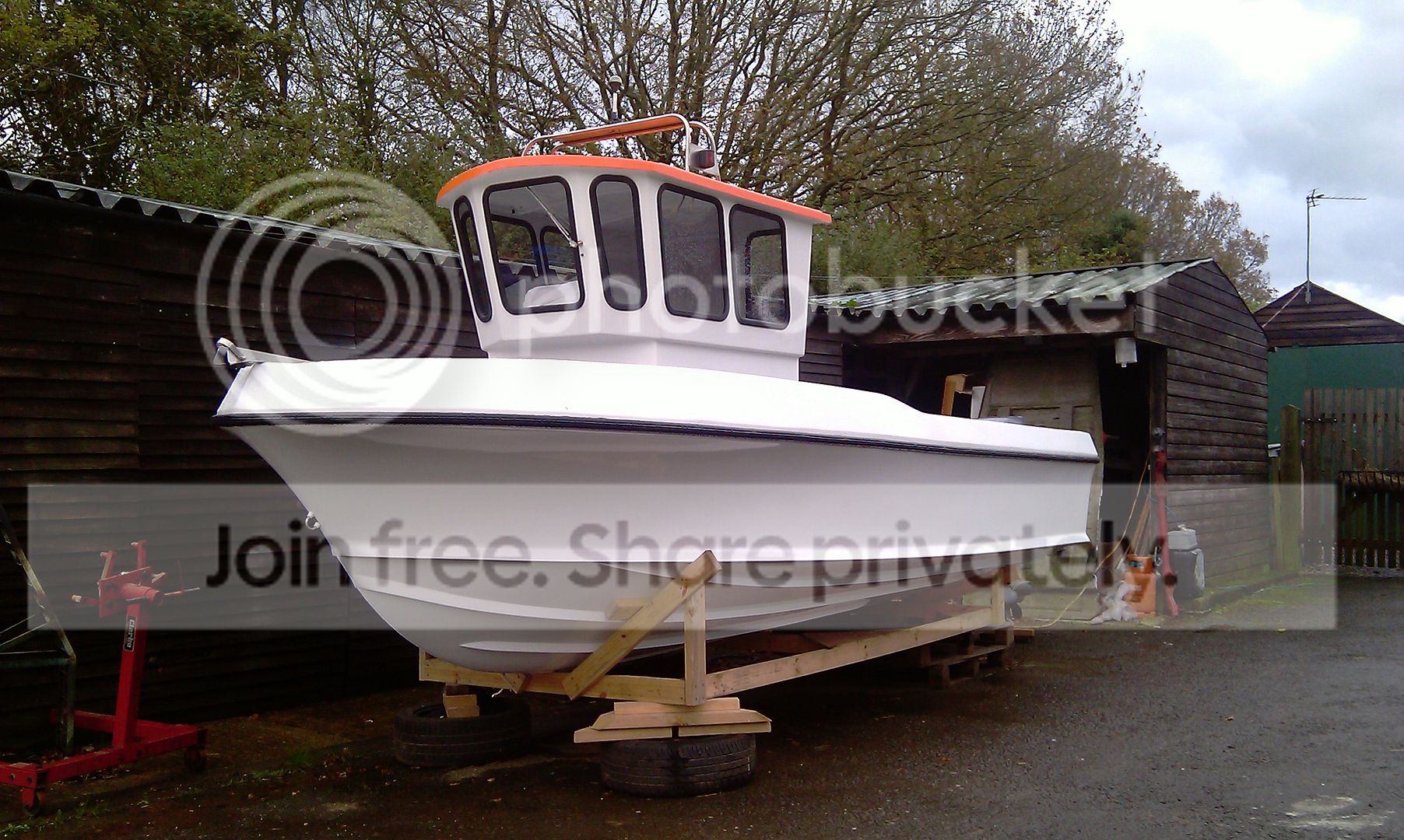

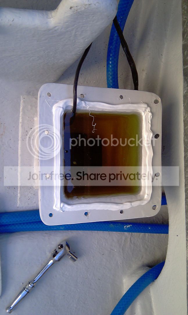

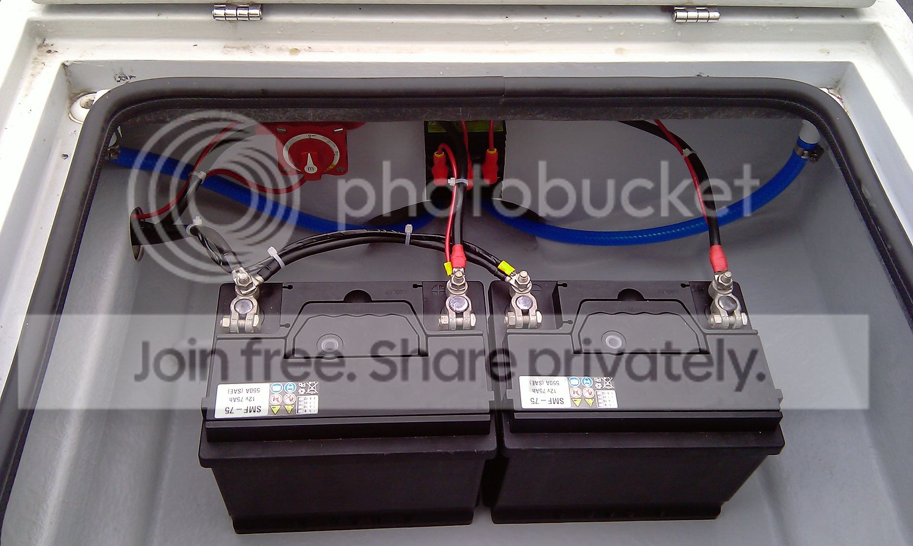

    well im at the point where i can now launch the boat.

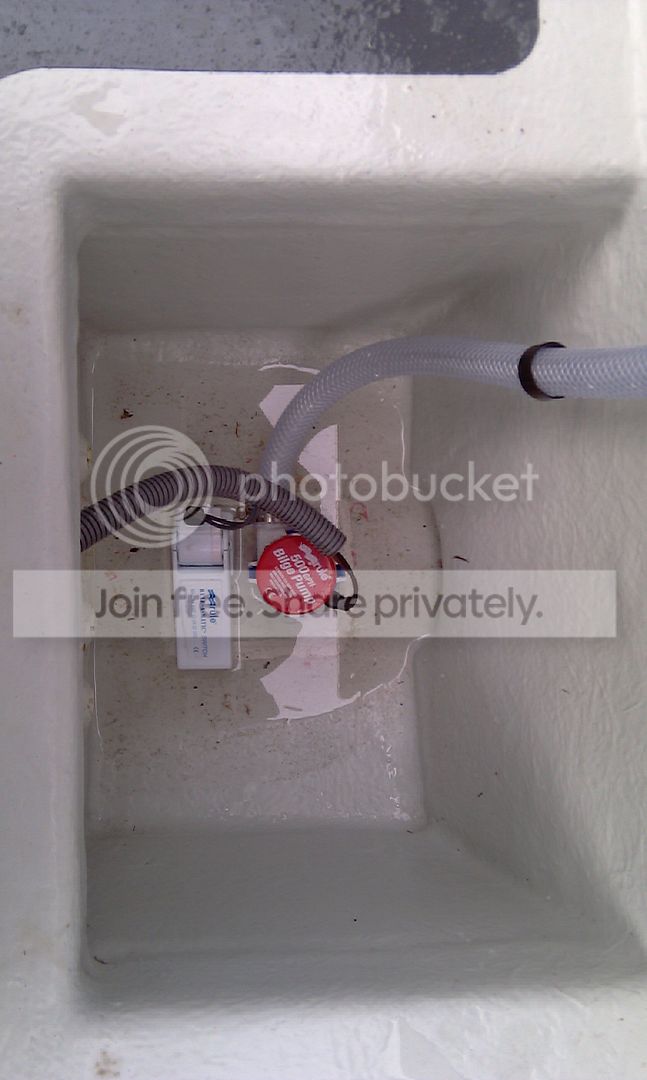

    batteries are in and all wired up with split charge and battery isolator switch.

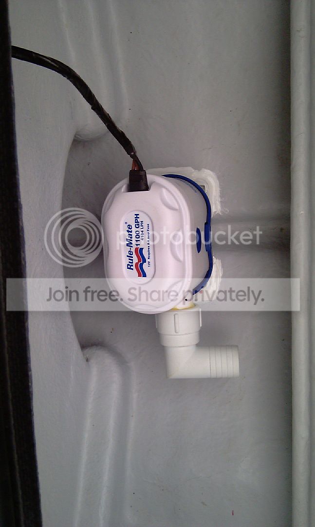

    bilge pumps wired and plumbed in , fuel tank is all plumbed in but i need to get a filter and water trap yet , transducer for fishfinder is mounted in the hull in its own small box which is filled with veggie oil and the lid sealed on.
    im hoping to trial the boat this sunday afternoon so will get plenty of action pics and maybe a video.
    there are still quite a few jobs to do yet like all the stainless bits and pieces , radar reflector , deck light , cabin light etc but they will have to wait until i have moe funds to buy all the bits.
