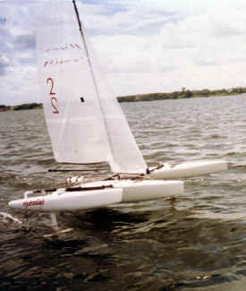

    Sorry Wayne but that is a silly comment. The Fire Arrow uses a foiling system never, ever used on a trimaran in the past-not in the whole history of the earth! And you and Gary knock model testing in a profoundly uninformed way: RC models have been used for decades to test foiling and foil concepts by people like Dr. Sam Bradfield, Hugh Welbourn, Paul Larsen, Yves Parlier, Greg Ketterman, Matt Burns(CBTF) and more.
    Attempting to ridicule my boat as a "pond toy" is just ignorant and woefully uninformed!

  10. Doug Lord
    Posts: 16,679
    Location: Cocoa, Florida
    Doug Lord Flight Ready
    See post #5. And this thread: http://www.boatdesign.net/forums/sailboats/quant-23-foiler-scow-53468-3.html

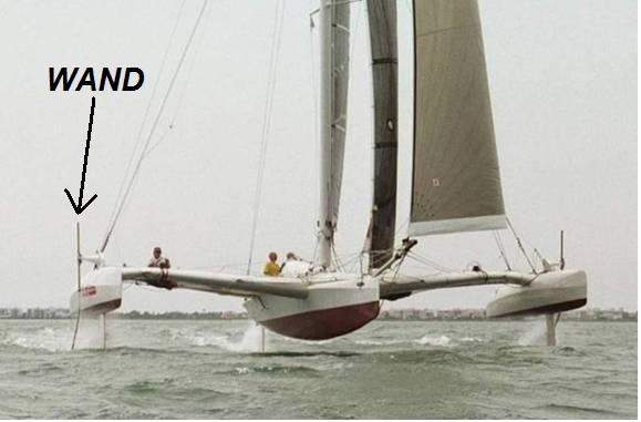

  12. Doug Lord
    Posts: 16,679
    Again, you pontificate on where an RC model comes in the design process with absolutely no idea how it really works. I worked with Dr. Bradfield one summer when he used an RC trimaran platform I designed and built to test the foil system of the 40' SKAT he was about to build. His testing was about 4 days a week on the water for three months-a major commitment of time and effort.(Which is exactly what I'd do in a heartbeat if I could!)
    RC models, with a comprehensive testing program, can completely vindicate(or not) a foil system, altitude control , configuration, foil area, rig placement and many other details. I was there and I know what went into his testing and my testing has been similarly comprehensive and is not complete yet. But we do know that the unique foil configuration works in light air at relatively low speed-a central goal of this project. We know the ama placement, foil placement, rig placement, platform dihedral, two stage ama all work as intended.We know the balance of the boat is nearly perfect.
    We know the foil positions, wand length, foil area, flap area, rudder foil area and AOI of all three(4) foils is correct for the conditions the boat was tested in.
    All of this stuff scales up very well with highly accurate results and makes this kind of testing a time saver and money saver in the long run. The results are not a part of a "generalized" theory-they are concrete results of specific testing that can lead to directly building the fullsized version based on what has been(and will be) learned. It allows the fullsize boat to be way ahead of the development game compared to a boat where model testing has not been done.
    I want to see any one of Gary's boats foil because he has made it part of his lifes work to attempt to ridicule my test model(and model testing in general). He has claimed the boats are foilers-I'd just like to see a still picture of ONE boat flying above the water on foils. I think Gary's designs are absolutely gorgeous-just beautiful. And I bet they would look great flying!
    Pictures: L=Flyer3 platform designed and built by me modified for foils utilizing the same system that eventually was used on Skat by Dr. Sam and his team, R= the 40' SKAT foiler with foils, foil configuration and altitude control developed during model testing:

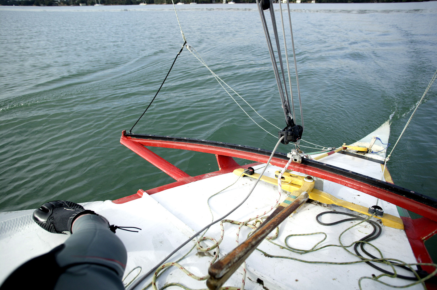

  13. Gary Baigent
    Joined: Jul 2005
    Posts: 3,019
    Location: auckland nz
    Gary Baigent Senior Member
    This is veering way off from the original thread content but ... It is true I haven't posted any high speed images of my boats foiling/flying ... because I sail my boats solo (mostly) - but they do sail very fast in moderate and fresh winds - and that is when I'm too busy steering/trimming to dig out camera. Not that I give a rat's flatulence about what sedentary boffins think about my boats.
    However here is a shot on Sid in 3 to 4 knots wind speed (this is the only time I can think of taking photographs); check out the foil and main hull wakes and figure the speed - then imagine the performance in 10-12knots wind. I have to reef on Sid above that figure. And then the boat becomes a brute in terms of speed with its very rapid steering.
    Figure it out Doug; an extremely light platform (230kgs) and high aspect ratio rig - and take it from me, the boat is very, very fast.
