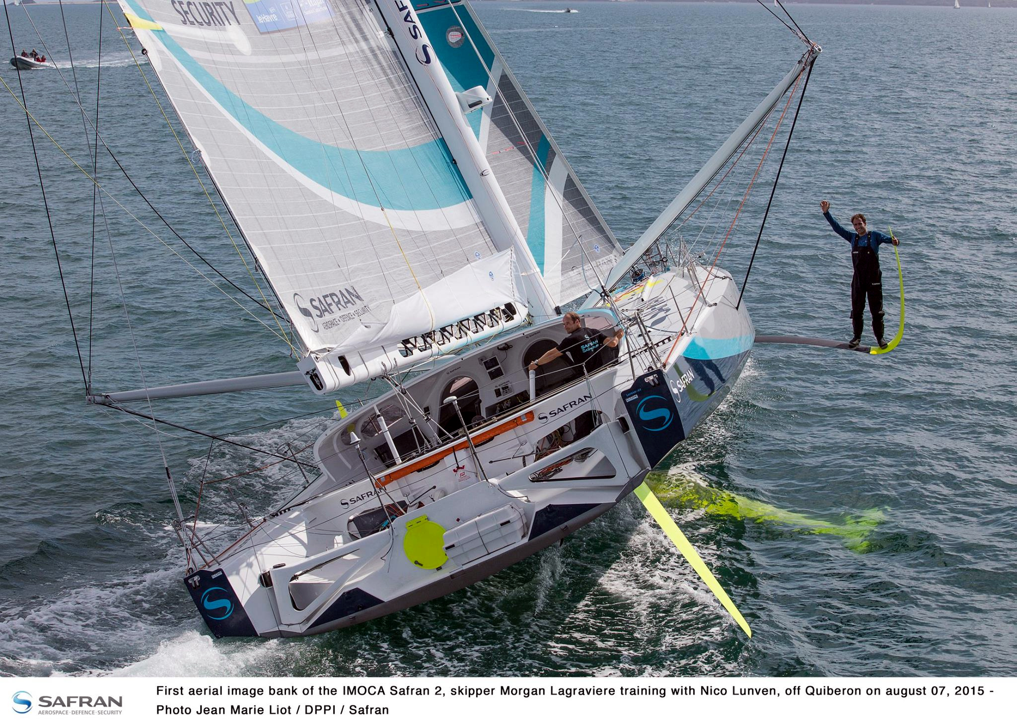

    How very strange, deluded and offcourse are the new IMOCAs with new? outfacing foils; someone needs to rush over and tell the poor incompetents that their new fangled foil system is completely, totally and theoretically wrong.
    I mean look at their pathetic performance increase; only a miserable few knots faster than with conventional setup.
    But strangely, so much faster that the hull structures can't handle the new loads. Some all-knowing believer needs to get over there fast?

    OUTWARD POINTING FOIL*. Gary, the 60 foils aren't pointing outwards!
    And they work great on a reach but are a disaster upwind(mainly because of rule limitations).
    And all outward pointing foils aren't bad-like Welbourns Q23 foils-they work great even with the disadvantages pointed out by Ketterman-mainly because the vertical portion is mostly out of the water. And DSS works great because the foil DOESN'T have high and low pressure on the same side. And my Test Model foils work great because they don't have high and low pressure on the same side.
    *the words I used in the post you quoted.
    Gary, the 60 foils point up(!) :

    Maybe my eyes are deceiving me ... but these foils appear (to my old eyes) to be pointing outwards? Or maybe the crew can walk on air above the windward foil? And the working leeward foil has the upper section near vertical and the uptip end section closer to horizontal. And this is more emphasized with the boats powered up in high wind and seaway; just look at the videos.

    Gary, you're so right-it does point out! Right before it points UP!! Geez.......

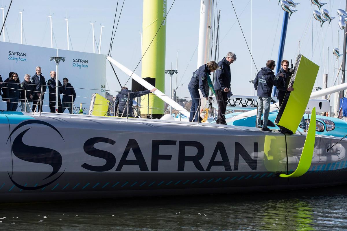

    Your images are of a stationary yacht with withdrawn foil; the foil is not being utilized, boat is parked (so what is the point of posting this nothing image?) - the other is an artist's pretty illustration of a 60 in supposedly very light airs - when I doubt the leeward lifting foil would be used anyway.
    This is a totally different situation with an IMOCA 60 powered up in heav air and seas and heeling way over, carrying more sail than earlier designs (because of the powerful foil lifting forces) and the "uptip" section would be closer towards horizontal than your celebrated withdrawn foil, parked boat, UptiP position.
