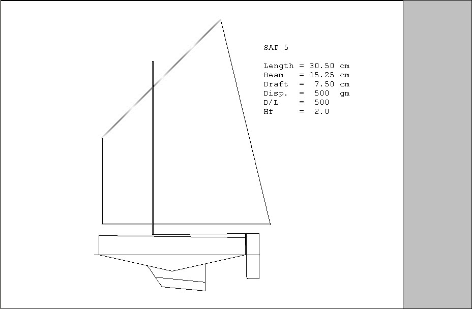

    Next I moved on to improve SAP 4,
    (See second two attachments)
    With her draggy raked transom doubling as part of her bottom, her Keel had to be moved well forward to allow her to be able to point up wind.
    The solution I chose was to cap it with a real transom. This did Three things:
    1.) it allowed a longer WL,
    2.) it allowed the deepest part of the hull to be moved forward quite a bit, and
    3.) it allowed much higher freeboard at the stern.
    All of these improvements probably make for far less drag aft, even thought there is now a nasty stern corner to dig in immediately, as soon as Poor SAP 5 starts to heel.
    Even so, with the nastiest bend moved much further forward, I believe it is now safe to move the keel further aft. The still extremely dirty hydrodynamics of this hull might strange canceling out effect. As the lee stern corner digs in, its added buoyancy pushes the bow down, making a bigger bow wave, which will tend to make the boat point up wind. At the same time, this very draggy lee stern corner will be digging in even deeper, tending to point the boat the opposite way. The two effects could end up canceling each other out--with a huge cost in over all drag, of course.
