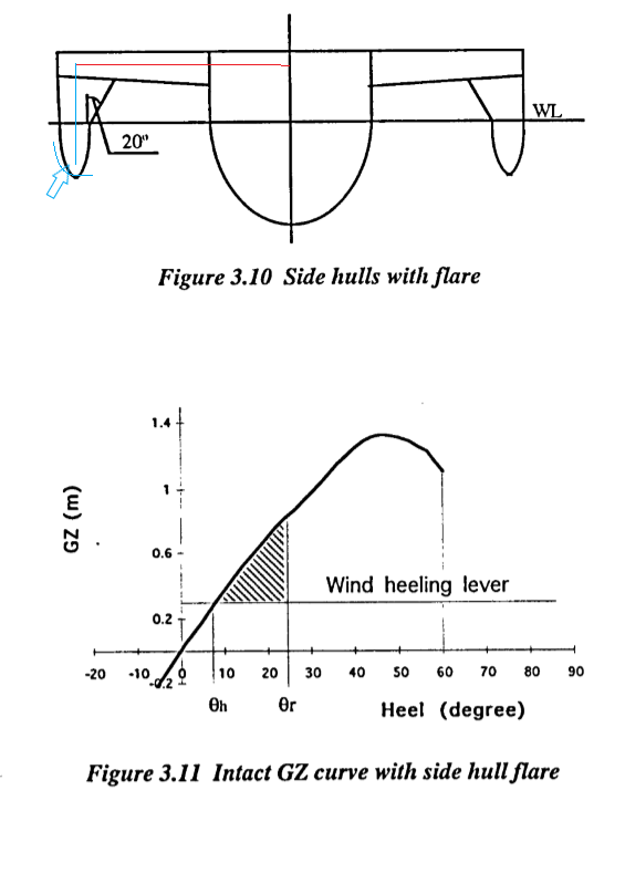

    The connecting beam/crossbeam/aka initial buoyancy may not be enough as it create a notch in the righting arm graph. The practice is to gradually increase the buoyancy of the ama/outer/side hull. The form suggest a wedge as shown in the picture. It serves two purpose. Smooth out the buoyancy curve and increase moment of inertia of the connecting beam. As the boat heels and the ama submerges, the moment arm changes from the centerline of the main hull to the center of buoyancy of the outer hull to the connecting point. That is the distance from the outer hull center of buoyancy to the outermost point of the connecting beam.

    It might even make sense to add a similar 'wedge' to the outside of the amas, as this is the side that is pressed most deeply in the water due to the heeling effect.
    My feeling is that a narrow V-shaped lower ama hull, broading to a much wider, shallower 'V' would be ideal.
    Alternately, an upward curved aka, the outer end of which was higher than the inner end, would enable an ama of even larger volume - like 200% or more.
    I'd be interested to see how such an arrangement affected the righting arm. And I'd also be interested to learn how increasing the floatation of the amas affects design strength/thickness/size of rigging and spars.
    For example, if I were to increase the beam by 20% and increase the size of the amas by 30%, by what percentage might I need to increase the size of the "originally designed" rigging and spars...??

    Buzzman , yes the requirements for a cruising trimaran call for a higher percentage of design criteria to be dedicated to safety and comfort, 200% plus floats may impinge on comfort,,? I don't know. Speed has a safety factor of course, part of the reason trimarans can be so good . Flat sections in a shallow V while still fighting leeway may be less prone to sharp sideways knocks from messy wave direction/ current forces, than a sharp V you'd think. The floats on sizzor are interesting, they look just a little like old wind surfers..ha. There is bound to be a fairly straight forward formula for required mast strength for those factors you mention. Those factors you are increasing a close to what I am doing/ plan to do, but more like 15% for the beam. I'll be going with if it starts bending back off, then add extra hounds from the spreaders, then start looking for a stronger mast. Rxcomposite possibly has a definitive answer.
