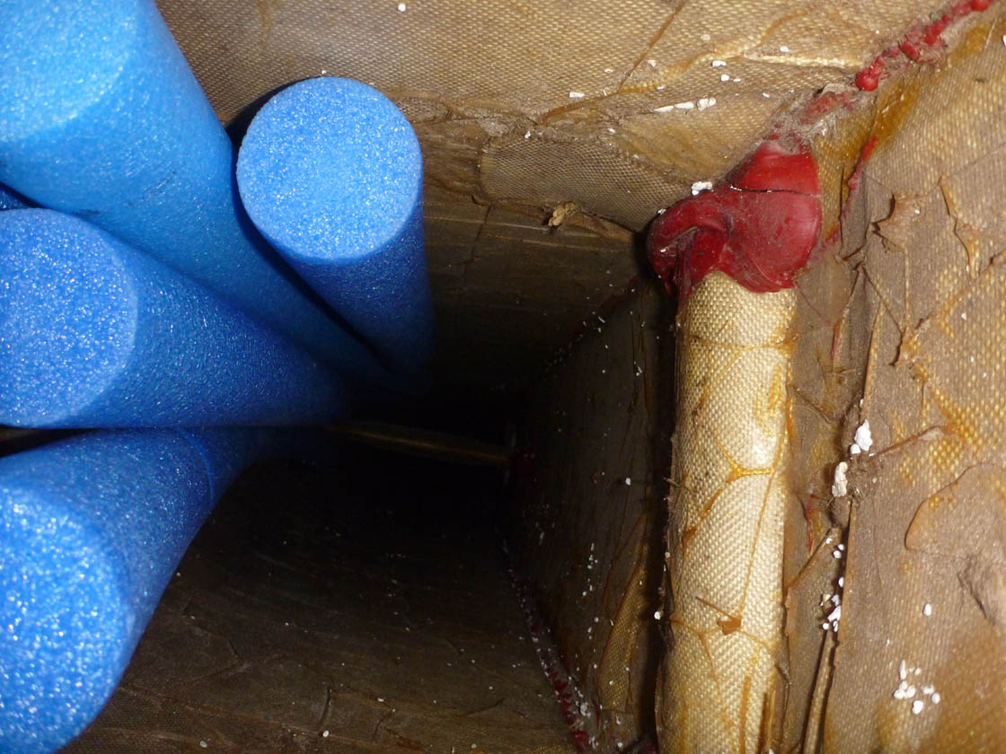

  10. BobBill

    I apologize, I forgot the audience comes from diverse regions and also did not want to step on anyone's toes who advised perfectly functional bags, balls, milk jugs, etc.
    "Pool Noodles" are varied forms of light foam lengths, for use in floating around swimming. Closed cell foam, easily cut, bent and so on. Some are 4 inches in diameter and solid, some have a lengthwise hole. I used the large diameter solid version, color was whatever was low cost.
    Sits in dark, relatively dry area in hull, as did the old material.
    I replace the typical hard, open cell foam with the softer noodles (first two pics - white stuff) as cheap, nearly indestructible, long lasting, quiet flotation...if I have pics of the old white stuff, will show.
    In the one pic, bits of the deteriorating styro foam used by the maker can be seen. Was two interlocking blocks of styrofoam inside plastic bag, which had been punctured and the foam had become waterlogged, stinky, etc.
    I bought the noodles through Amazon, on sale, for little cost.
    Trouble was, each was sent individually from same supplier...so I had lots of cardboard cutting and recycling, 20 boxes 4 feet long and a foot square, when they could have sent them smushed in two or three boxes. These were the 5-foot long, solid, 4-inch diameter variety as you see.
