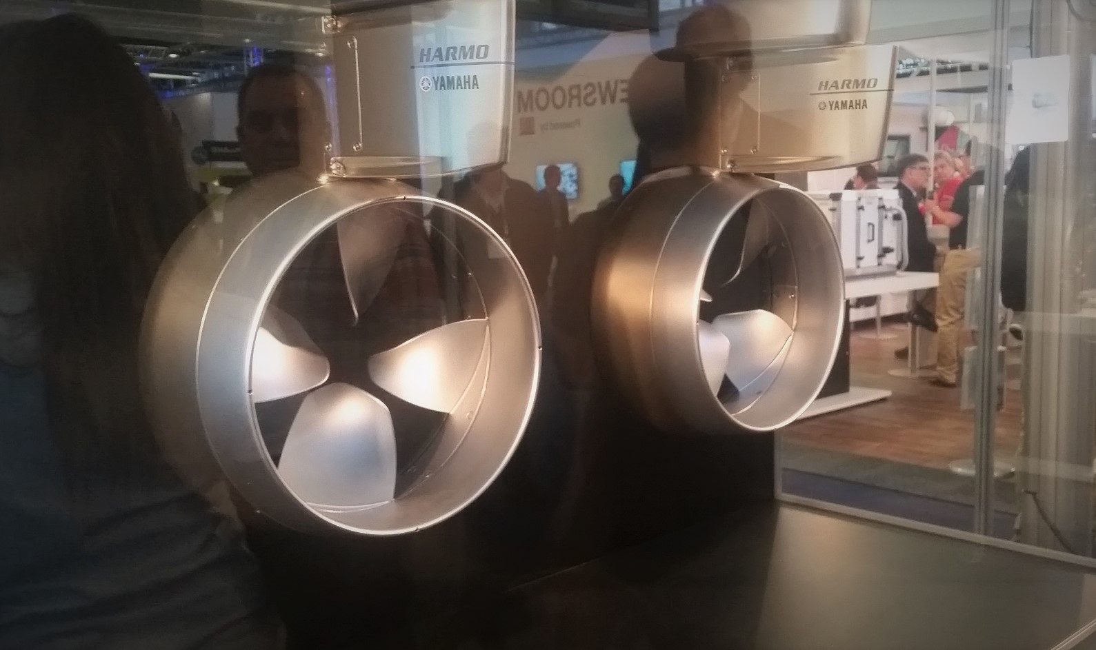

    Perhaps we are talking about the same vessel that I mentioned back in posting number #51 on this subject thread.
    Turns out I was incorrect suggesting that these were propulsion units. It appears as though they were just bow and stern 'thrusters'

    Hi Brian
    Yes
    On other media it did look like it had rim drive main propulsion?
    I have since seen a little about local ferries in scandanavia with rim drives set up as azi main propulsion
