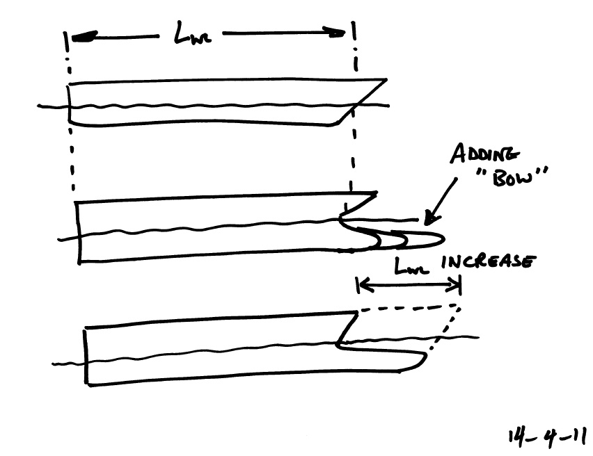

    That’s correct. Thus the myth, the hull pierces the wave. Well, if you have a hull that is just 500mm wide, and say 5.0m long on a boat that is say 50m long, with the boat travelling at say 40knots or so, when the “bit that sticks out” encounters a wave, what happens…nothing!...there is insufficient buoyancy in the “bit that sticks out” compared to the whole hull. Thus it goes into the wave until the buoyancy of the main hull(s) pick up the wave profile.
    The centre hull as you point out, has a huge amount of reserve buoyancy. This came about when the first series of wave piecing hulls by Incat, one was called Tassy Devil”.??...can’t recall correctly i could be wrong, but around late 80s, suffered a major deck dive in the Sydney harbour; one person died. The design then was just 2 slender hulls alone with a raft structure some height above. The reserve buoyancy only occurred when the raft structure hit the wave as the vessel was increasing in trim and speed going into the on-coming wave. The slender hulls just kept going "into" the wave and at a certain point the hull was so far "into" the wave it dug-in, so to speak. Not lifting it clear of the wave, as it had no buoyancy. Thus the central bow was born.
    The only benefit of such hulls is shown below:
    The waterline length is increased. Which, increases the L/D ratio thus lowering the resistance, and an increase in Lwl, reduces the vertical accelerations. That’s it, no magic.
    As to the ride quality. In the UK they have been termed the Vomit Comet. Make your own conclusion :p

    Thanks. Can you elaborate on the "vomit comet" result. What factors are leading to the poor ride?
    Is it the lack of reserve buoyancy in the bow extensions? If that is true then the bottom dashed line hull in your sketch should ride better and have all the benefits of a wave piercing design.

    There is more to it than just the shape of the bows, in terms of seakeeping and motions. Especially with multihulls. But having a hull shape, dashed in the image, would be no different, in the resistance/vert. accelerations, as one without, but with a “bit sticking out”; all other things being equal.
