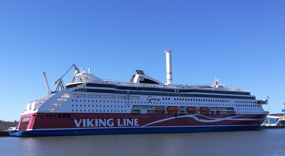

  11. 1J1
    Joined: Sep 2012
    Posts: 111
    Likes: 15, Points: 18, Legacy Rep: 10
    Location: .
    1J1 Senior Member
    Looking carefully at those pics, I see the rotors can travel along the length of the cargo deck, allowing to stow them in one single place so there's less obstruction during cargo operations. Very clever!

    Joined: Sep 2012
    Posts: 111
    Location: .
    1J1 Senior Member
    Found a closer look at the rotors...
    rwatson likes this.
  14. rwatson
    Joined: Aug 2007
    Posts: 5,873
    Likes: 311, Points: 83, Legacy Rep: 1749
    Location: Tasmania,Australia
    rwatson Senior Member
    Great shot there.
    It looks like they were retro-fitted of course, and they are offset from the loading bays.
    A great detail.
